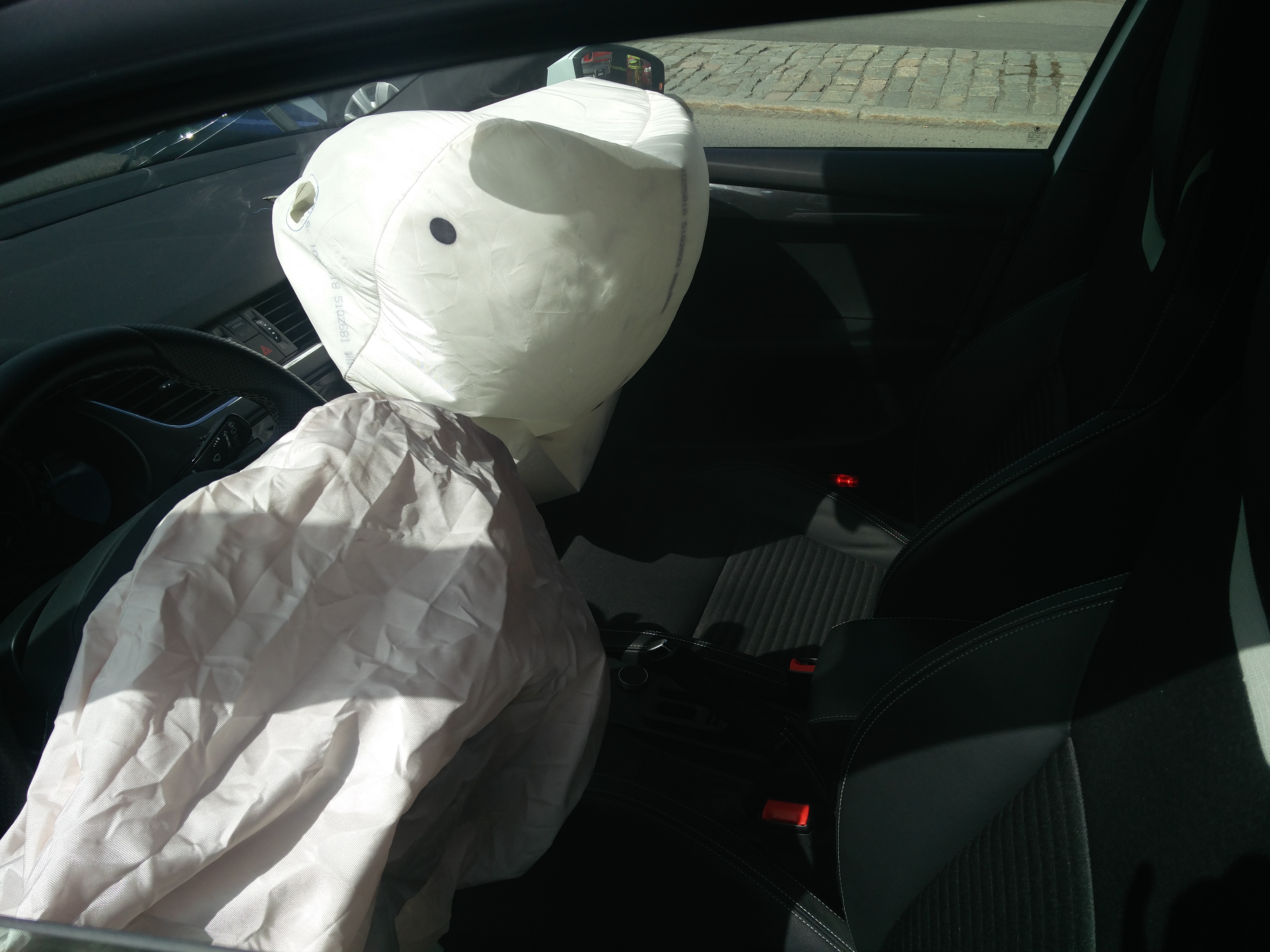

My latest mod - airbags visible
Distracted, did not notice the traffic in front of me had stopped.
Smashed at city speeds into the car in front of me without even braking, but... 3 airbags went off (even though I was alone in car...) - steering wheel, driver legs and passenger.
Nothing seemed to bend - all gaps looked fine, car could drive fine, bumper is obviously gone...
Anyone knows about Finland rules if they repair? I have full coverage...
Cop said that when airbags go off, car is a goner, but this is a car still under warranty, not even 2 years old, with only 60tkm.
Ah, windshield cracked when passenger airbag went off, but that is the least of worries.
I am bummed if they want to kill the car, cause it was a relatively minor shunt and bumper seems to have taken most of the hit.

Adding to it, does anyone know the rough cost of such a repair?
I am guessing:
- new dash
- 3 airbags that went off (guess that includes new steering wheel)
- new seatbelt and/or tensioner
- new windshield
- new front bumper
- new collision sensors for front
The steering wheel airbag is separate to the steering wheel so can be changed on its own, it will probably need a new airbag controller as well (and the new one re-coding)
many cars are written off with minimal damage once the airbags go off unfortunately.
Don't I spy the front radar / collision detection "hole" in the lower radiator grill?
I'm not in Finland but here in Estonia we have copied a lot of regulations from you and Sweden so I'm guessing the verdict would be similar to what would happen here. I don't think the car is going to be written off with this kind of damage (if there are no structural damages to the body behind the bumper that are not visible from your images). Airbags rely on "better safe than sorry" logic and open quite easily if your deceleration was higher than the threshold programmed in the controller. The cost of repairs should be a lot less than the pre-crash value of your car.

You'll need new seatbelts too as no doubt the pre-tensioners have activated?
Does front assist not work over a certain speed, why didn't it work properly?
City Braking part of FA only works up to 19mph/30kph.
Above this speed audio/visual warning in Maxidot and 100% braking force applied as soon as you touch the brake pedal; the theory is if you react too late, you scrub as much speed as possible, thus reducing impact speed vs a car without it fitted.

Front Assist / ACC only detects moving objects. If the cars in front of you were completely stopped that could be the reason for the lack of reaction from Front Assist. If you drove behind a car, and that car stopped, Front Assist would react on that. At least, that´s how I was told it works.
