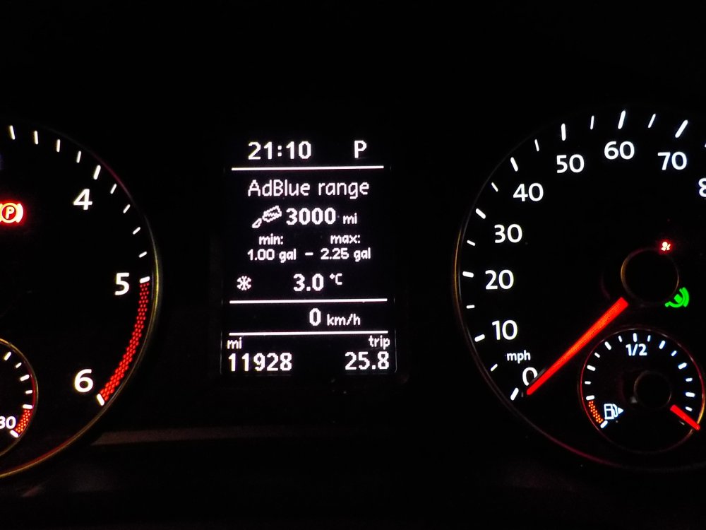

Not on a Yeti, but what might be expected to show.
This is with a 17 litre AdBlue tank. Would take 10.2 litres to fill.

Graham, on my 2017 SE L there is no option on the Maxidot display menu specifically for Adblue.  However, if I tick "Range" on the Maxidot display menu then I get two range screens when I cycle through the Maxidot display: one has a little petrol pump icon and tells me how far I can go with the fuel left in the fuel tank, the other has a little pouring bottle icon and tells me how far the I can go with the Adblue left in the Adblue tank.  It's that second display that tells me how much Adblue is needed to top the tank up.  As kenfowler3966 says, if the Maxidot is set to imperial units then the quantity it shows in gallons is not very precise, but when the Maxidot is set to metric then the litres figures shown are rather more useful.
If your Maxidot doesn't display the Adblue range as well as the fuel range then it would seem that the Adblue range function was a later addition to the Maxidot functionality.

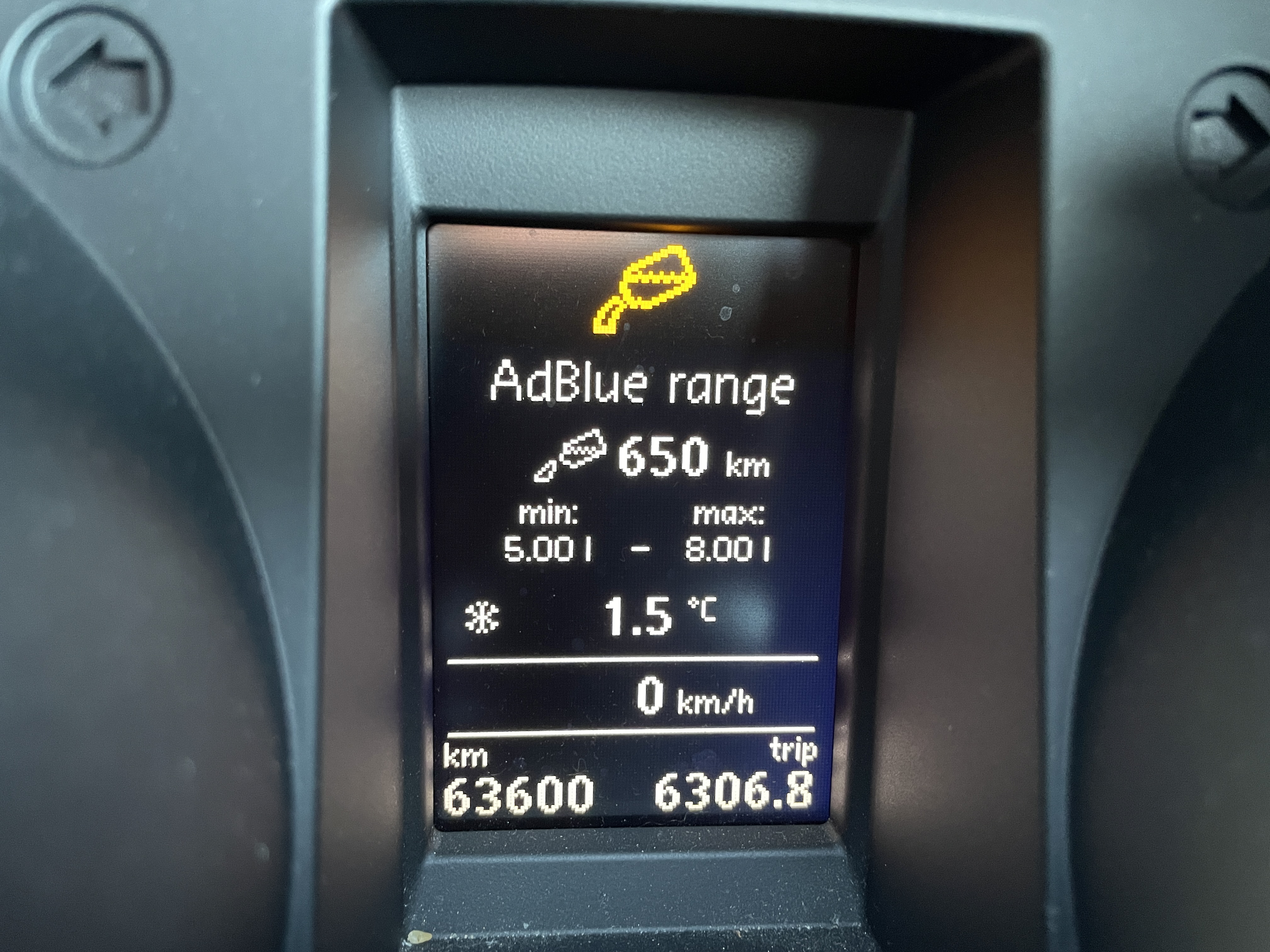

  • 2 years later...
I recently got the Adblue warning on my Yeti. I changed the units measurement from miles to KM and the warning changed from gallons to litres..
