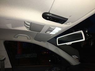

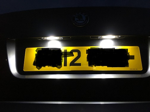

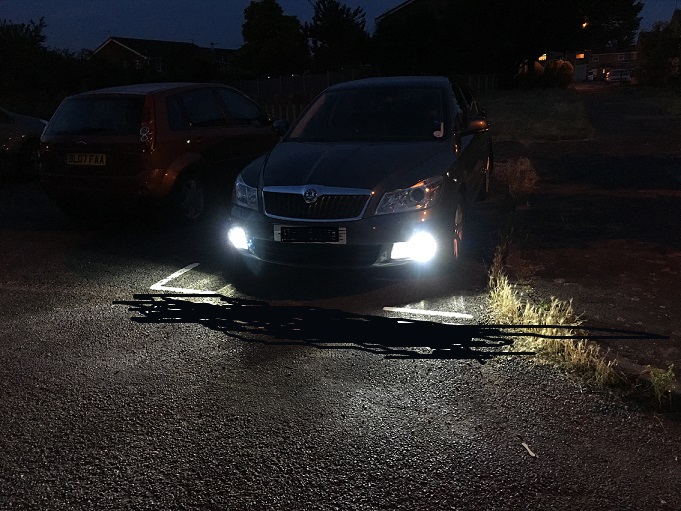

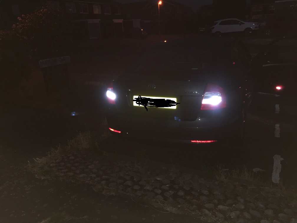

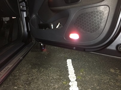

Hi there,.......   Can you remember how in VCDS you told the BCM to expect LED's please.
I am just about to put LED Stop/Tail and Indicators in, and I fear that I will get the warning light, but I have the VCDS system, just don't know where to look.
I have been lucky so far.   All Interior bulbs changed with no problems.   DRL's changed with no problems.    Front fogs have resistor packs to smooth out the cornering system as well, and stop the flicker.
I managed, (purely by luck) how to find the number plate light LED light warning in VCDS, and check it.     But I'm flummoxed when it comes to the items mentioned.
Thanks in advance if you can help please.
