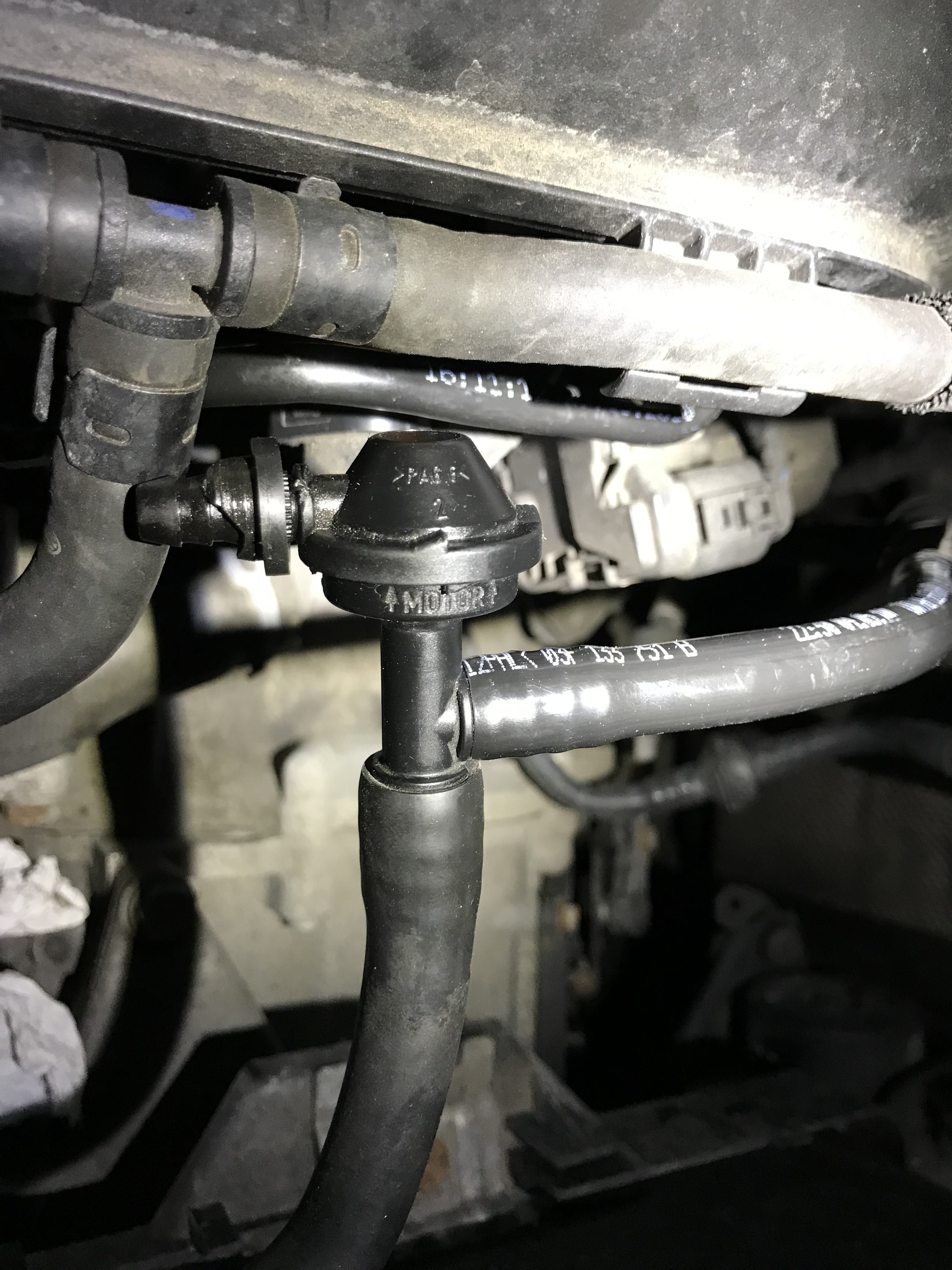

I have been suffering from a slightly oily smell inside the car for about 4 months.
After looking really closely under the bonnet I finally traced it to a broken off return (PCV ?) valve which is attached to the top of the engine.
As the valve is underneath a larger plastic part of the intake system it not that easy to see.
As I pulled the pipe out I saw the broken part and traces of oil in that area, in the pic you can see the small broken valve casing outlet tube.
Just needed to buy a replacement,   it was really bugging me and I assume its a fairly common problem ?

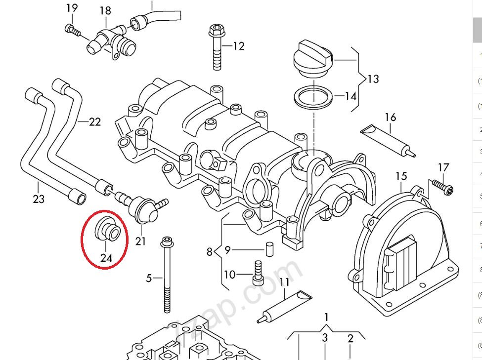

That’s different to mine. I have 3 connections on my valve. See picture above.
It looks like it's this grommet. Item 24 part number 03F 103 638, although as I say part 21 doesn't look like mine. I have an extra connection.
Yes I saw that. Sorry I can't help you with that
