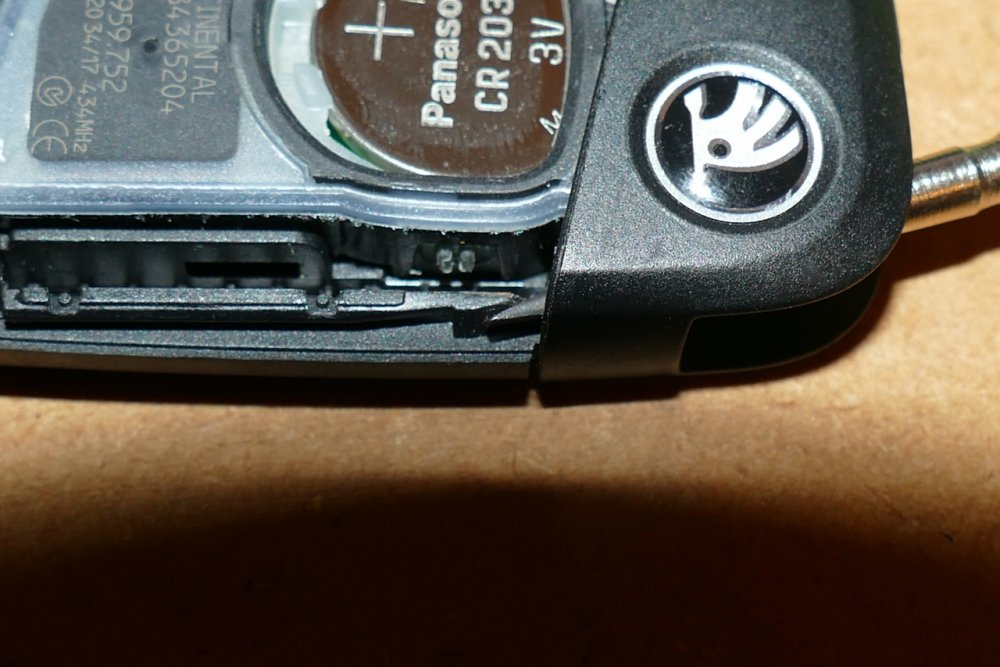

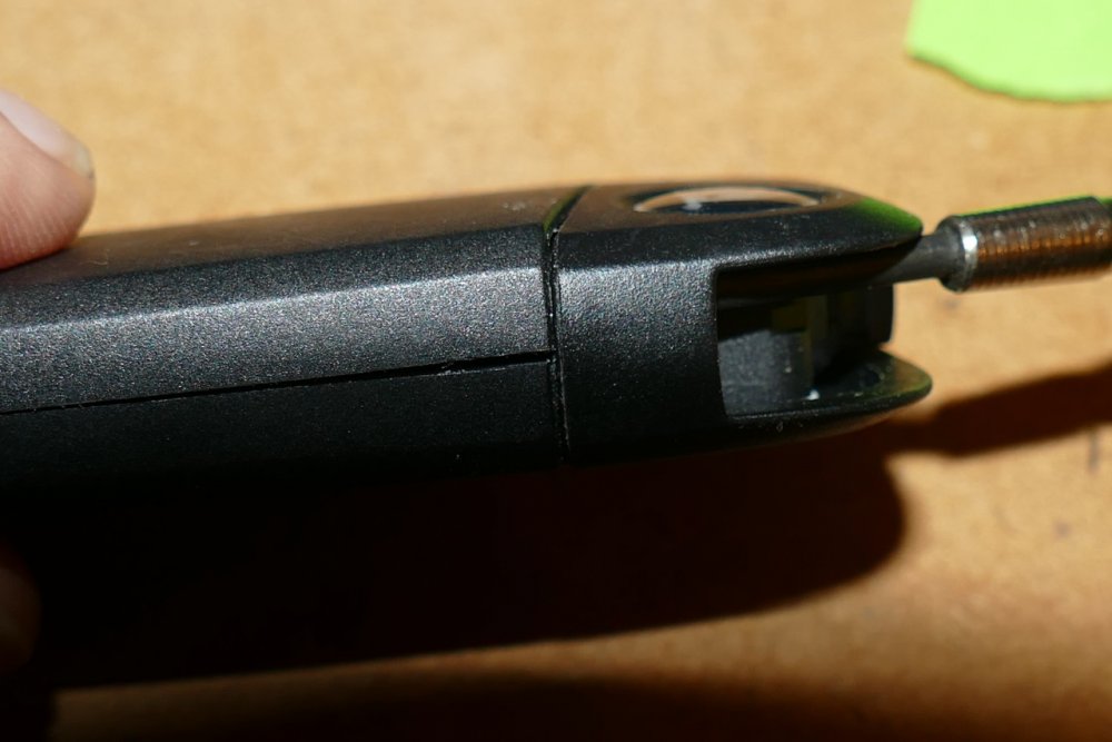

That video isn't right and risks damaging the casing. However the way to do it is far from obvious, hopefully this picture will show where you are trying to get the screwdriver to go once you have removed the key. You are trying to get the tip of a small (3mm is a bit small, 5mm is too big) screwdriver to do down along side the little ramp (you can run it down the inside of the casing in the top half, just above the join line between the two halves) then give a little twist and a gap will open that you can get you finger nail into and pop that side of the cover off, then lift the cover a little and push the cover (fairly firmly) towards the other side to unhook it.

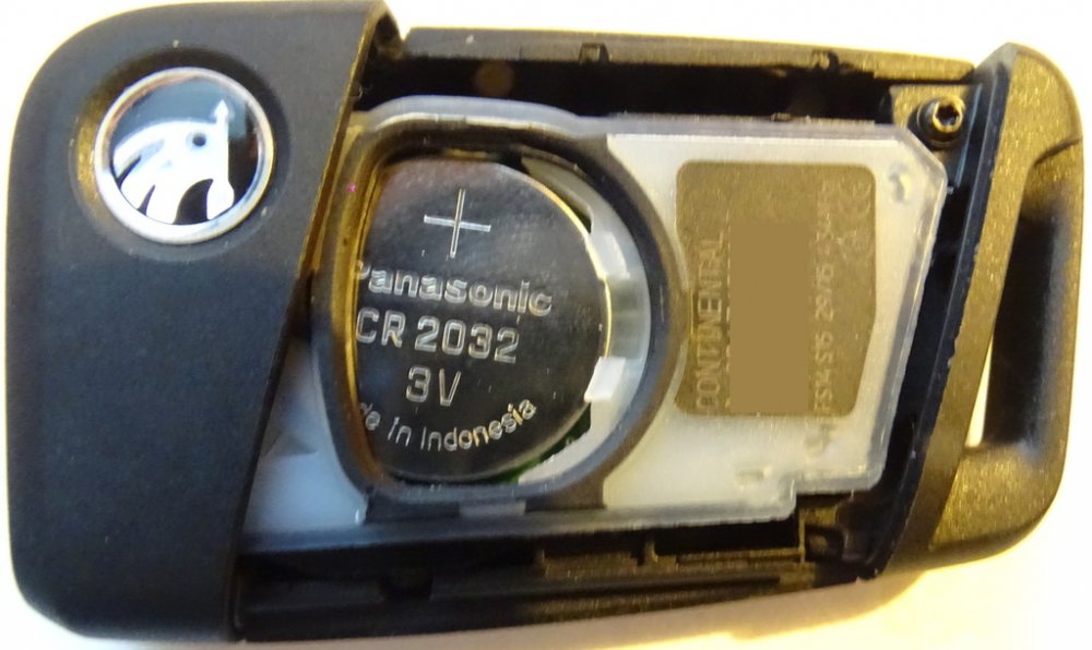

Just what I need. I’ve just bought my first Skoda (Superb estate 2016) and I have the warning light too.
Mid the Panasonic CR 2032 the correct battery for all?

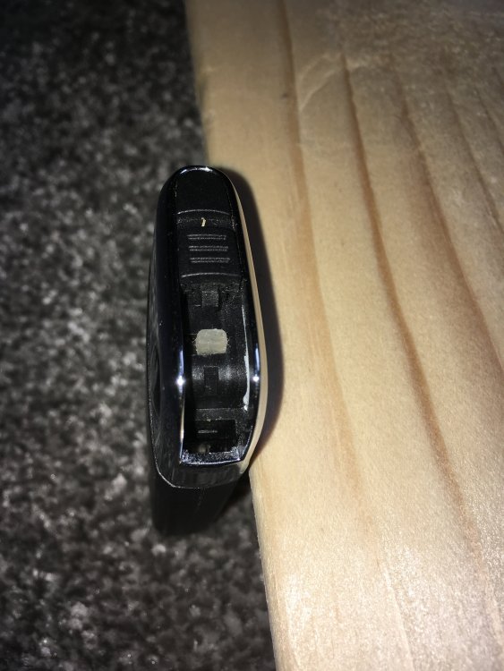

I’m brand new to the battery change thing, and picked up this thread after trying to work out how to get the cover off. The electronic guide tells to go to a page that refers to car battery change! The printed guide is as everyone says, unclear as to where the screwdriver goes. I initially read it as going into the void left by the removed physical key blade but quickly decided that was not correct as nothing’s in there other than the void.
So I saw a hole further inboard which was promising, and made more sense, as the screw driver blade would definitely be in an area more likely to hold a release catch. But it’s blocked by a rubbery plug that I think is to make the physical key hold more firmly in its storage. Maybe that plug is not present on earlier keys and is simply removed to get the screwdriver in. I don’t know but so far I have shied away at  pulling it out. I wondered what others have found. Thanks

 If you remove the rubbery plug you can't replace it and it only helps keep the key blade tightly in place.

I've just changed the battery for my Skoda Superb (2017). paul_7_7_7's post worked for me - but the screwdriver blade size was critical. Mine was just under 5mm - smaller ones just did not work!

Thanks @paul_7_7_7! This was just what I needed! Great clear explanation and screwdriver poking through pic was v helpful!
