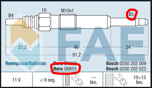

Also, edit, just checked, the nose of the glow plug seems to be 5mm dia. This would be no good then.

I haven't used that tool, I was planning on replacing my glow-plugs, so it got me looking and that was the cheapest tool I found, but it looks like it's the wrong one :(
