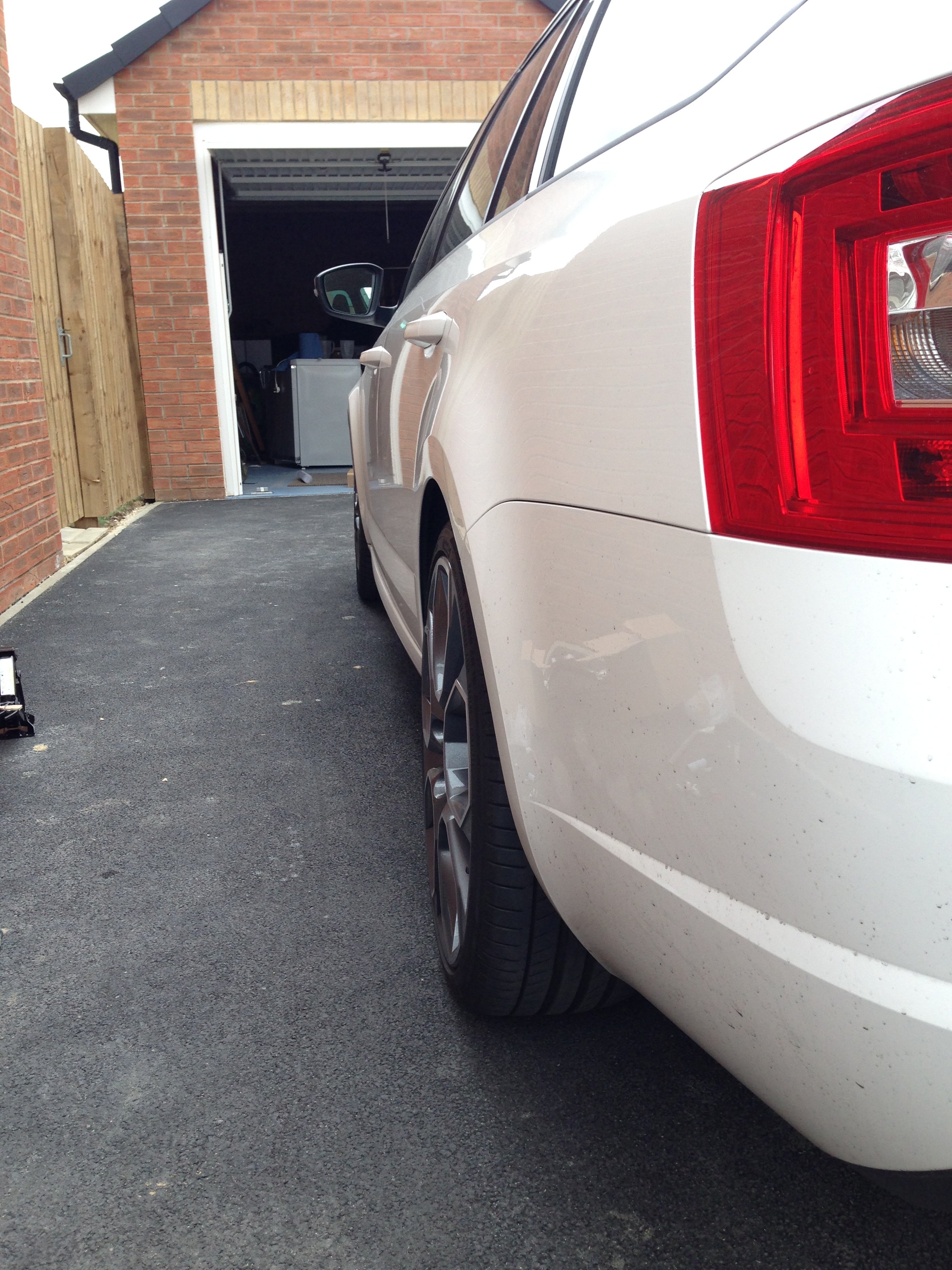

On 02/10/2017 at 23:28, Robfab said:
Thats mine with 20mm front and rear. Albeit pre facetlift, I did wish Id of gone smaller if i remember correctly but this was 3 and a half years ago.D6987087-6E44-4BD2-9115-37903A94A899.jpeg.3f530e95452327ace0682d9d8b77c778.jpeg73526922-410E-4856-8823-95F422BF0C1E.thumb.jpeg.139144e2bf446d1447c2d3b43bd3012c.jpeg
