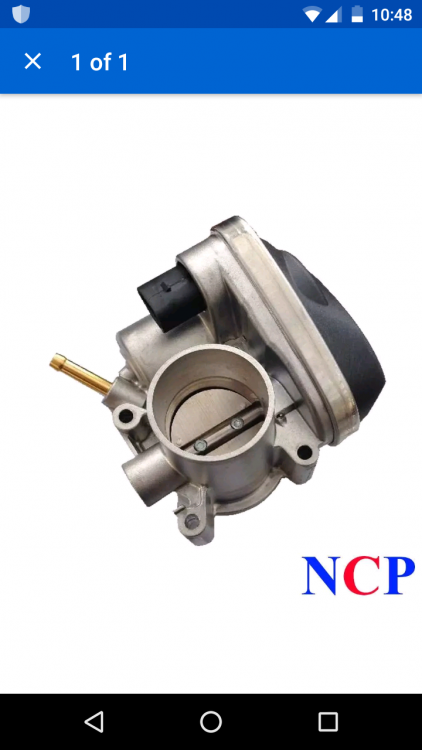

The L one has a gold pipe leading off it ..does a pipe plug into this ? Currently have no pipe plugged into the old one.
Help please. Do I buy 036133062L or with N or B on the end. Does it matter?
Pic below for gold pipe

It'll probably work, just blank off the hose barb, the letter denotes a minor revision to the part, often a different supplier.

L suffix looks right according to this page: https://skoda.7zap.com/en/cz/fabia/fab/2003-225/1/133-133030/#12
Not sure what N-suffix is, but the version for AUB/BBZ is suffix M according to this page (item 2): https://skoda.7zap.com/en/cz/fabia/fab/2003-225/1/133-133035/ and I'm reasonably confident that is a bigger bore (because the L-suffix one also is used on the 1.2 engine). So maybe your car has had one fitted that doesn't suit it?  What's the problem, remind us please?

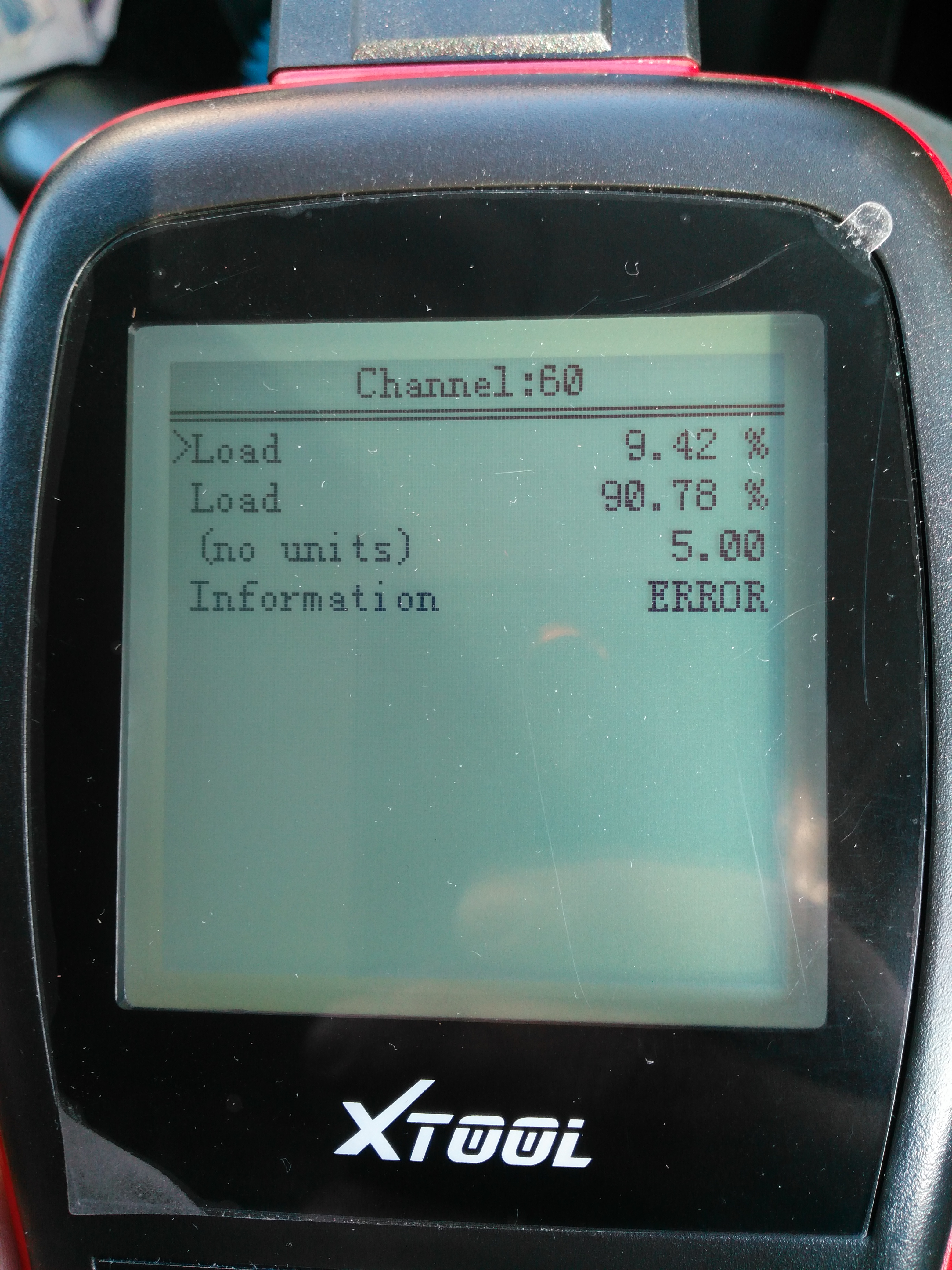

I've cleaned up the throttle body. It had bad idling and sluggish feeling. It stalled at low revs too. I have a G28 code too. You kindly pointed to me to the right sensor for the crank.
The throttle body won't align. I was thinking that a previous owner put a generic throttle body on causing the problems. It says the basic conditions are not met. I have the right battery voltage, no DTCs, or all cleared. Engine on but not running.
It might be the wiring loom, but I checked with the multimeter and it seemed ok.
I can't adapt the throttle body at all. It says error during the run. I have a Vag 401 diagnostic handheld. It does throttle body adaptation.

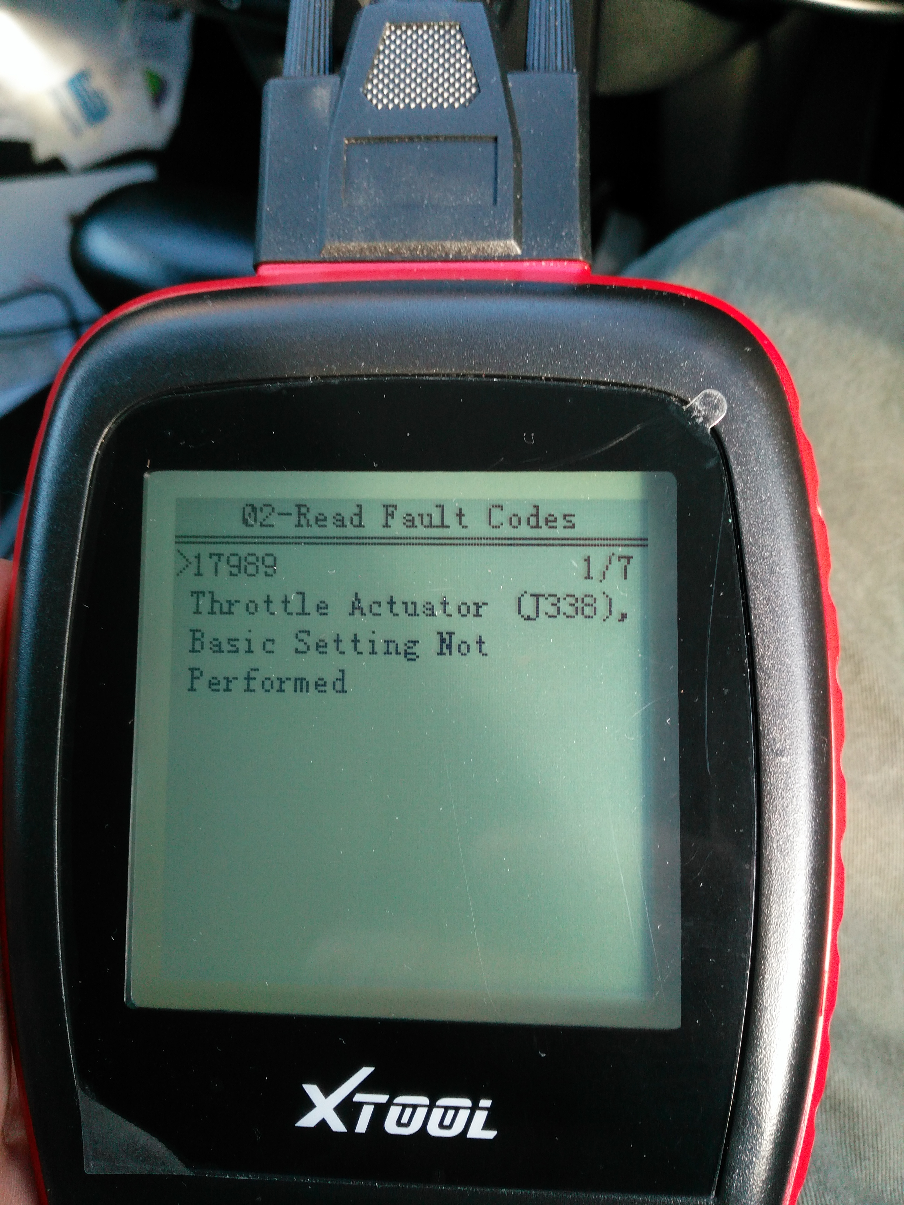

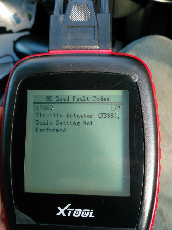

Here is the error code.
Never come across that tool before. Is that reading measuring block 60?
I don't see a fault code, do you have any VAG code or OBD code? Other than the 17962?
It is inexpensive Vag 401 that does most things vcds does. Yes channel 60. The other code is throttle body adaptation not performed. Thank you for all your help.
