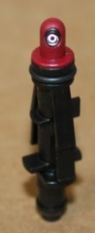

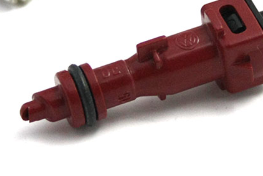

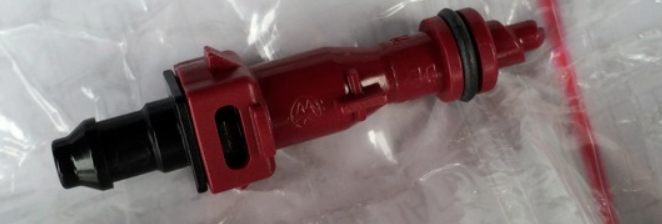

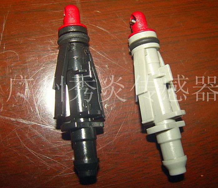

Anyway, the original part number is 5G0955993
image.png.338c04f84640a1180af6b18e0c399b9a.pngimage.png.3a999aca88862fb69839c730f0f4eb18.png
Can't it be swapped by 5K0955993 (Golf)  ?
image.png.86b0f68432ec17ab290d6607b5f097c1.pngimage.png.baa373d20c53dfae8bbeca6908e0e0bf.png
I know you will say it's different, but look on the shape...it's not so different.
Unfortunately I can't compare it myself. Maybe it's a nonsense....

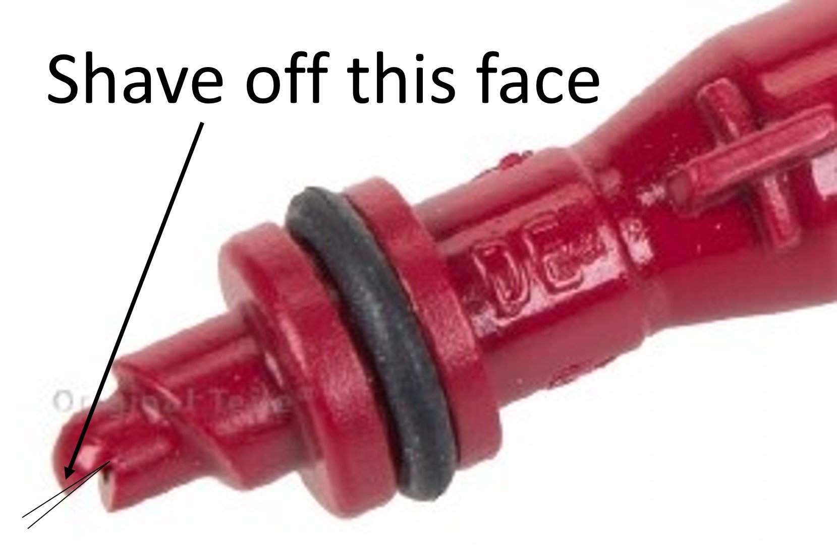

mine spray fine now but were rubbish. like they hadn't been tested at all. I took a Stanley knife blade to the top of the opening increasing the angle of the opening. Don't take off to much at once though.

Trying to solve a similar problem. Jet needs a quarter turn..... but can anyone tell me how to get the washer jet away from the actual light fitting? Is it just brute strength or some sort of clip. The diagram above is too small to see details!!
