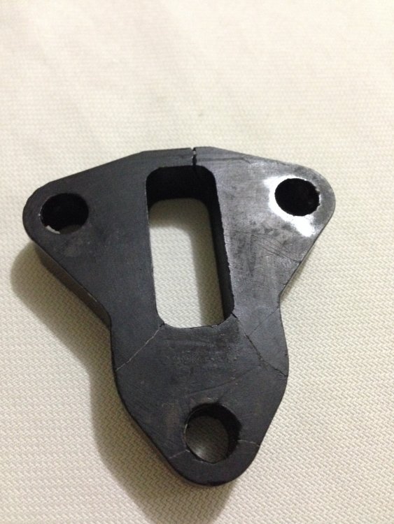

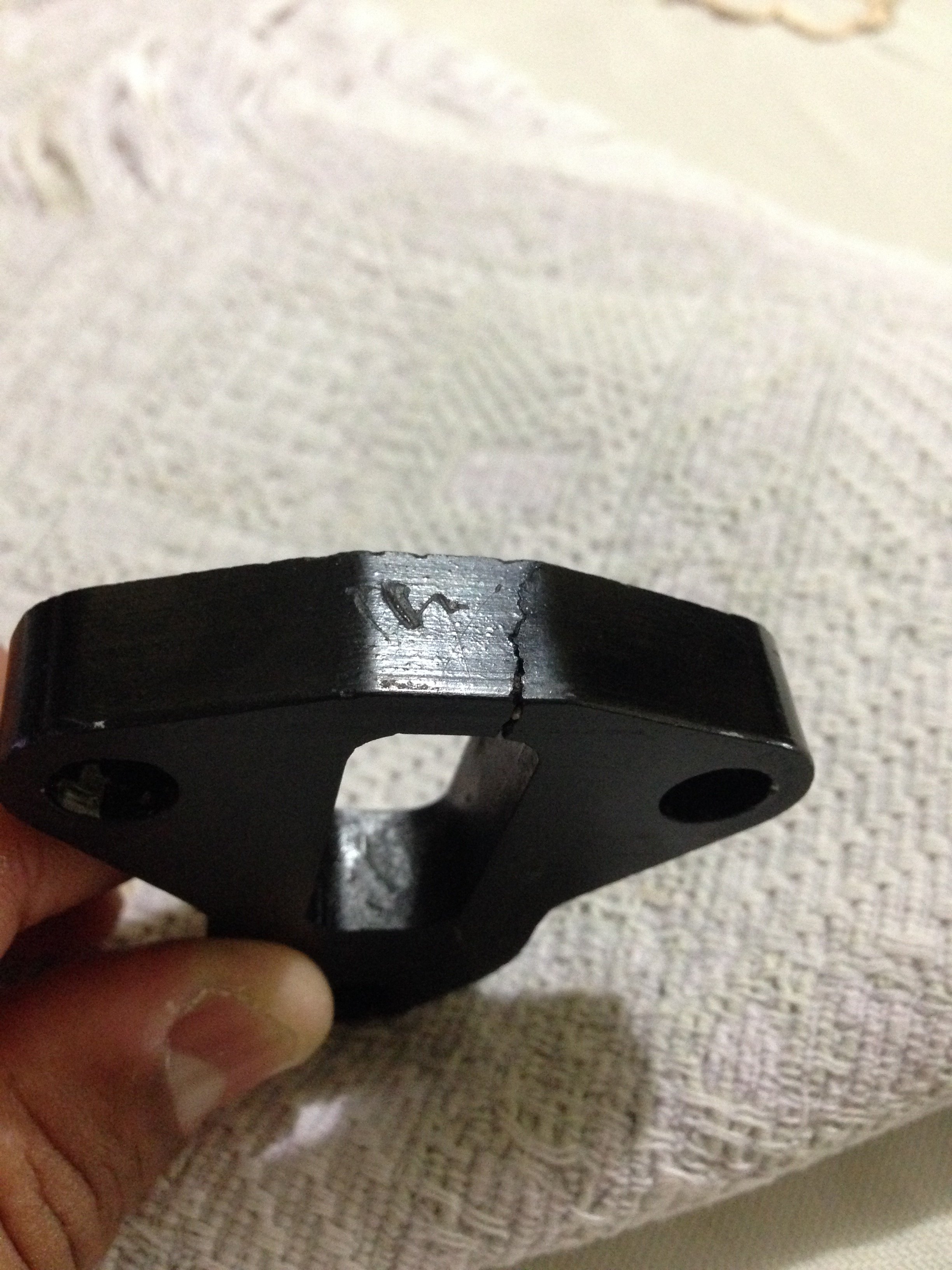

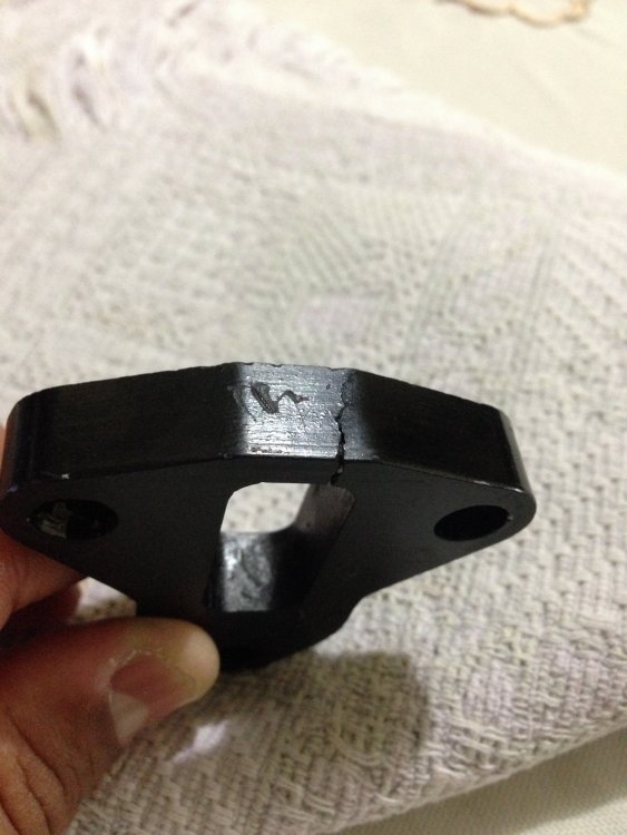

The reason, I think, previous owner switched to this electric fuel pump instead of the one that came with the car is that somehow it got damaged. I took it off and saw a lot of grey sealant. The reason for this is that the plastic spacer is broken in three areas, thus allowing vacuum to go out. Here in Dominican Republic to get that spacer is a bit hard. I could order it from Europe but it costs. There is a place here where they make the spacer using strong/thick rubber. I have already bought the mechanical fuel pump that comes with the Felicia but the store didn't have the spacer.
Do you think it would matter if I use the rubber spacer with the same dimensions as the original? How do I install the mechanical fuel pump? Is just matter of sticking in the rocker arm, and put the bolt and nuts? Or needs the rocker arm to be inserted in an specific way? Also, is it true that an electric pump would perform better than this mechanical fuel pump?
Not even close. The spacer needs gaskets on both sides not because the vacuum "goes out" :wondering: but because the engine oil might get out.
No. The spacer is there for the lever of the fuel pump to be engaged properly with the cam on the camshaft thus ensuring the required fuel flow and pressure gets to the carburetor.
