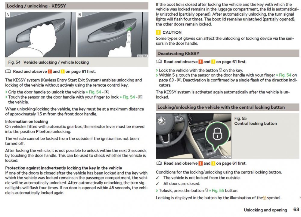

Hi,
I tried to put my hand on the handle, but it doesn't close... Any idea ?
The sensor is on the handle and is shaped like a horizontal line. Touch it with your finger.

As said there are two sensor areas per front door. The main handle area is for opening. There is also a small dimple / slot which is the sensor area for locking. Of course you need to have the key on you (or very close, and not inside) for this to work.

Yes in the manual it states "After locking the vehicle, it is not possible to unlock within the next 2 seconds
by touching the door handle. This can be used to check whether the vehicle is
locked."
So lock it with the sensor and try to open it again before the 2 seconds has lapsed.
2 seconds doesn’t sound very long, but I’ve tried it and it’s not difficult. However I don’t bother, I just look at the mirrors!
