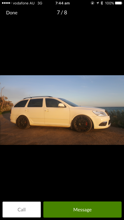

Ideally I just want the car like the VRS height (maybe a little lower with black wheels). The thought of the champagne colour car with black tint, grill, wheels and arches makes me smile.
like this but with the scout (not as low and with 18s not 19s)

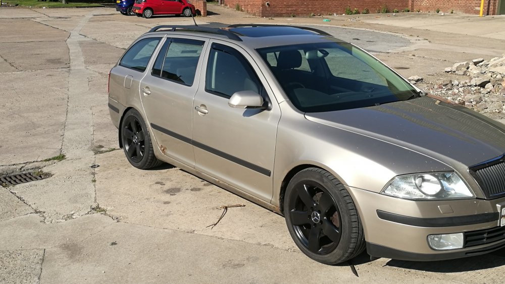

I put towing rubbers in springs to stiffen it up abit , I think you will struggle to find any tbh . Heres mine on 17" merc rims didnt want to go much bigger .
I'd be happy with that ride height, just don't think it's going to happen because no one seems to have really done it.. Yours isn't a scout is it?
No but its a 4x4 so it shouldnt be much different other than ride height , I wouldn't have thought ?

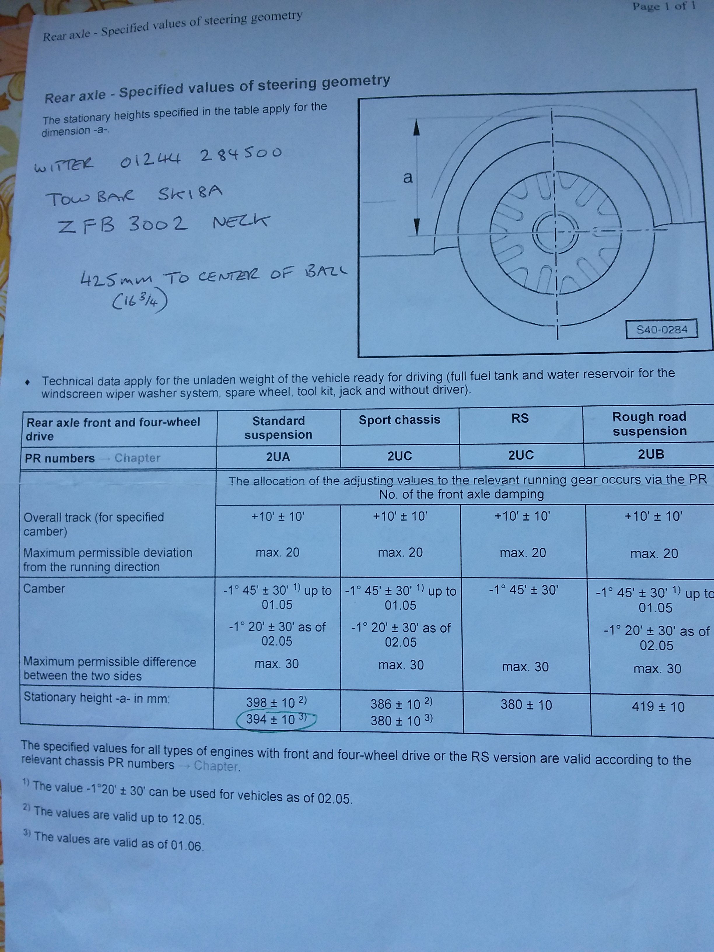

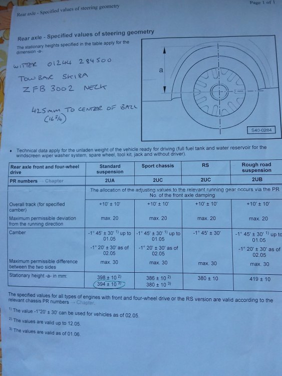

Photo below gives difference between suspension types,
