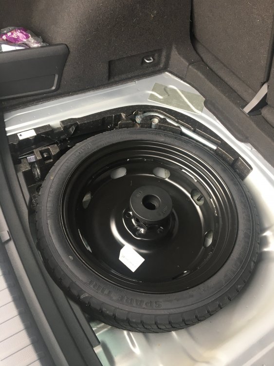

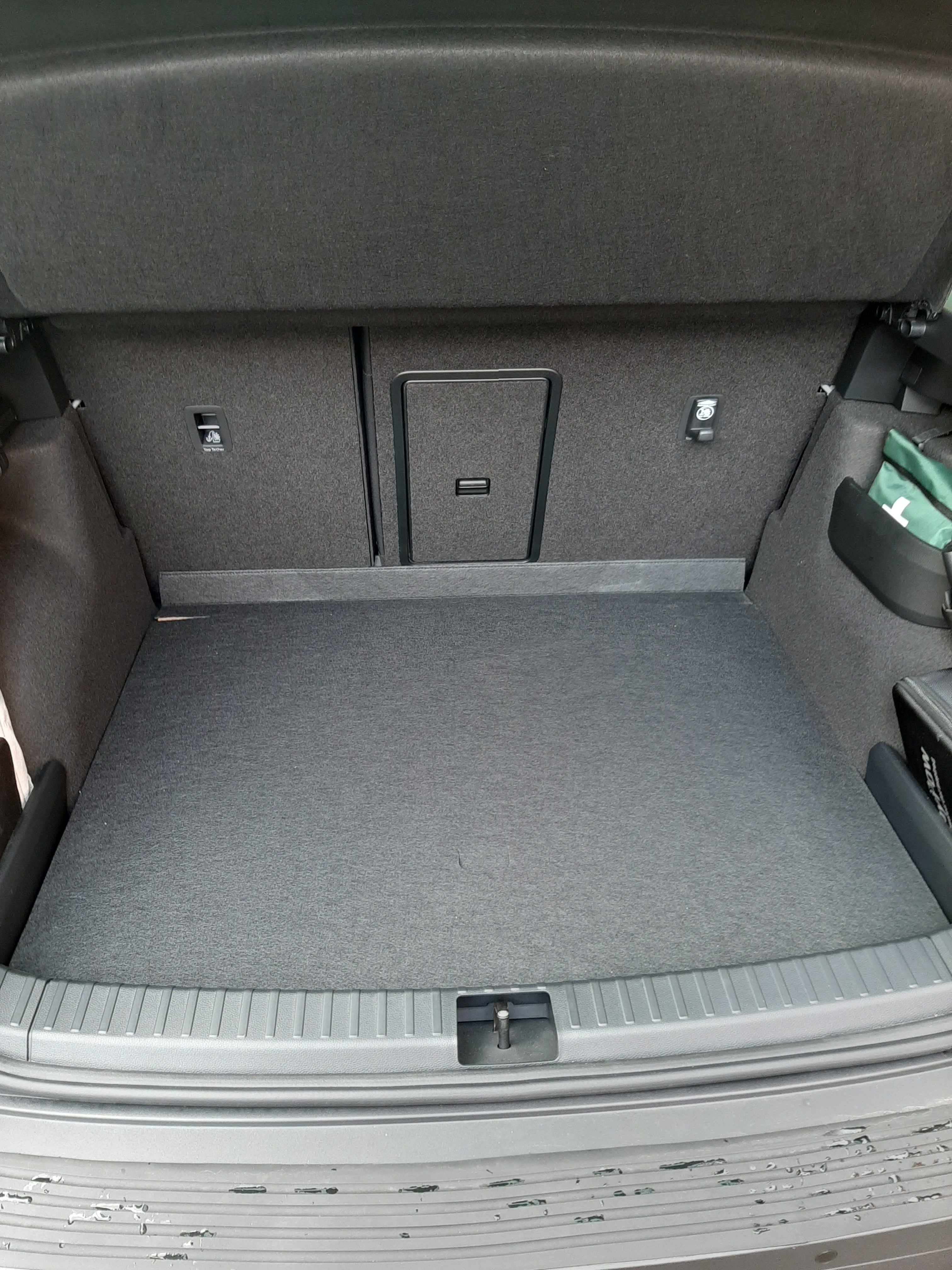

 does it look anything like this picture ,has your 4x4 got a wheel well or is it a flat surface?

Yes, just like that.  No wheel well, the skinny spare just sits on the floor.
Note amount of room around the spare.  That allows a proper sized tyre to fit in nicely and this is my plan for full sized spare.
Just got to sort out how to sort out supporting the floor either side of the wheel in there.
PS But remember mine is a 4x4 version so my floor is a good bit higher because of the 4x4 gubbins.

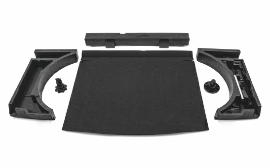

Thanks you very much for sending the pictures, the karoq I have has a wheel well, so hopefully purchasing this kit will raise the floor level but will be flat and level.
To support your floor may I suggest the use of polystyrene insulation block which is easily cut with a knife to the shape you require.
Just had a measure of the polystyrene bit of the spare wheel fitting kit and it’s 10.0cm deep.  That should let you see where the boot floor will sit with the wheel in there.  If it was me, I’d bung the Ratikon you have in there and see where 10cm above the side bits of the floor will take you wrt the side wall of the tyre.

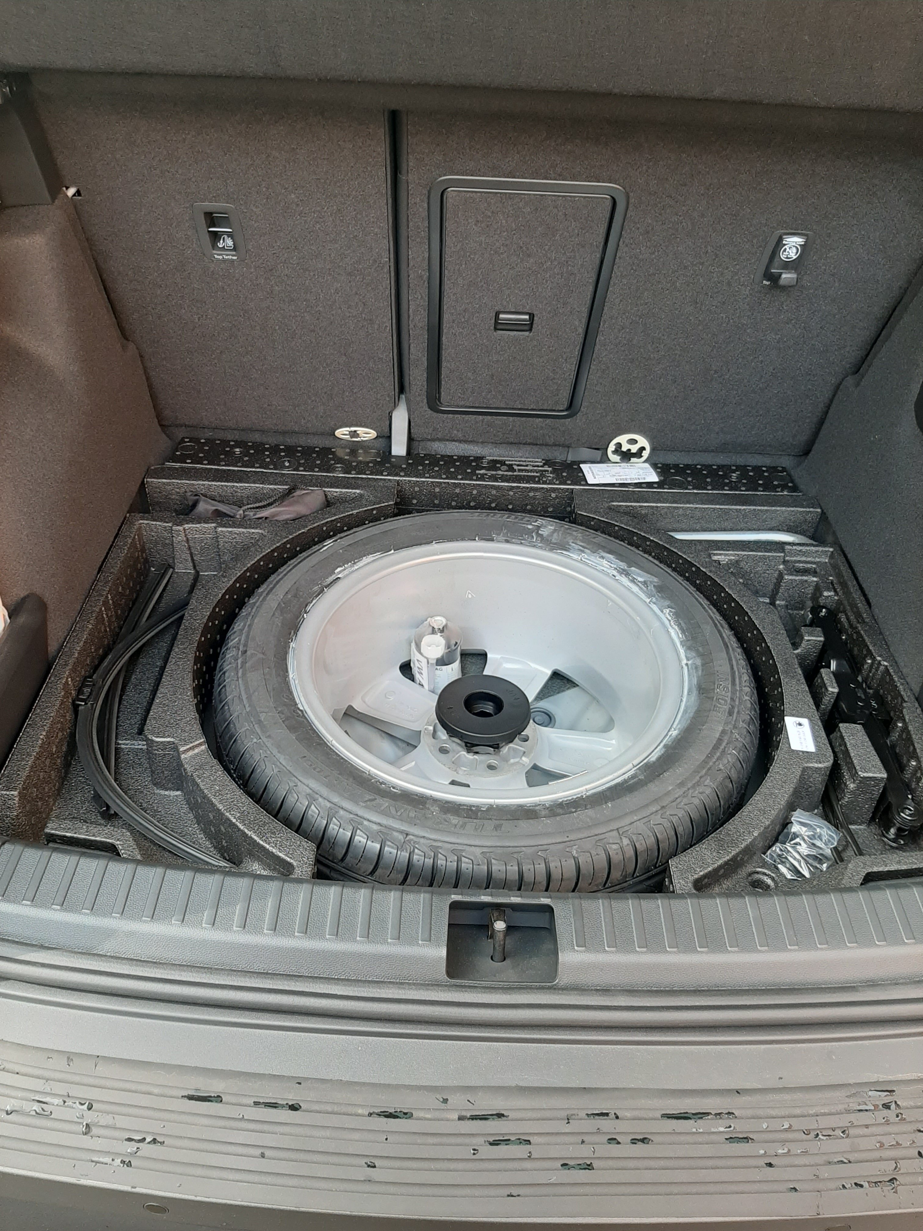

Just got the parts today,they fit very well into the space with the full size wheel.see attachment.you do loose some boot area but it's worth while having that piece of mind.20200923_122102.thumb.jpg.0b65b3a8d145a2d15269803c9c8f5b45.jpg
Just, literally, got my tyres mounted on the 2 spares, wish mine would fit as well.  Somehow don’t think this isn’t a long term solution!!
Had a search but can’t find the answer but are the polystyrene parts available without all the jack bits and pieces?  Thinking one set on top of the other would fit the bill for my needs, plus would provide a few cubby holes for bits and bobs to fit in.

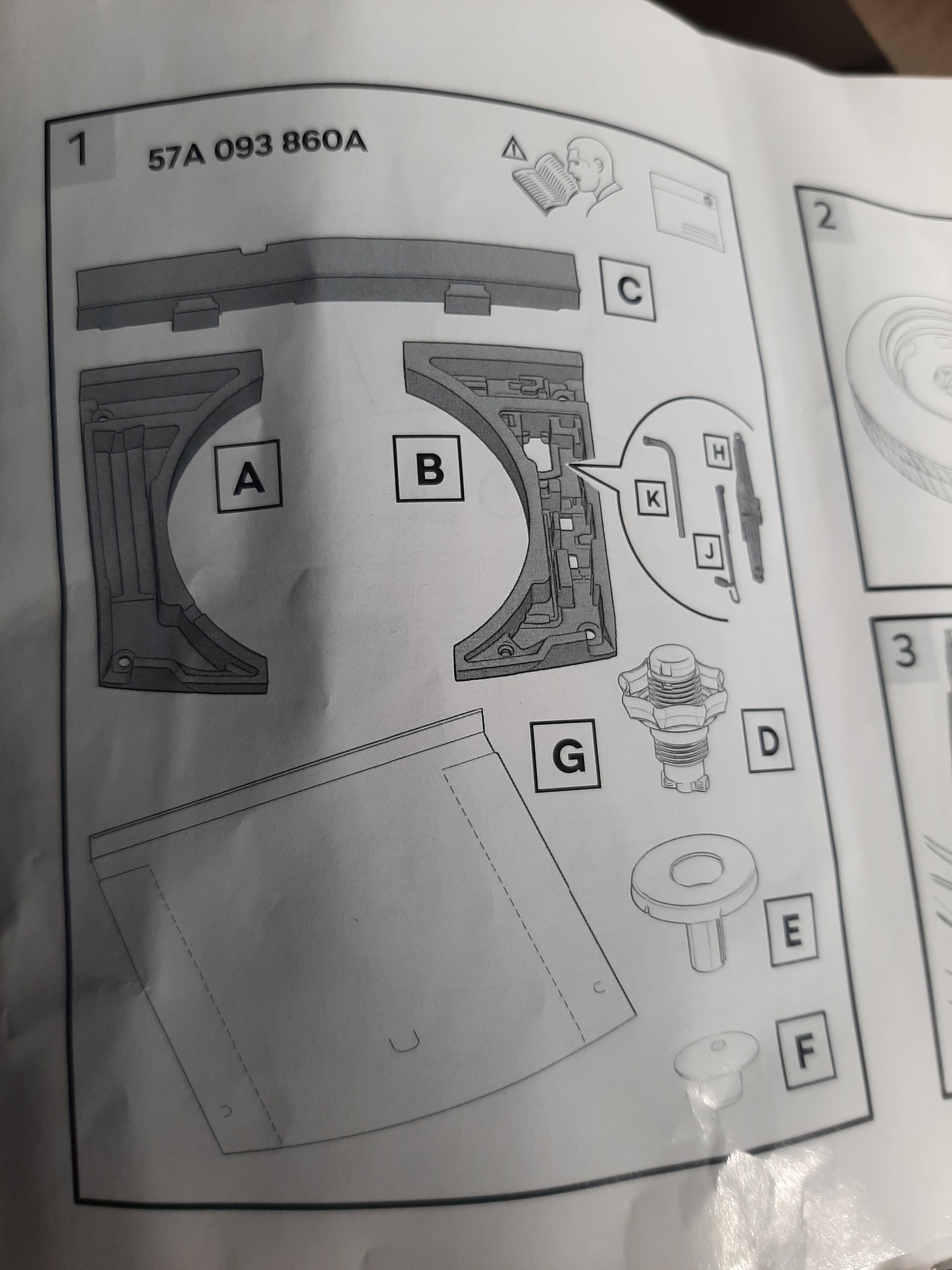

PS Found it, 57A093860A.
Edited by DSL
Think that part is c.£90? (£77.50 + VAT?)
Agreed, will have a think as to whether it’s worth that.  Also as my local dealer (Inverness) has closed it’s not quite as simple.  Might see what Horton can do.

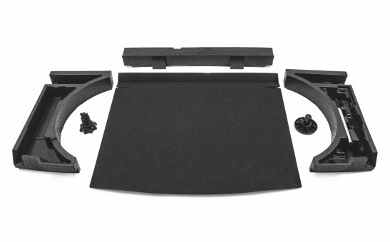

The part number for the kit is 57A093860A.

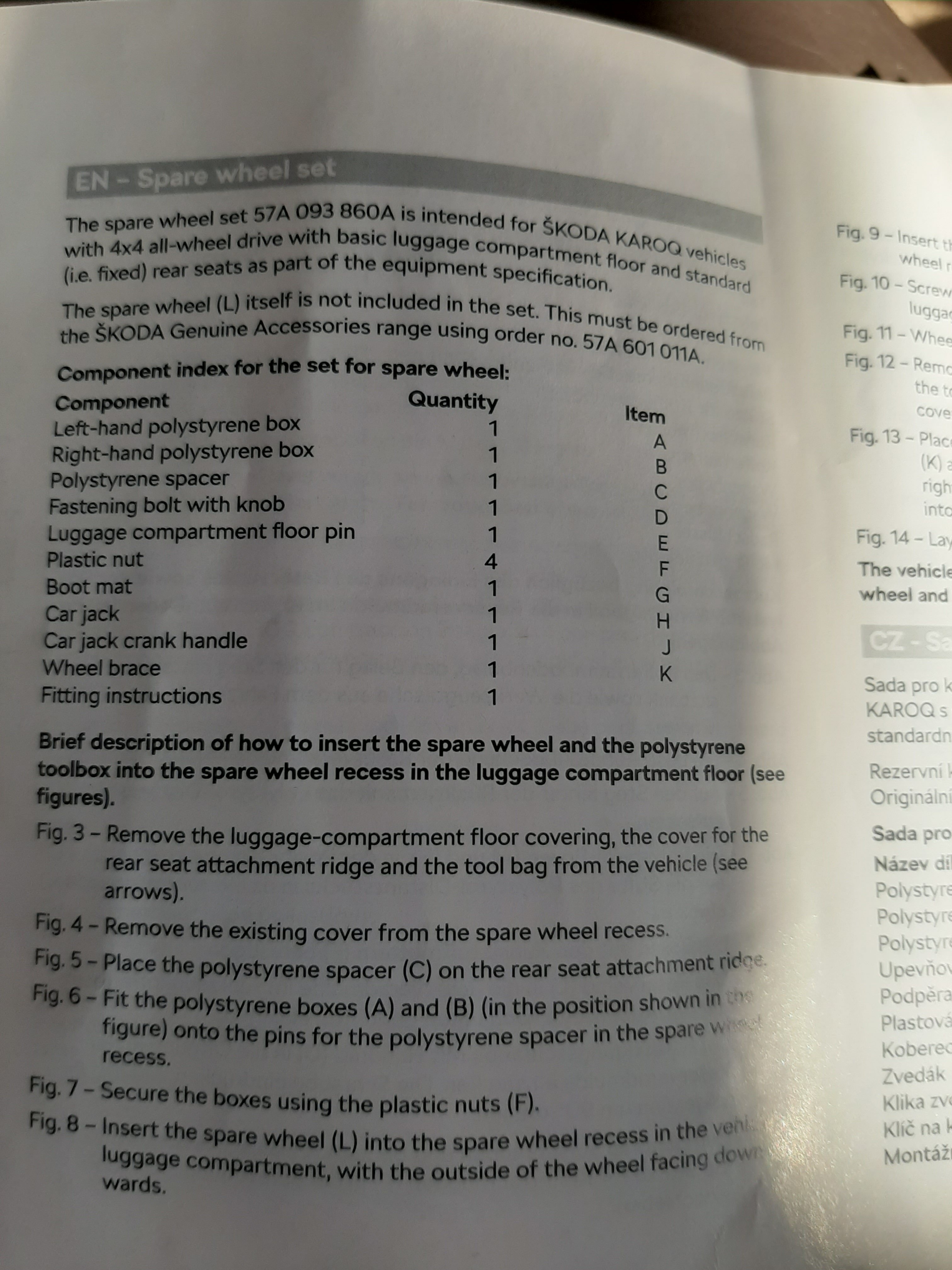

As I said before I have a 2wd and this kit is basically for the 4wd but does if you are using a full size wheel on the 2wd.This kit comes complete with tools.
Is there a car scrap yard near you, you may be able to just pick up the polystyrene bits at a fraction of the price.
The other option is go to B&Q they have polystyrene loft insulation blocks ,use your existing polystyrene as a template and cut o size.
Thirdly phone Skoda customers services  and ask them if they could provide you with these parts, they are very helpful
The kit cost me £95.and it came with all the bits and pieces which I needed
Why not find some thick polystyrene blocks used for packaging and stick them together to form spacers the right height. Place under the trays you have already  to support at correct height.

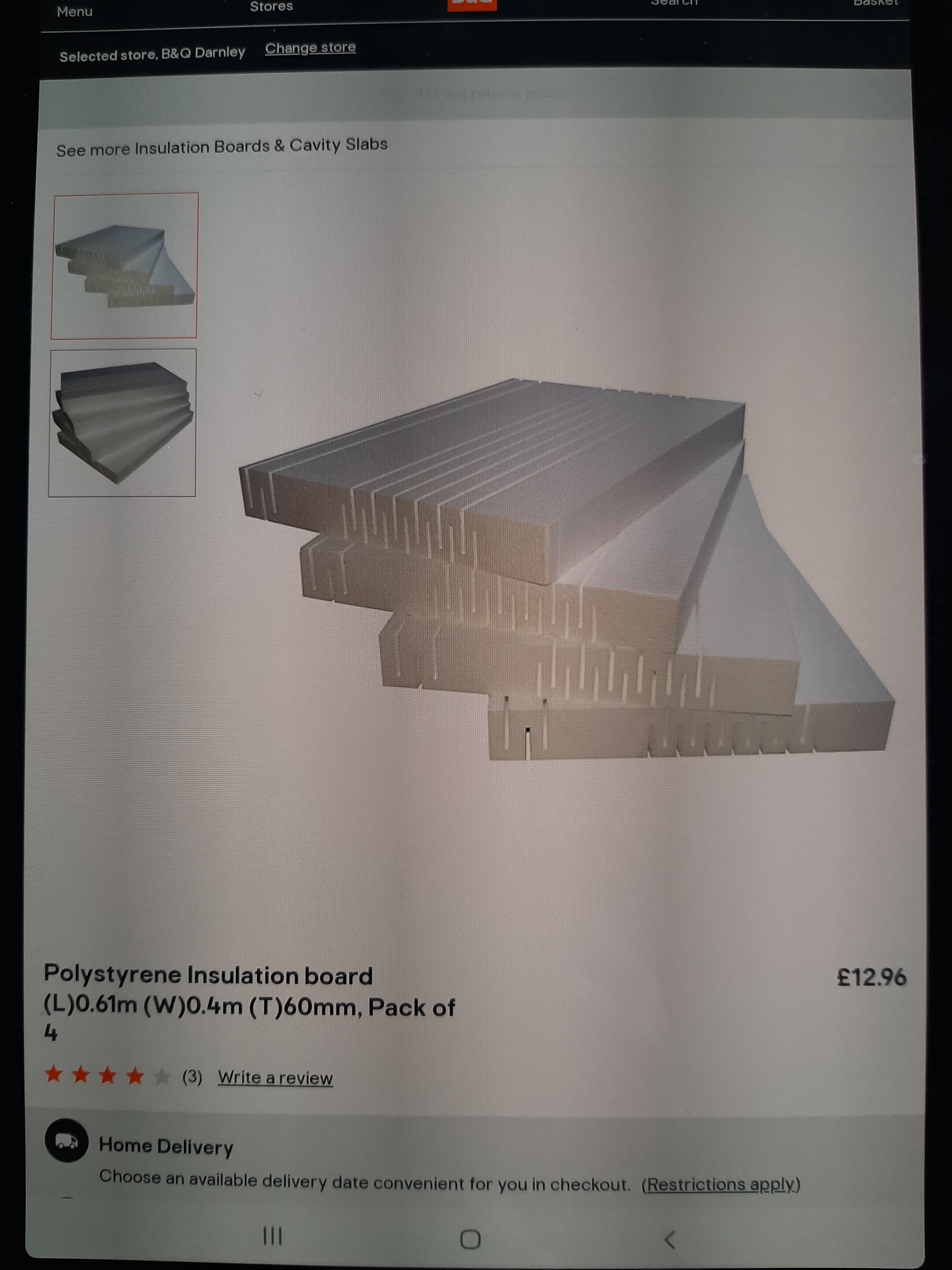

Looks like I’ll be going down the cheap route.  100mm thick insulation board/kingspan, cut to the shame of the fitted pieces then fix the factory fitted pieces on top.  And much cheaper!!!  Plus I’ve got a Travis Perkins just up the road.  Plan starting to come together, thanks for the advice.    :thumbup:

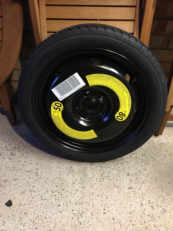

Karoq Sportline spare wheel sorted today. 18” temp spare new and unused from a 20 reg Karoq £40 plus fitting kit from ŠKODA dealer at £90. Have retained original emergency repair kit and will replace In vehicle and easily sell full spare wheel kit at end of my personal lease. £130 for peace of mind.

It’s a 2 wheel drive Karoq Sportline. The wheel centre security bolt comes with the fitting kit and helps support boot floor.
