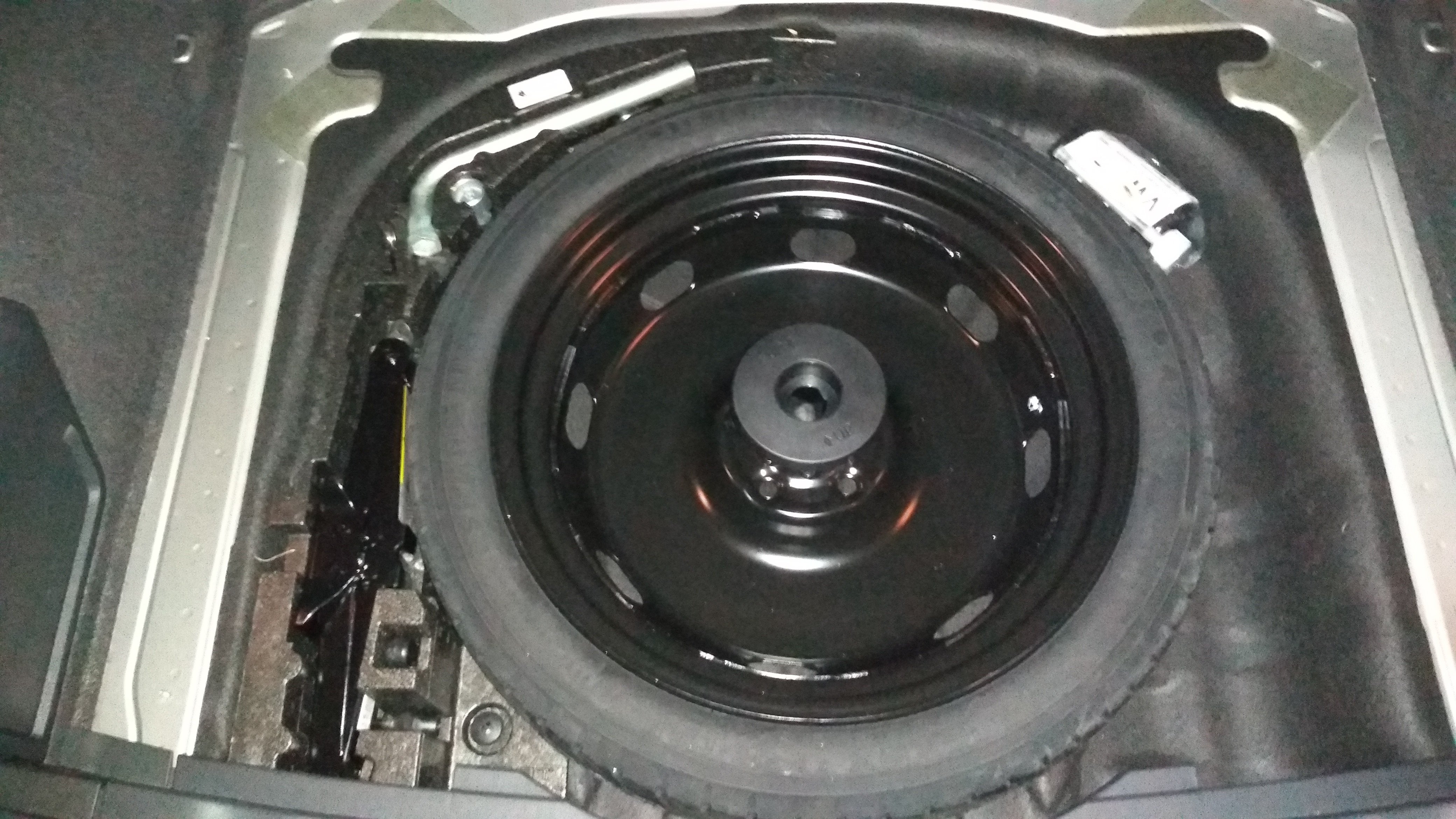

I have just bought a kit that has a space saver tyre with jack, wrench and foam blocks and the bit that screws it to the floor pan in the boot and it seems to work really well.
The tyre is a T125/70 R18 and it fits snuggly under the boot floor (I have a 2WD) and there is even a little cap that fits over the screw that holds the wheel down to support the boot floor
The kit is an offical skoda kit as it came in a skoda branded box and was from my local main dealer.
(sorry for poor quality of the picture, it is dark now and the flash on my phone is a bit wonky!)

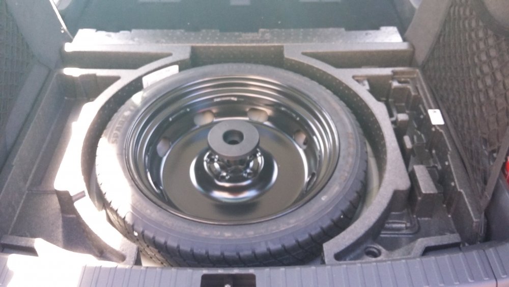

Interestingly mine has a different arrangement for the parts. I have the 4x4 so must have the skinny spare.
I also have Varioflex seats and this kit is for the fixed seats - however all you have to do is cut out 3 slots in the polystyrene to accommodate the seat handles (seen in the top of the picture).

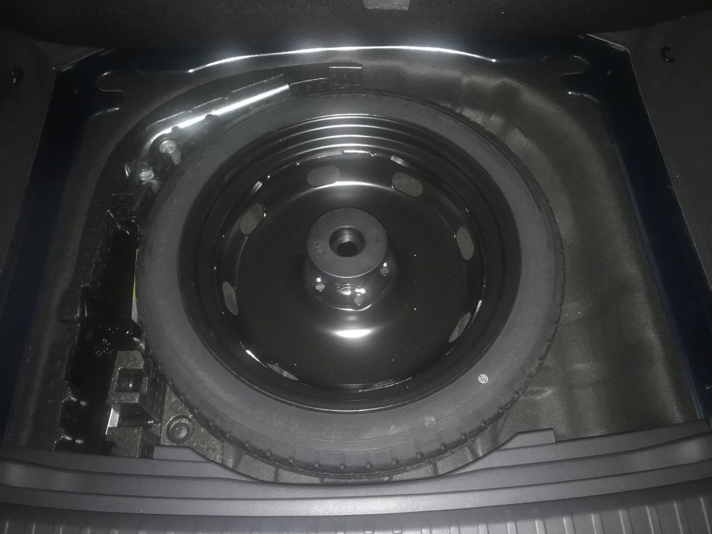

I have a 2WD Karoq SE-L with the Varioflex seats, and it came with a skinny spare wheel (125/70/R18)  - see attached photo.  As there seem to be so many different combinations available, does anybody know which specific parts would be required in order to be able to put a full size spare wheel in the boot well, instead of the skinny one?  I don't mind losing a bit of boot depth to accommodate the full size wheel/tyre.  I originally tried to order the car with a full sized spare wheel when I bought the car brand new, but it wasn't an option - I think I read somewhere that this is due to the Varioflex seats taking up a bit more space than the standard seats.  My sister has a 2WD Karoq SE without the Varioflex seats, and hers came with a full-size spare wheel.  But I think I also read somewhere that it's possible to put a full size tyre in, and that you just need to cut away a bit of the polystyrene around the Varioflex seat handles.  I was hoping that I could just buy a cheap set of polystyrene inserts and re-use all of the other existing parts, but that's probably over-optimistic!
I went through the spare wheel saga with my previous 1.0L Karoq. At one stage it was possible when factory ordering to specify a ‘full size spare wheel’ for £250, which was an actual alloy wheel, but only as factory order at the time. This option has now disappeared. I later ordered the ‘temporary steel spare wheel for £150, is 215/60 R16, and came with polystyrene boxes and central support, which raises the boot floor to almost door level. I now have this kit in my 1.5 SE DSG, I have measured the overall size of the 215/60 R16, and it is virtually the same size overall to within a couple of millimetres of the diameter of the 215/50 R18 of my car. So I imagine a full size alloy spare would fit in the same place.
The polystyrene raised surrounds are apparently available to order separately, and you would need a longer centre spindle, which supports the centre of the boot floor, if you go back over the previous spare wheel postings over the months , they have become separated under different headings, the part numbers are there and numerous pictures.
Also if you download the Accessories brochure from the website, it shows a picture of a ‘Spare Wheel Kit’ for £250, but no mention of size.
