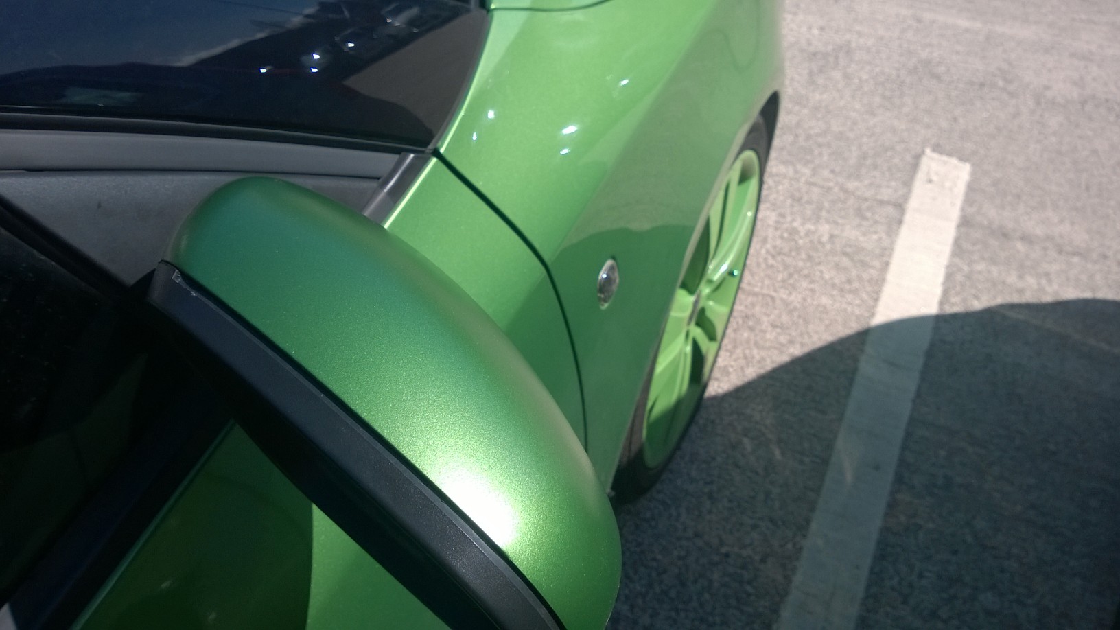

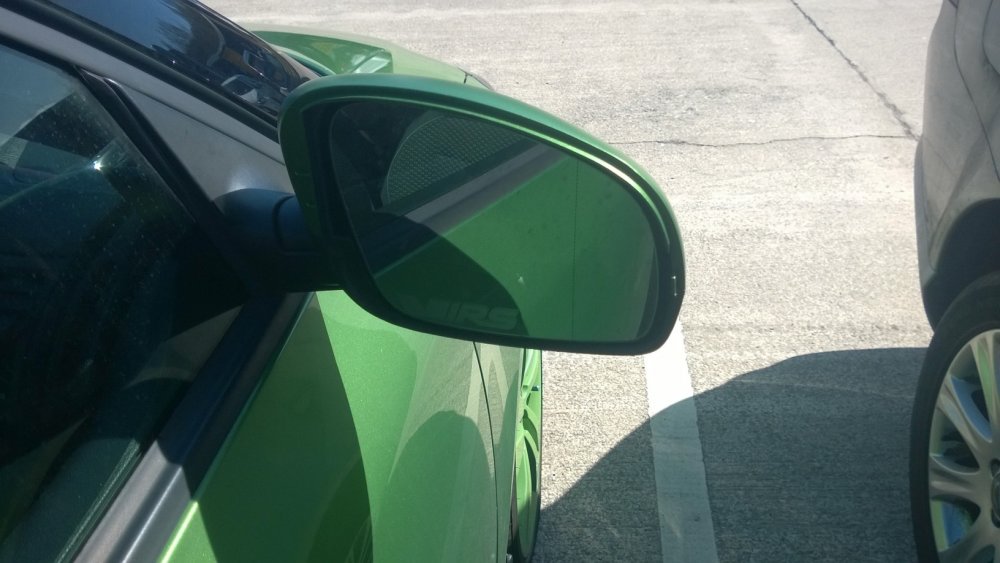

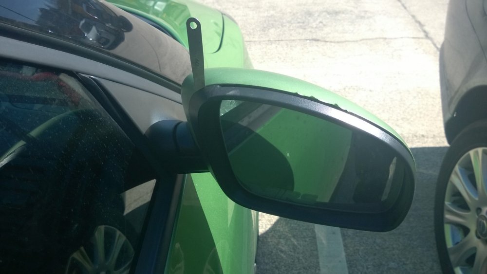

Edge off surround using 0.5 to 0.6mm gauge, then pull with finger nails
then lift top cover upwards no need to remove glass!

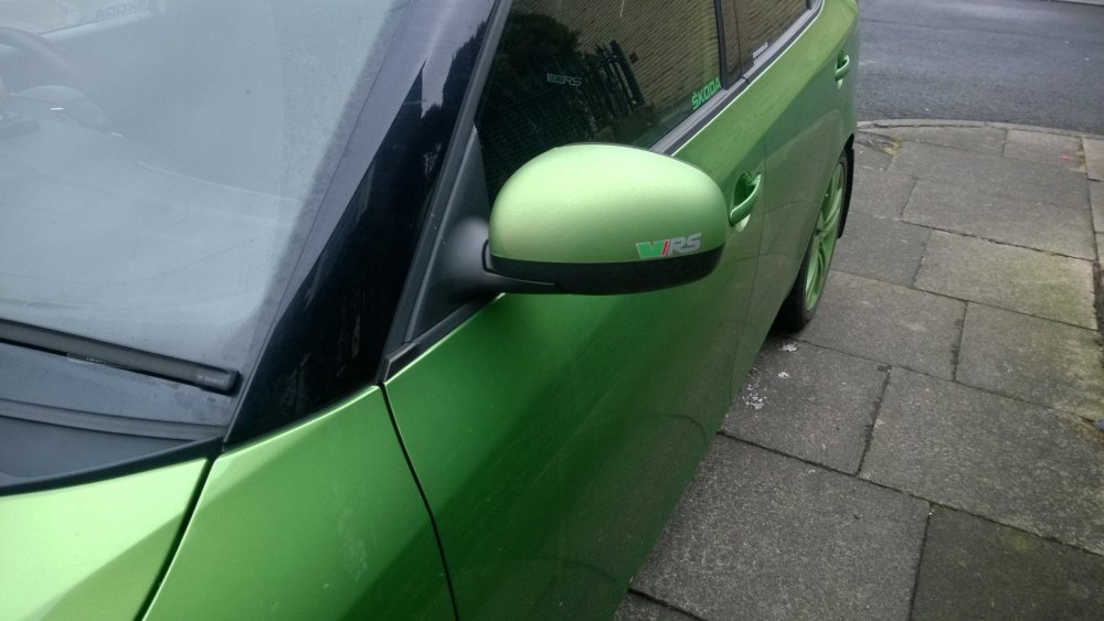

If something happened to the bottom half it would be dealership job for me, i did want to spray this bit but looked to complicated. (Area underneath the VRS Logo on mine?)
Yes that's it mate the black half of the wing mirror I just can't see how to get it off I was able to buy the part so there is a way to get it off I just need pointing in the right direction maybe I need to take the mirror off to see it .
