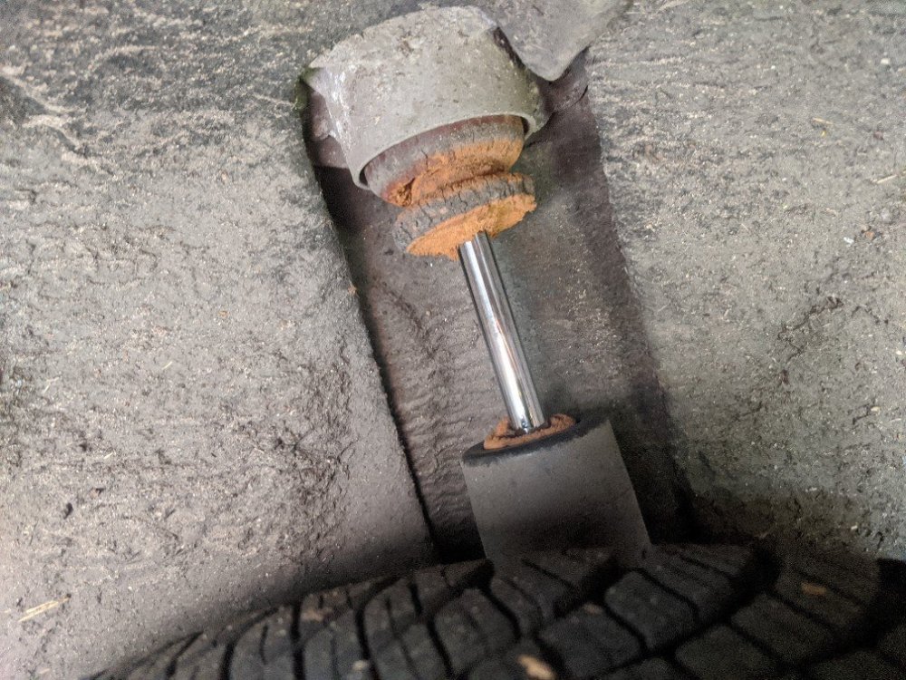

Hi. I've have had this rattle for a few months and in desperation, was about to remove the boot/trunk liner. Just by chance I saw that shock absorber top cover had come away and was free to rattle about. Problem solved! I've secured it with some duct tape which will probably last another 5 years. Hope this helps.
NOOOOO!!!!!!!!!!!!!!!!!!!!
Replace it and the other side, they are cheap and easy to fit, they are the bump stops for your rear suspension, its doing nothing now meaning the springs are overcompressing which will not only mean you will be grounding out when loaded but their life will be significantly reduced, they will either compress making the grounding even worse or the ends of the coils will break off.
They do the above efficiently enough anyway with functioning bump stops.
Oops just seen other posts relating to this. Disregard this one
Check the rear shock dust shields are secured with the rubber bump stop. I’ve had these rattle when the bump stop deteriorates and it rattles in the shock housing.
I have also seen plastic inserts left fitted which are used to reduce suspension movement during transport from the factory. One set had been in place for 20000 miles, they just thought the suspension was hard 😳
