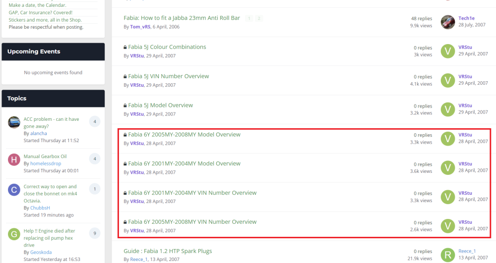

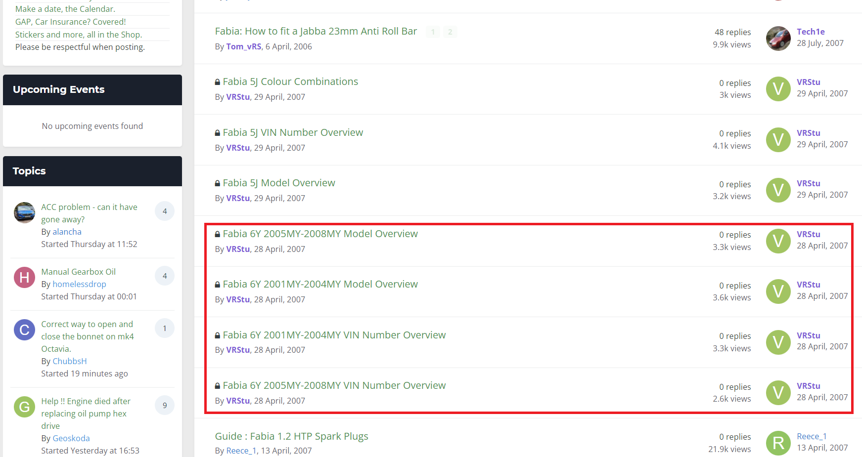

Following a little research on the last page of the Fabia Guides section, it seems Model Year 2005 was probably the start of the use of the new-style (6Y...part numbers) window motor modules, as it started on 2nd August 2004. That fits with the July/August 2004 change info in ETKA.
The last MY2004 car went out of the factory on 31st July; probably with the old style modules.
You can look up your production date from VIN, to within less than a month, using these threads and the pdfs contained.
1749967405_Screenshot2022-01-0917_14_48.thumb.png.da169e050dbbcd892ed0302fa3066c59.png
Tenth digit of your VIN is the Model Year number. 4=2004, 5=2005, obviously.

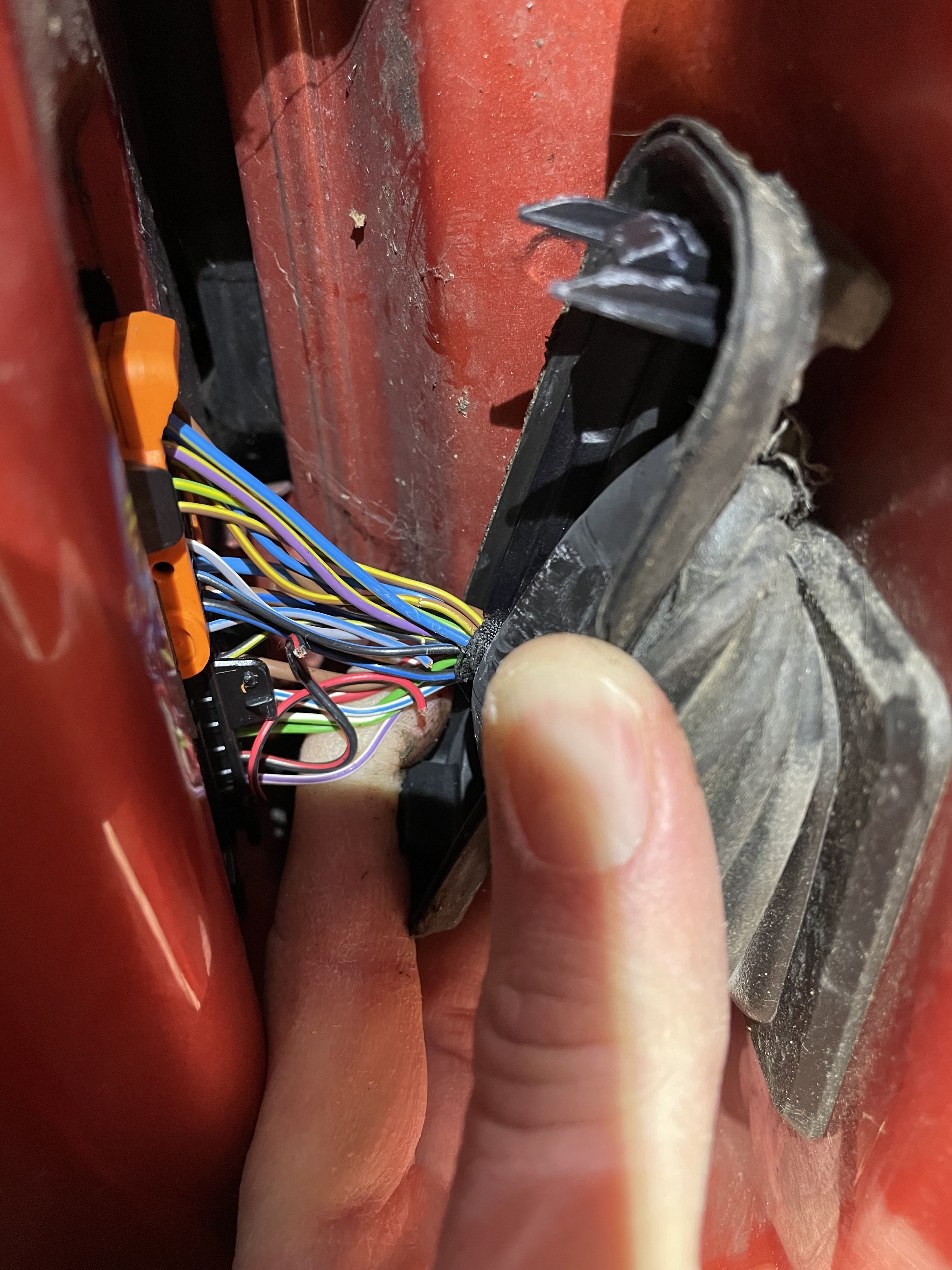

I was having the yearly hoover of the boot, floor mats and toddler carseats this afternoon - took the opportunity to try the key locking/unlocking combos, single and double key combinations, lifting the windows switches and holding etc… nothing changed.
I did inspect the driver side door bellows which looked to be sealed very well, I didn’t open them up to check the connections, would you advise this course of action?
Maybe; the mk2 has an unfortunate design here where the wires go straight across from body to door, so they must bend/straighten every time the door is moved. On the Mk1 there's a vertical dogleg in the boot, so the principal movement of the loom is a twist rather than a bend, which seems to result in far fewer problems.
Intermittent problem makes it less likely to be a broken wire though.
24 minutes ago, sepulchrave said:
Yes, open them up, you won't see broken wires THROUGH the bellows unless you have x-ray specs!
point taken.
and oh my word!!.. I see copper all over the place.
would you guys just patch these up (bit of soldering and heat shrinking) or replace the door loom (if that’s a thing) ?
