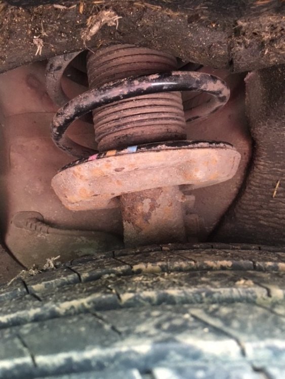

This is what mine looked like when they took it up on the lift for the replacement.

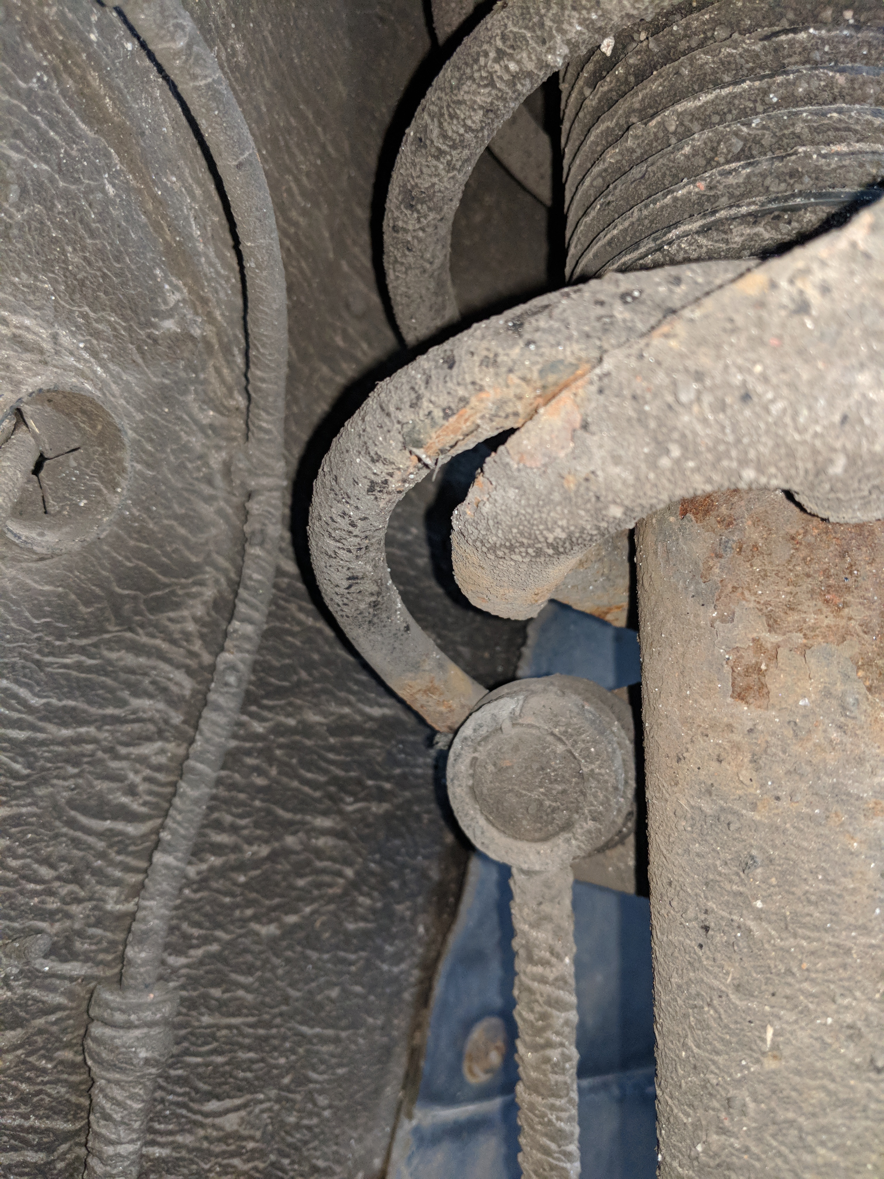

Yes there was a bit sitting in the cup ....jingling every time I went over a bump, managed to get it out ....then it appeared the spring was pearched up on a tiny jagged edge which in the next journey must have broken off ....leaving almost a full spring turn sitting nicely in the cup as per the picture

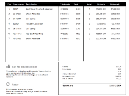

I took the opportunity to do the springs and shocks all around. They were all original and really tired; the car was also sagging in the back... I have attached the bill for parts. (You might need front dust covers too)
Please keep in mind you need to specifically check the thickness of the front shocks. The heavy 2.0 petrol and Diesel have the thicker ones. Do check with them first if you end up buying from them.
I spent the equivalent of 400 British pounds on parts from autodoc. (All Bilstein except stabilisers and covers which are Monroe)
Another 130 pounds in labour to a very cheap independent. Pretty easy job ☺️. Good luck!
I'm happy with the parts so far... Can't feel difference from OEM.
