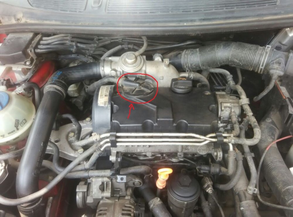

I need a help on a oil leak issue that i am facing with Skoda Fabia 1.4 TDI 2008
After i drive for about 50-60 kms, i can see a oil leak from my oil dipstick. The oil is present all the way to the top of the dispstick and is also
spilled inside the engine cabin, from the dipstick. After i noticed the issue i have only driven the car for about 200 miles and the oil loss seems to be low.
the total mileage on the car is 60000 miles.
also, there is considerable blowby from the dipstick.
After reading through different forums, i see that its most likely caused by either  a bad CCV or worn out rings.
Before i get the work done on the piston rings , i just want to make sure that CCV is not the problem .  Could you guys please help me to locate the CCV on
the 1.4 TDI engine. I have attached a pic here , please tell me if what i have marked is correct.

Blocked crankcase ventilation system could cause problems like this, so check that it isn't blocked.
I believe your photo correctly identifies one end.

There's a photo (8th one) in this listing that shows a view of the inside of the cover.  The valve appears to be integrated into the cover.  Should be easy enough to check the hose anyway, just detach from both ends and check for blockage.
Edited by Wino
Thanks, Thats the first check i will do.
