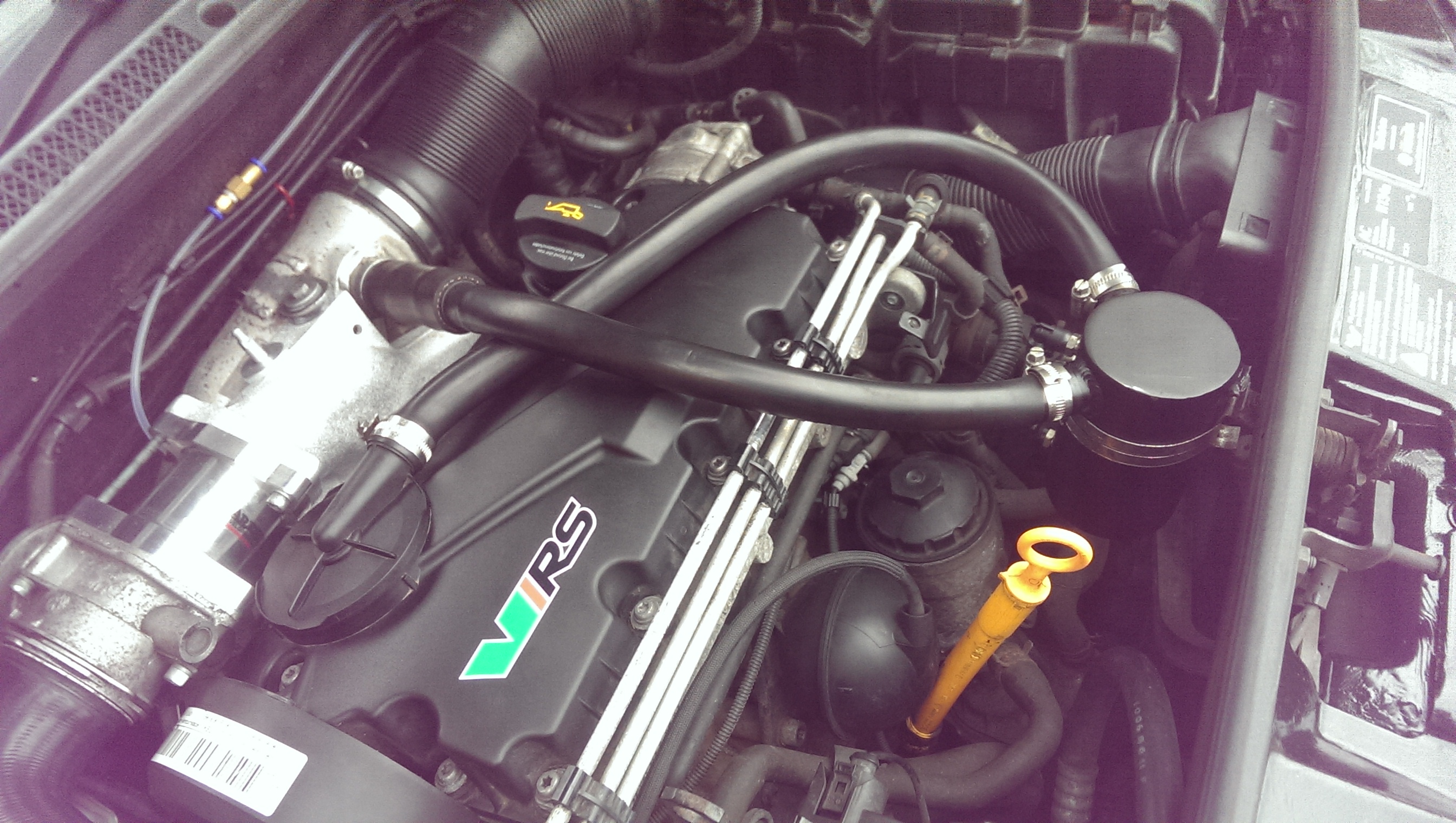

I have an EBay special can, does the job. I have far less oil in the intake piping now. Also worth using oil resistant tubing, I found that the oil seems to sweat through silicone tubes.
Here's mine.

just dont do it, darkside developments did some testing on catch cans on PD engines and confirmed there was high crank case pressure as a result, as standard setup the turbo sucks the vapours out.
Youve got to remember the tandem pump vents into the crank case so you've got that extra pressure as well. I'd leave it standard or just vent to ground to reduce restriction

The issue is that the turbo is what pulls the vapours out the crankcase, no catch can is able to do this hence why the vapours can build up in the crankcase and potentially blow a seal or even cause issues with the oil to the turbo if it cant drain correctly (in extreme cases)
@JWvrs25 surely this would only be an issue with a can that vents to atmosphere? Most cans are designed as a sealed system that goes in line with PCV tube and just remove the oil vapour while still allowing the turbo to pull a vacuum through the can.
Youve got all the pipework to the catchcan, then through the can itself and back through another set of pipework to the intake. Thats a big restriction and plus your still putting those hot gases back into the intake minus a small amount of oil, just as well leave it standard and allow the car to suck in the oil which does no harm if your egr valve is disabled.
