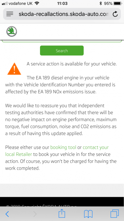

Hi
does this confirm mine has not been done ??? Just typed Vin number in (out of pic) and this what came back.
cheers
Yes. That means it hasn't been done.

7 hours ago, Snapper1725 said:
Hi
cheers
Doesn't mean much, they might not have updated their systems.
To confirm if it's been done, look for a 23r7 sticker in the boot area or to be extra sure, have the car scanned by VCDS or similar and check the ECU software version.
