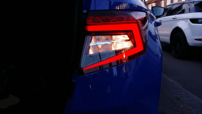

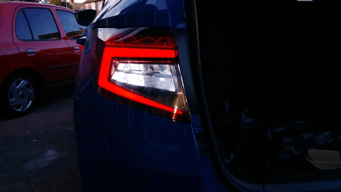

Here's some quick shots, before and after with both reverse and indicators on.

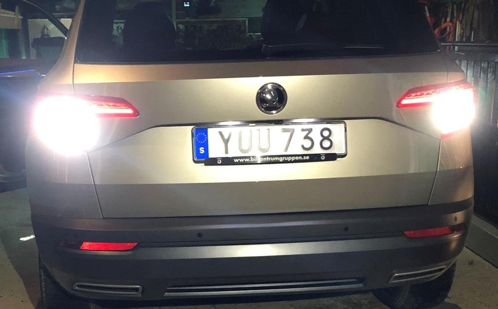

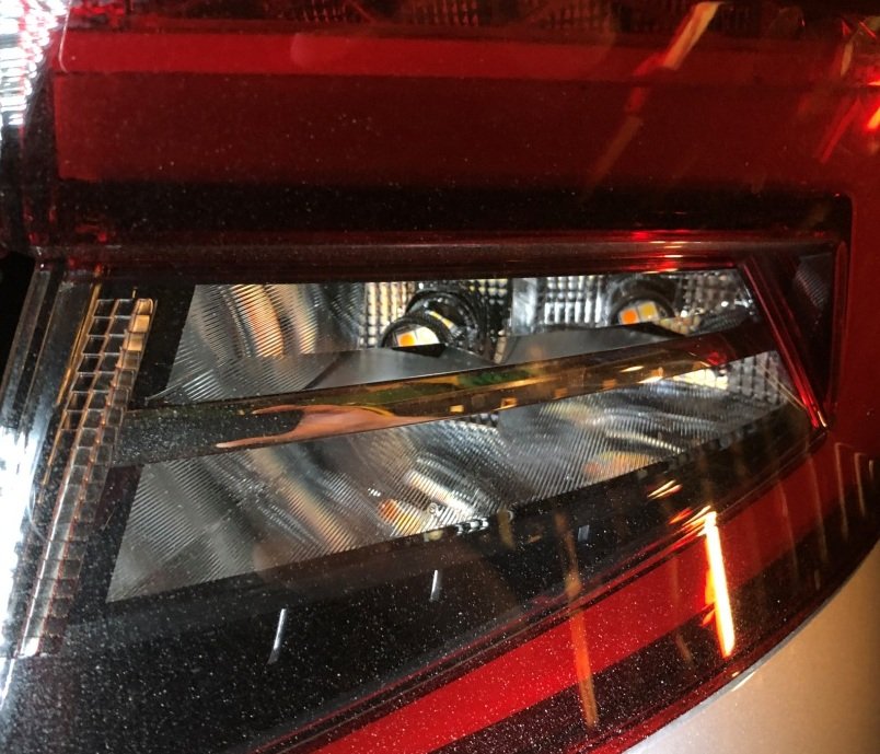

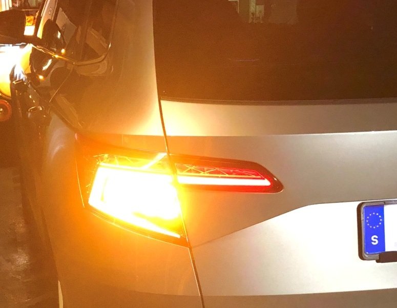

I´ve gone a step further on my Karoq rear lamps.
I found dual-color lamps in China, yellow and white. Both LED-groups on the lamps was found to be high power with very bright and nice output
but the lamp sockets is to big (W20) to fit in the W16 sockets, so I needed to rebuild them. At the same time I eliminated a time delay for about 1 sec for the
white LED:s at start. Not that this is crucial for the reverse lamps, but I choosed to replace the switching electronic LED drivers for both LED-groups with an ordinary
power resistor, this way I also get rid of the radio disturbance that most of these chinese lamps generate.
I rebuild four dual-color LED-lamps  this way and placed on the original turn and reverse sockets, and the result is brilliant, very bright and distinct light on both functions,
and it looks very good when the complete white parts of the rear lamps are used to both the yellow and white lamp functions.
I will try to put together some pics and show later on.
