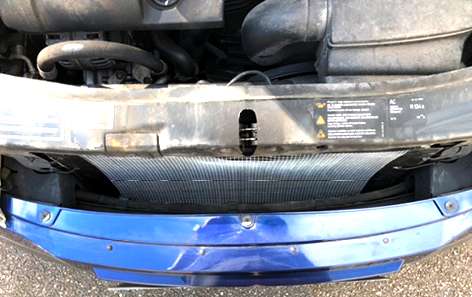

    Hi David,   I saw some mesh in B&Q, I think its aluminium and all I did was drill holes in the slats and cable tied it to them, top and bottom, had to leave a gap for the bonnet release,

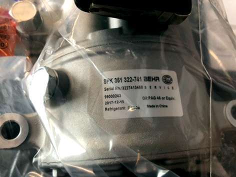

So, the Occy is in for a new compressor! The garage is mowed out but at worst it will be Wednesday before I get it back.
I quite liked the auto electrician and was happy with his diagnosis - paid £60 cash. He was using VCDS and I couldn't get close enough to see the detail on his laptop but he did talk through what he was doing. He confirmed that there were no diagnostic codes (as we thought from looking at the onboard diagnostics from HVAC) and that pressures were right. Next he plugged a device into the pulse-wave output of HVAC to the compressor solenoid valve and that showed the valve was receiving signals okay. He did a bit of twiddling the Climatronic controls whilst checking VCDS output and ruled out fan, condenser, expansion valve and evaporator. No temperature difference was evident between the input and output of the compressor so he said "its either the 'internal clutch' or the solenoid valve, either way on a 2007 compressor, you need a new compressor".
The garage estimates 1.8 hours labour and got a price for a Hella compressor BFK-351-322-741 at £186.84+vat. Compressor was delivered while I was waiting for a taxi so I'm not complaining if that sorts me out :)

Hi Trev, no time like the present. It's surprising how vulnerable the condenser is when you think about it so I got 2' x 1'6" galv mesh (1/4" holes) and I've tied it in front of the condenser. I tied it into the bottom of the grill with cable ties (you can't see them) so it stands away from the condenser quite a bit at the bottom. Not much I could do at the top other than thick tape on the sides to stop chafing and tie in with cable ties.
Hi David,
I saw some mesh in B&Q, I think its aluminium and all I did was drill holes in the slats and cable tied it to them, top and bottom, had to leave a gap for the bonnet release, but he ho is stopped the stones.

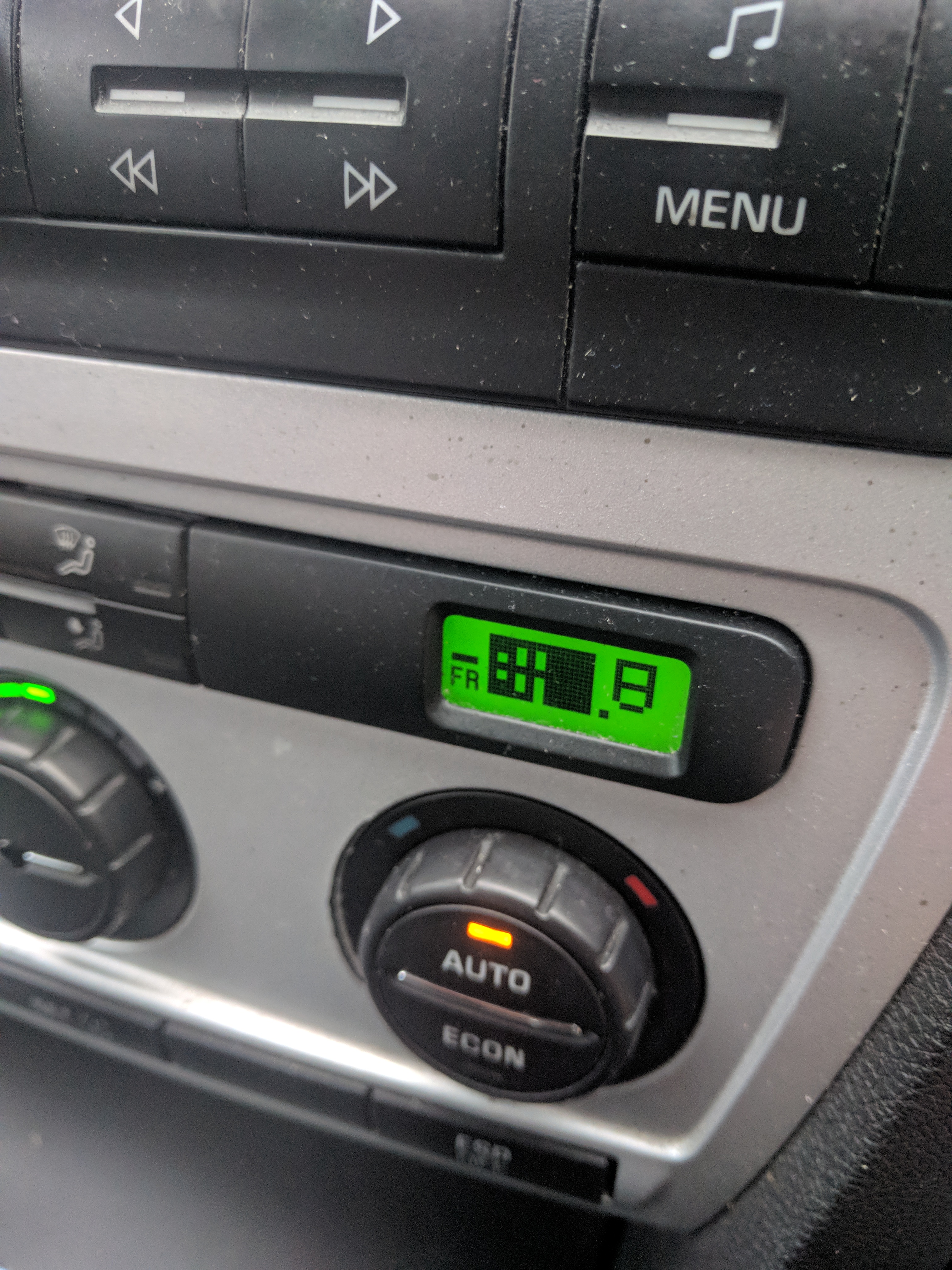

 I attempted to put I ggtrhfth
My attempt to put the aircon into debug mode didn't go well
That looks normal once it’s finished recalibration or at least what I was getting.
