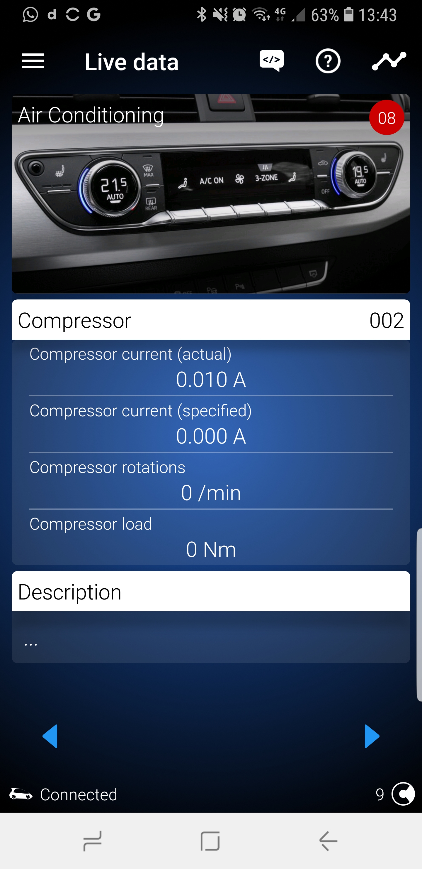

@Aston_Bodger Ok, hopefully i'm not hijacking this thread, but I've just done the test, and it shows a shutoff code of 00. HOWEVER...Kwik-Fit evacuated the system after the compressor refused to "kick in" so surely I should have code 03? No pressure?

How many milliamps is the compressor drawing?
Looks an interesting screenshot - what app are you using?
I'm no expert, I did my code checking using the HVAC onboard facilities which are okay but you've probably got easier access with the app. To do it the slow way:-  have engine running - press screen blower and ECO simultaneously, then use left hand temp control to select the HVAC register group and the blower control to select the register within the group. The codes are displayed above the right hand temp control.
The compressor is only drawing 10mA (max is 82mA) so my guess is that this is fine if the HVAC has turned off the compressor. I presume the 002 is your compressor status code, which as I understand it means the HVAC has turned the compressor off because of an issue with the blower motor circuit.

Its interesting that you're not seeing any compressor rpm. As your compressor isn't kicking in (according to KW) and it's not showing an error code suggests to me that the HVAC is turning everything off for some reason.
Not sure that helps much!
Ha, Thanks.
I'll keep digging, am I right in thinking that the compressor IS kicking in by that readout?
The compressor should be drawing 50-70mA if its actively cooling normally. Mine was drawing about the same as the max (82mA) when it was broken. Yours drawing 10mA sounds like the HVAC doesn't want the compressor to do any work. You've not got a compressor error code so my guess is that the HVAC thinks the system is cool enough but isn't aware there's a problem.

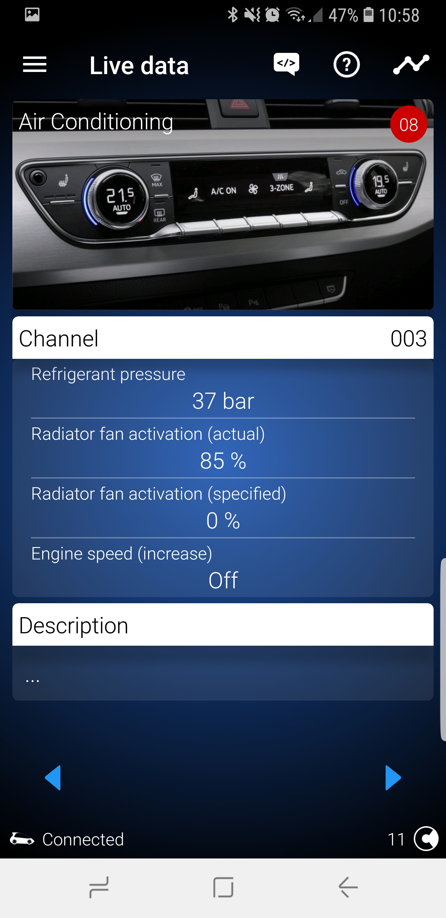

I'd have a look at what actual temperatures its picking up; perhaps a sensor thinks you're in the arctic already?  Also two items in HVAC group 10 registers might be helpful...
10-0 Evaporator temp - If the system was running normally this should be below 10C
10-1 Liquid refrigerant pressure - if the system was running normally this should be something like 8 to 12 bar I'd say.
Good luck!
Cheers.
At work at the moment, but I do remember a pressure showing 37?

Takeit then that these are way off. The reason the 10.1 figure pressure is blur is Because it was going mad, jumping between 32 and 37.

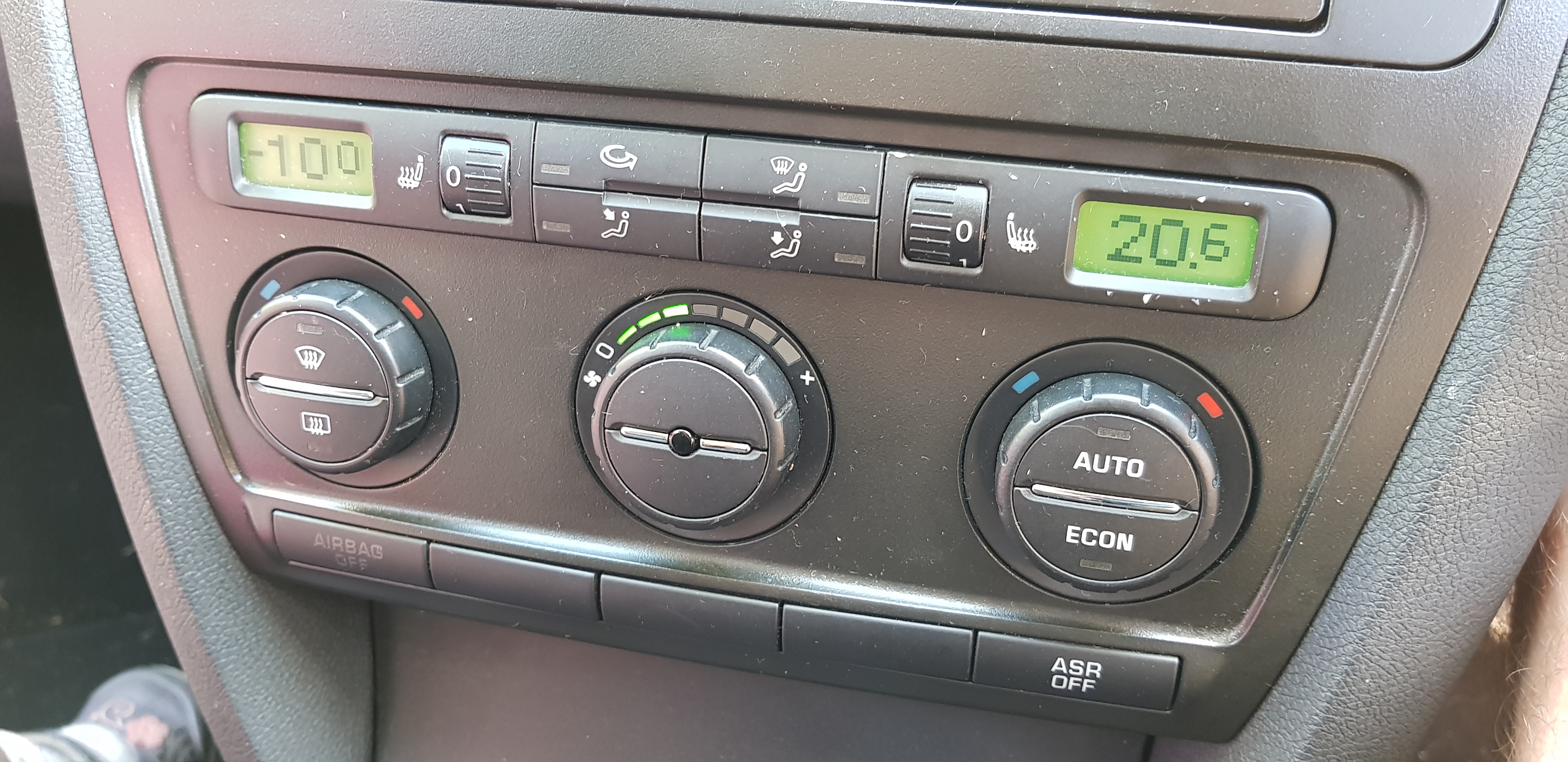

the coolant temp was 17 when I opened the car and has shot to 20.620180622_112811.thumb.jpg.721ac00d3811ca95a7ff2b574bb21f92.jpg

Oh right. Is 30+ too high though? Meaning its naffed? If it I'll dive in and replace compressor, condenser and drier pack then.
On that would there be an appetite for a guide, which could possibly be a sticky? Haven't seen one floating .
It may be getting wrong info from the pressure sensor, it's got a bunch of electronics in, so its not like a normal one.
May be worth finding someone with VDCS just to confirm the pressure, as I said I don't use the "onboard" system.

Right, by scanning it and not on board diagnosis I'm getting 37 bar, I'm going to change the high pressure sensor first and see where that takes me, the system is empty so shouldn't be anywhere near 37bar. Correct?
Edited by GizmoThor8303
If the system is empty as you say, then it should be a big fat 0000 Bar, something is amiss there, change the pressure switch and go from there, that's what I would do.
37 Bar with nothing in sounds a bit funny to me too.
Trev
