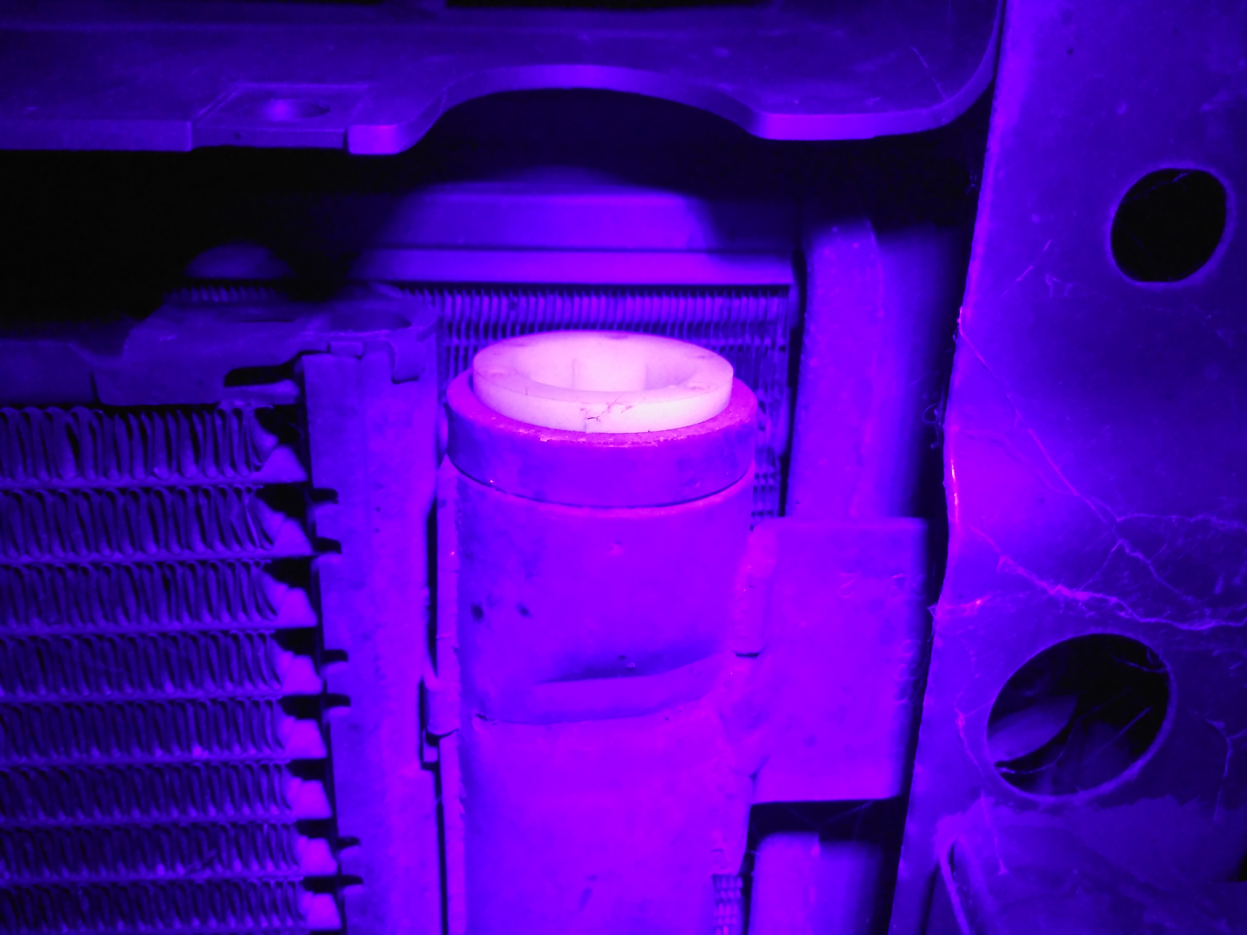

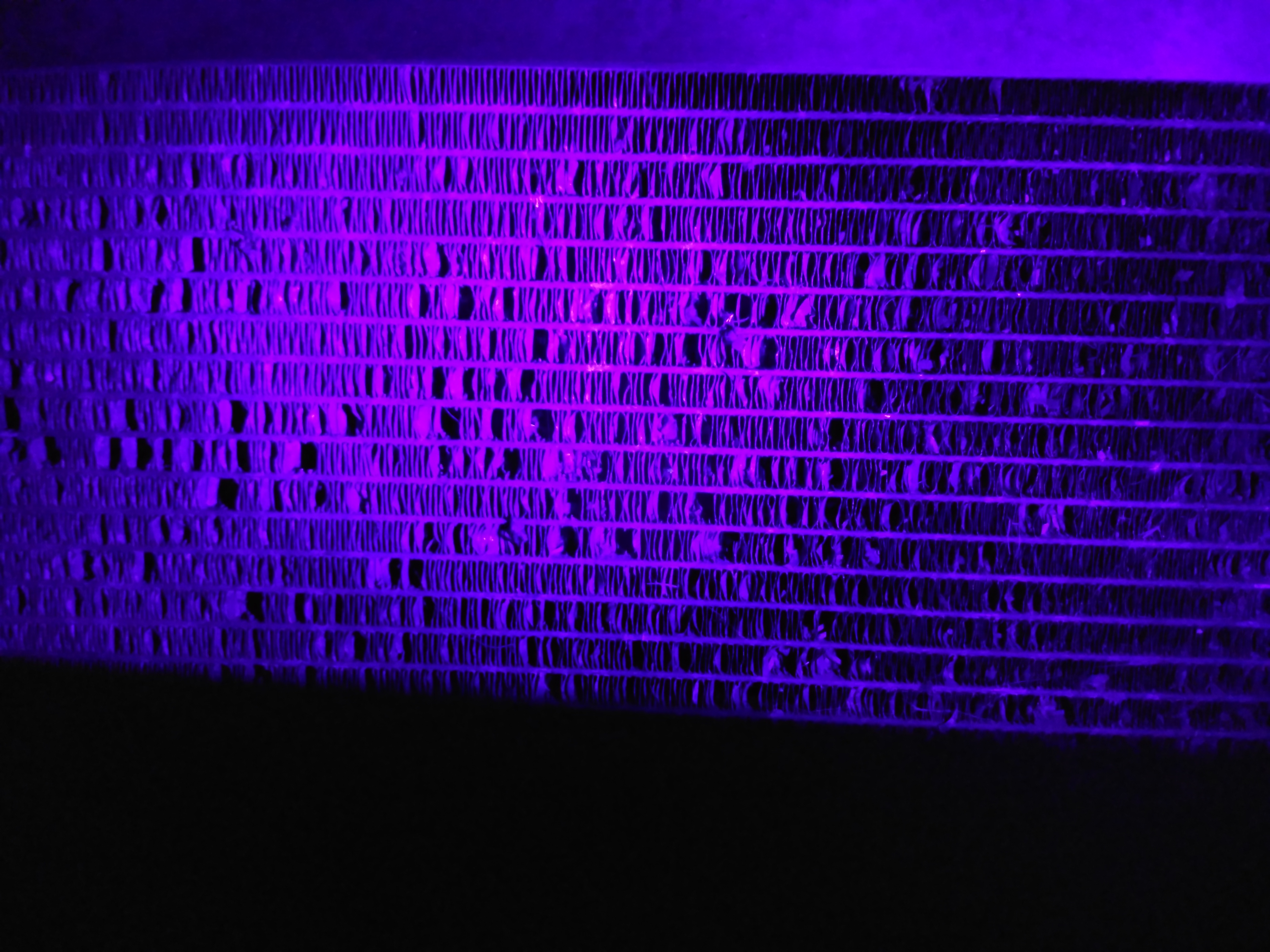

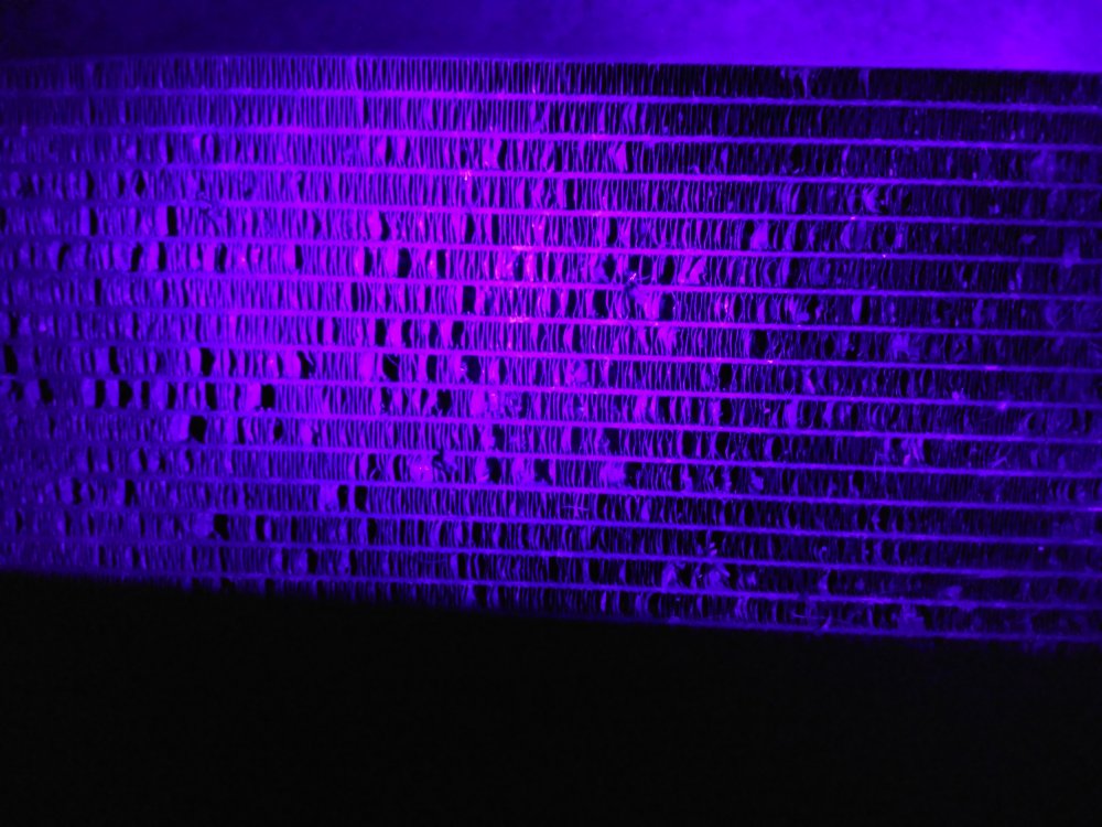

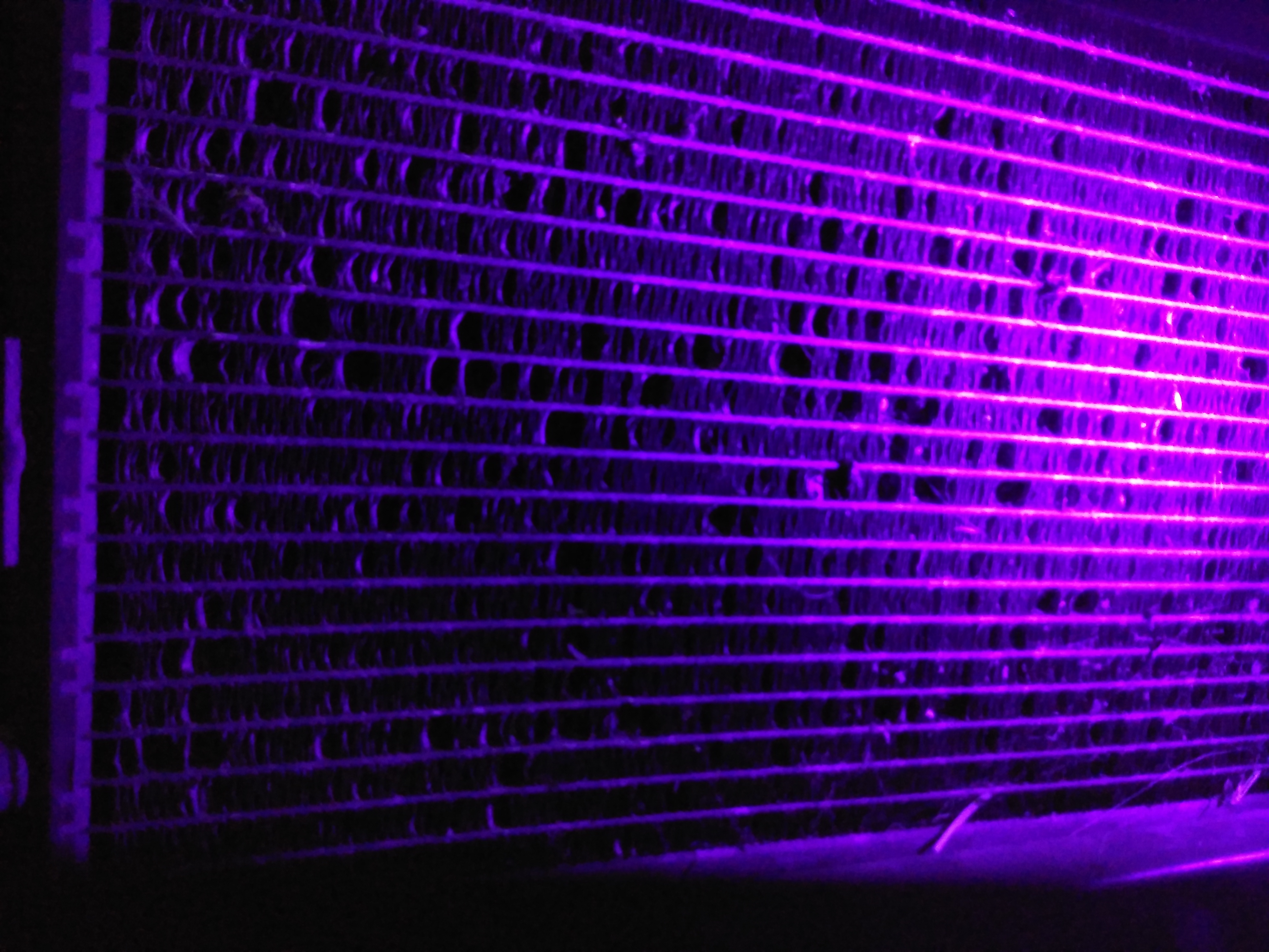

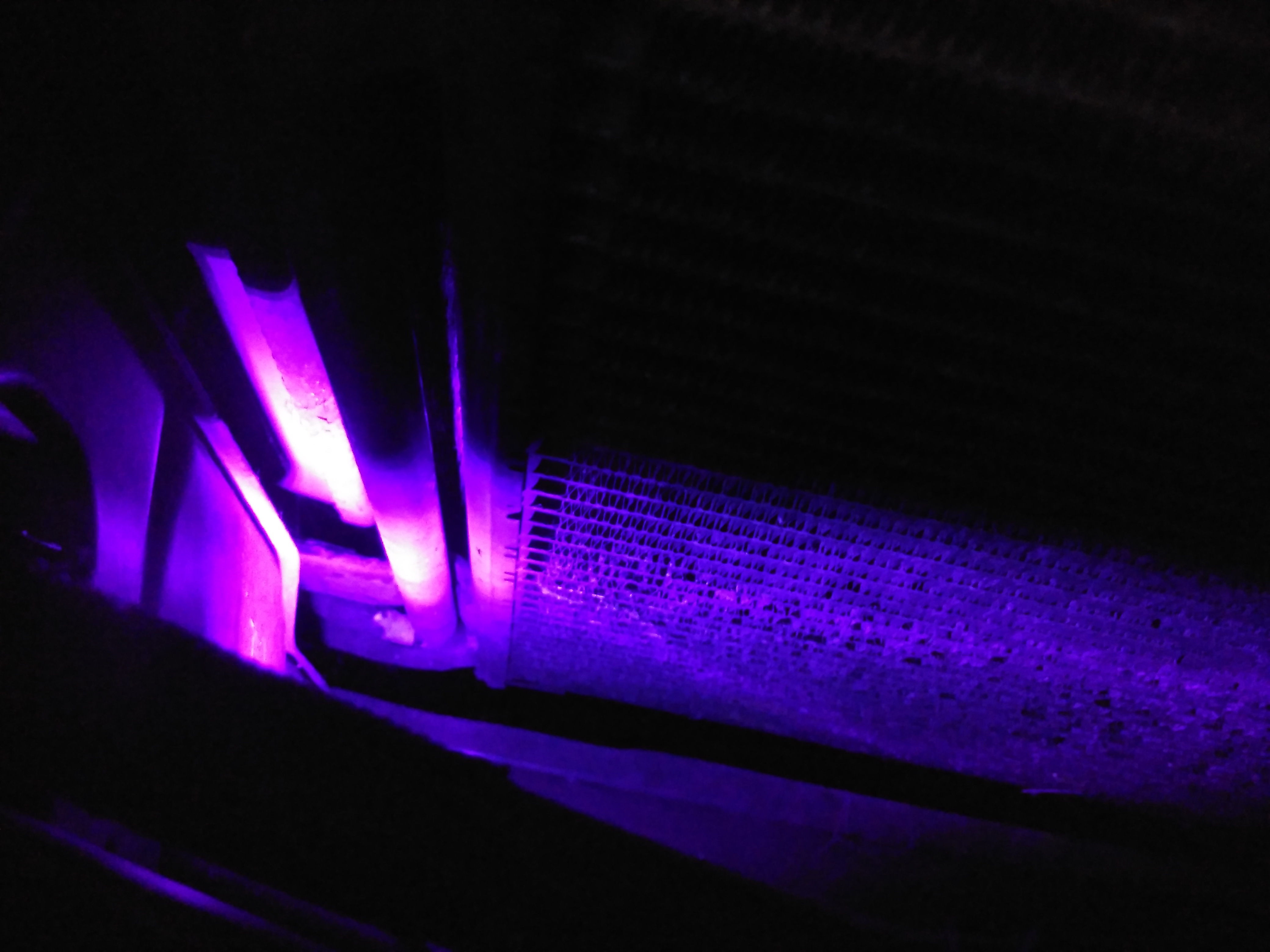

Hi all
I like to double check the diagnosis of the condenser leaking at the bottom rear. So I bought a uv torch and had a look this evening.
I can't seem to see green fluorescent dye anywhere. Also I wonder how could they have seen the back of the condenser without taking the tray off and maybe the water radiator.
I could be wrong and just worrying, but is it the condenser or is it the most likely thing to leak and they just say it is that to change.
I took some pictures hopefully they attached. These are the front of the condenser through the grill with a uv torch.
14 hours ago, raf300 said:
Hi all
Although your condensor shows some damage from debris, I don't see any dye.
did you check the top of the dryer as well? The plastic nut is a known issue (Mine was leaking there as well)
On my (2005) LHD its located at the top, right side of the condenser (Check from above)

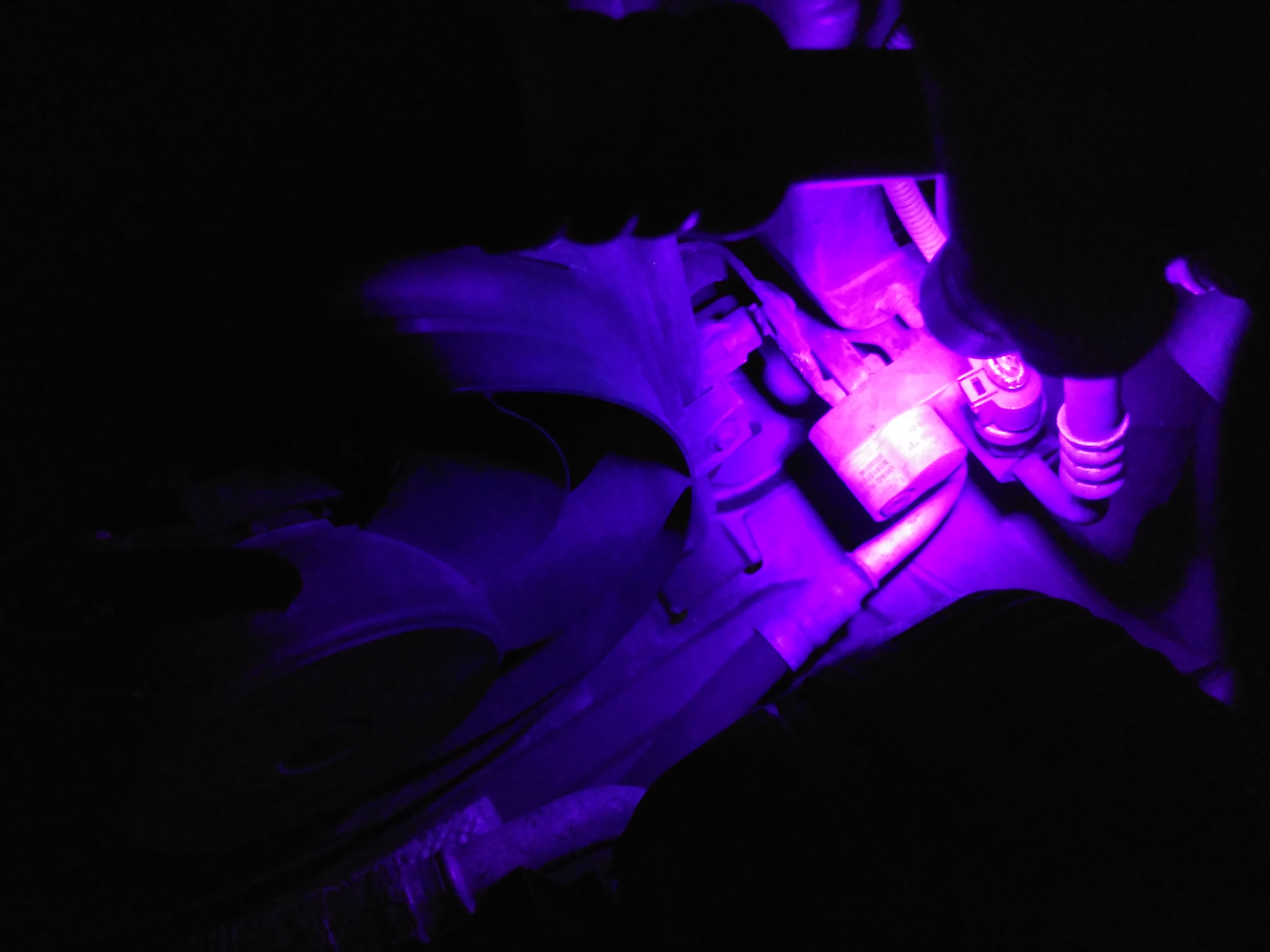

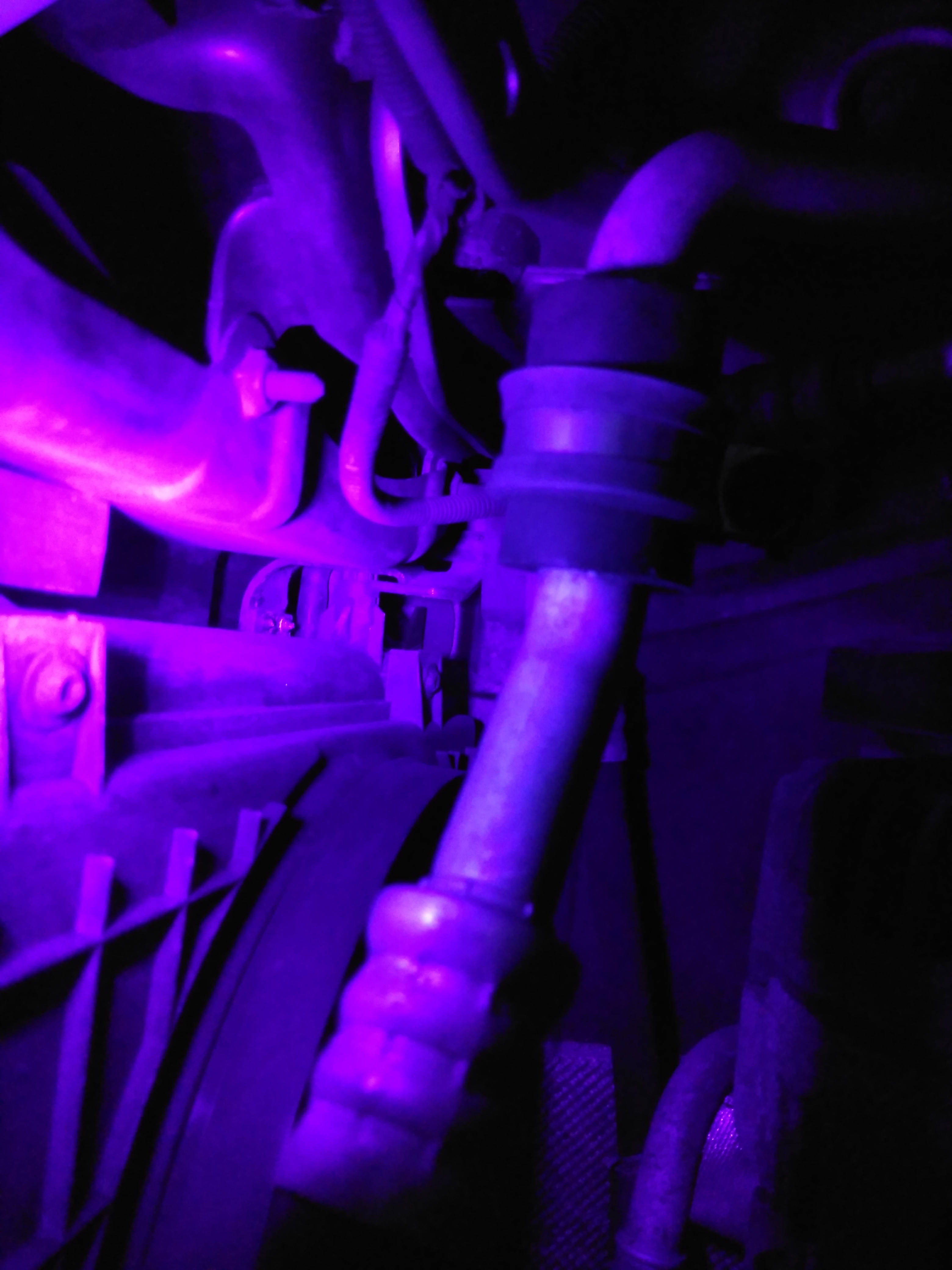

Have you checked the connections at the bottom left corner as you look at it?, it may be there, they would see it there without taking anything off.
Trev
I will check tonight and report back. I did have a good look and couldn't see any dye but will check again.  Cheers
I had another look, checking the connectors on the left and the white plastic nut (top right).
Couldn't see any dye. Photos attached below.
To check the compressor do I need to take undertray off? Everything visible from top I haven't seen any dye.
I forgot to add when I had it regassed it was working. By day 4 you could here the system gargle (howling wind) which suggested air in the system.
By day 7 air con not working, so assume most of the gas gone.
@raf300 Looks like to me you have dye around the top of the plug for the pressure switch, only a little, but it might be enough?
I could be wrong?
You don't need to take the under tray off to see the compressor connection, they are on top.
Trev
I could be wrong?
Trev
Trev, that might be a good spot. I assume you mean picture 1 in my post above?
I will check again tonight. If your right I owe you a drink.
What will annoy me is I told the garage when they took the car back in, check around the pressure switch and trv as these are common areas to fail according to briskoda forum. I also wrote that on paper and gave it to them.
I am hoping it could be that as may be a cheap fix, and if it works I better also make a mesh grill to protect that condenser too.
Edited by raf300
@raf300 Yeah, that's the one, perhaps they just had a quick look around with the UV light, I don't know.
It means taking the pressure switch out, just be aware someone on this tread is changing the pipe that it fits due to corrosion in the switch and he snapped it off, hence the new pipe.
You will need a 17mm crowfoot and a longish extension, its got a car tyre type valve in so you wont loose any pressure if any in there.
