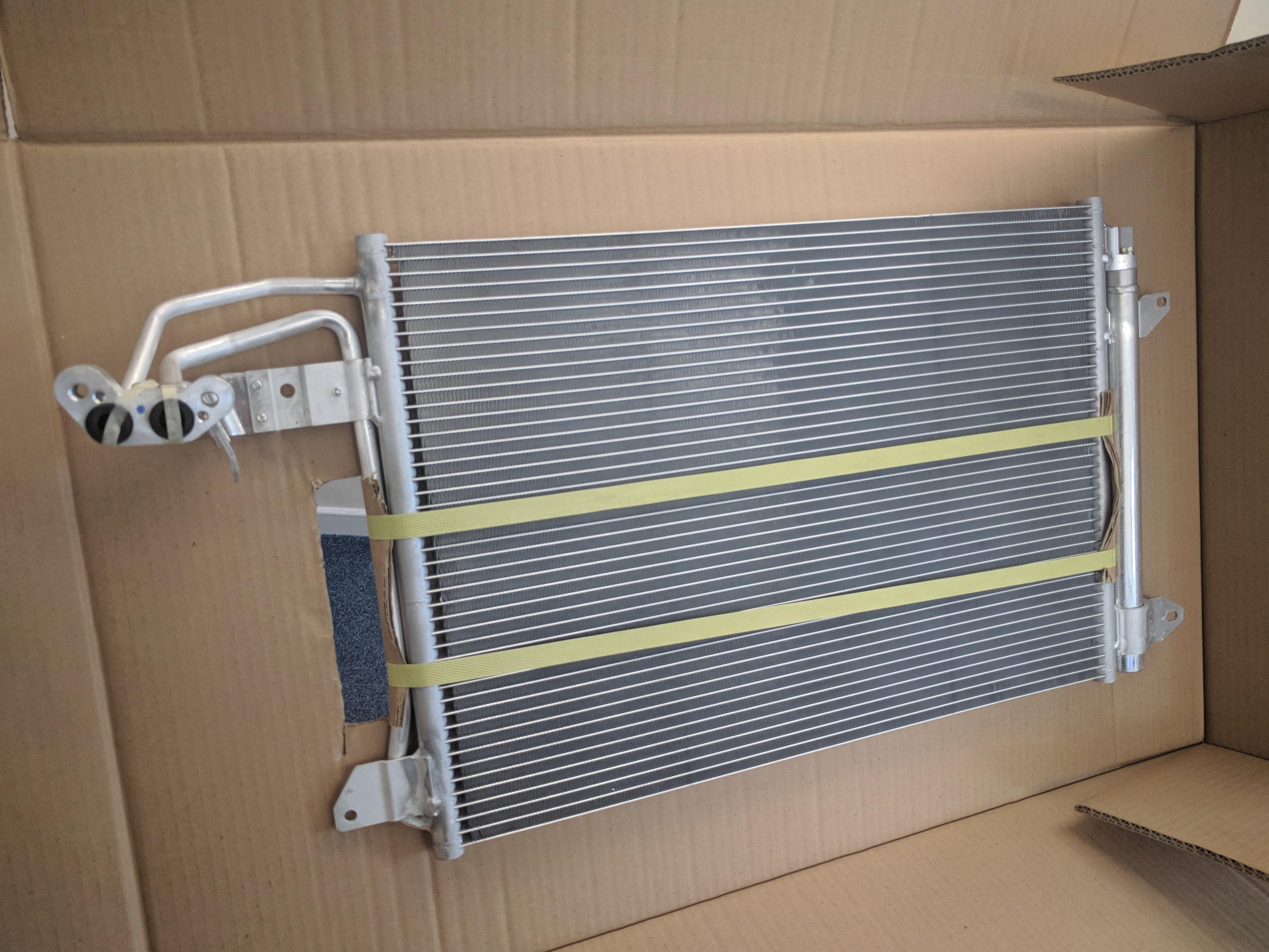

But looks like I'll also need a new aircon rad.

So, looks like your condenser has had it?,  you can DIY takes about 3-4 hours, as all the front end has to come off.
Trev

parts are in! just need to find a time to fit them now.

if you have a photo og where the bumper mounting screws are that should speed me up no end
I'm sorry but I did not take photos, wanted it done quick as I needed the car in about 4 hours, hope this helps.
There are a row at the front X3 when you open the bonnet, then there is 1 each side near the front of the front wheels, they don't need to come off, then there is 3X plastic rivet things underneath, take the middle out and pull the rest, 4X plastic rivets under headlights, then there is 2X bolts under the grilles near the towing eye and opposite side, take all them out and disconnect the fog lights and the bumper is off.
Then take the crash structure off, tie up the rad, cos you need to take the slam panel off after disconnecting the bonnet cable at the joint.
The condenser can be a pig, you have to waggle it DO NOT USE ANYTHING SHARP like a screwdriver to separate, you need a flat surface otherwise it wont seal properly despite seals on pipes.
Hope this helps.
Trev
