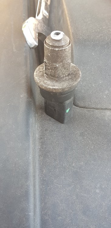

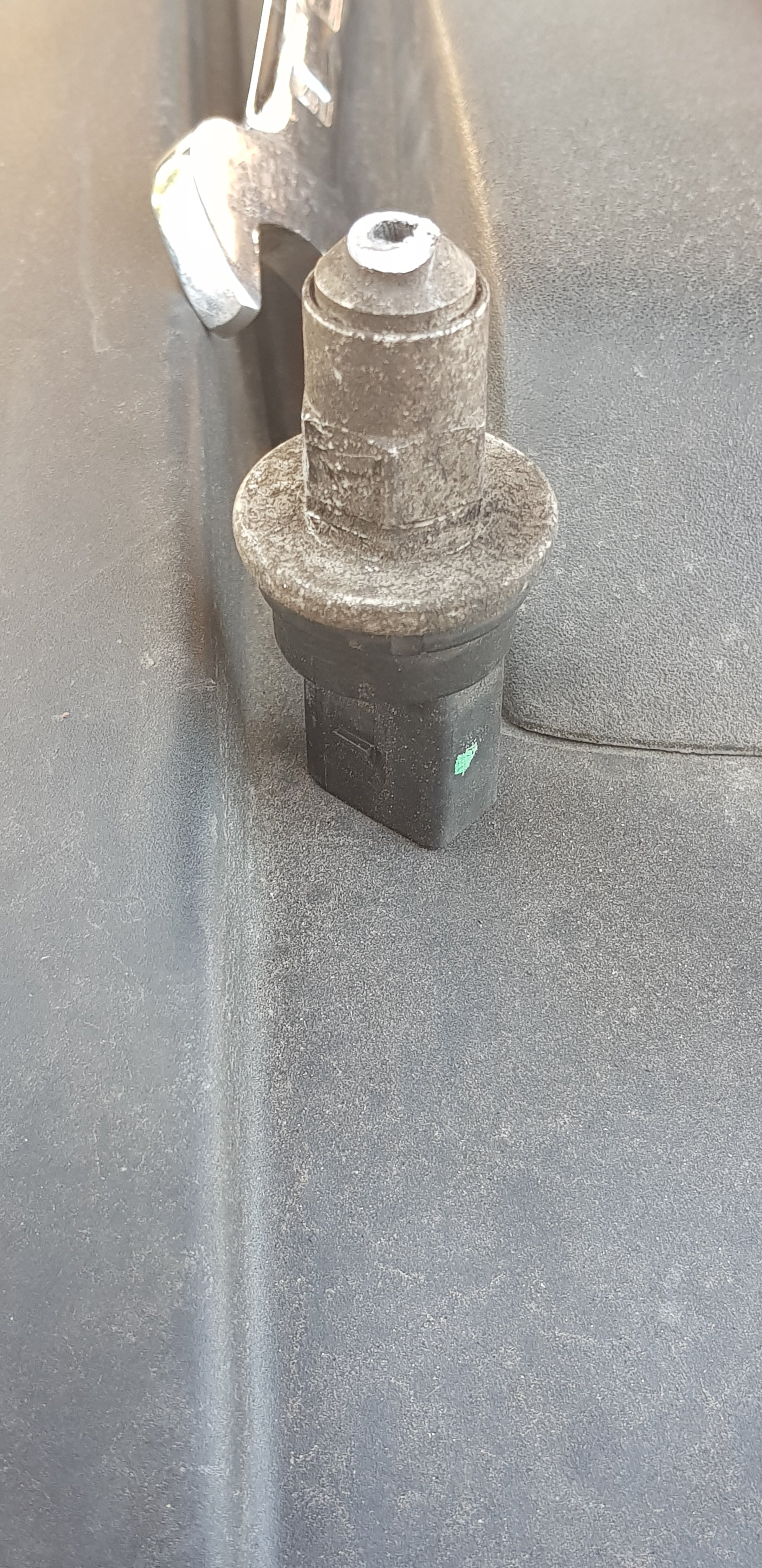

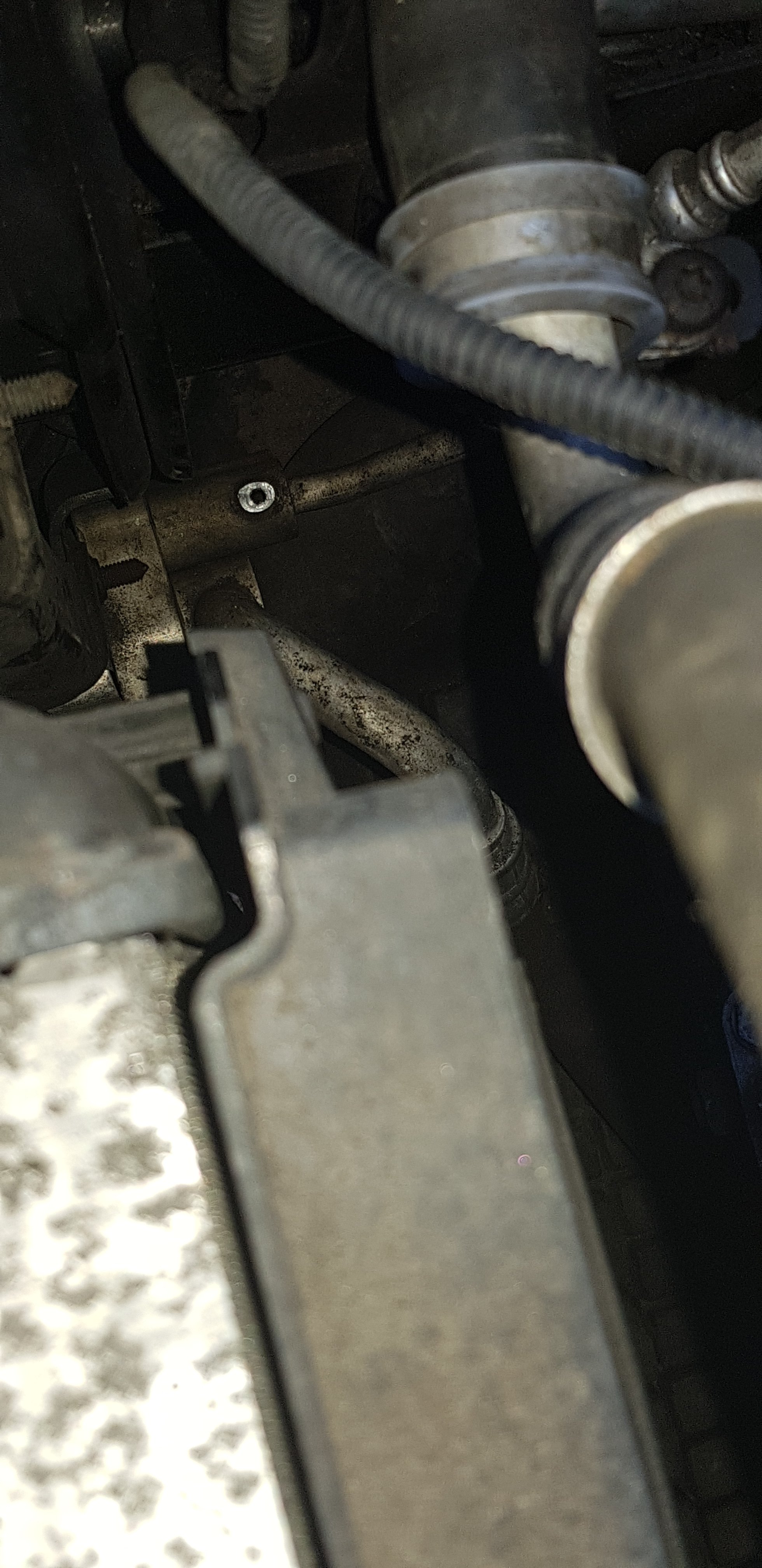

the money pit strikes again, just tried to take off the pressure sensor and this happened.
please someone tell me that I can replace the part where it has sheared off instead of the whole system?
nightmare!
but i think depending on where in the line it is, it should be repairable.
the only issue i could possibly see is if it is a line that goes into the cockpit then it becomes a very big job.

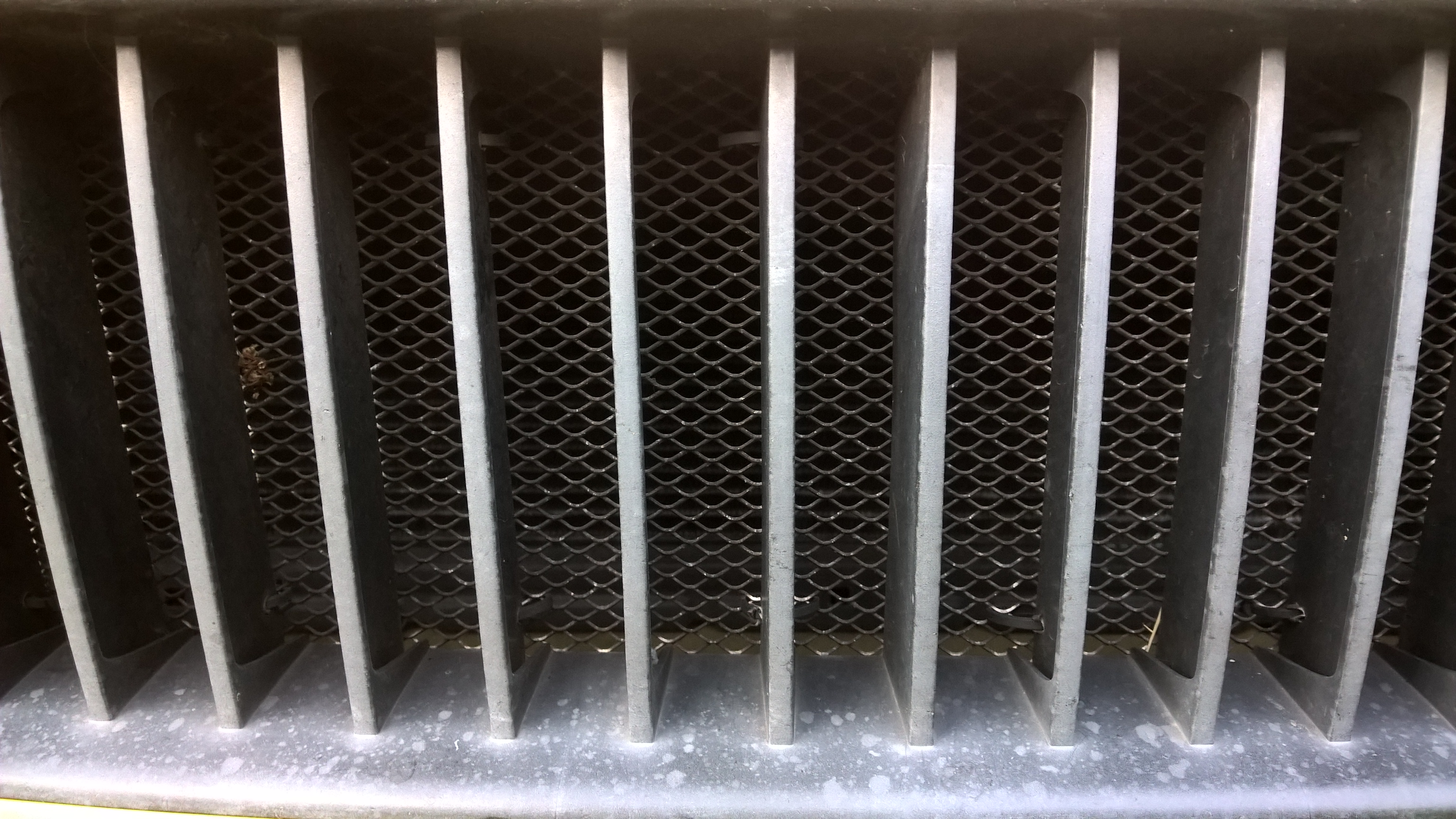

also, off topic mr bodger, got any details or photos of your mesh?

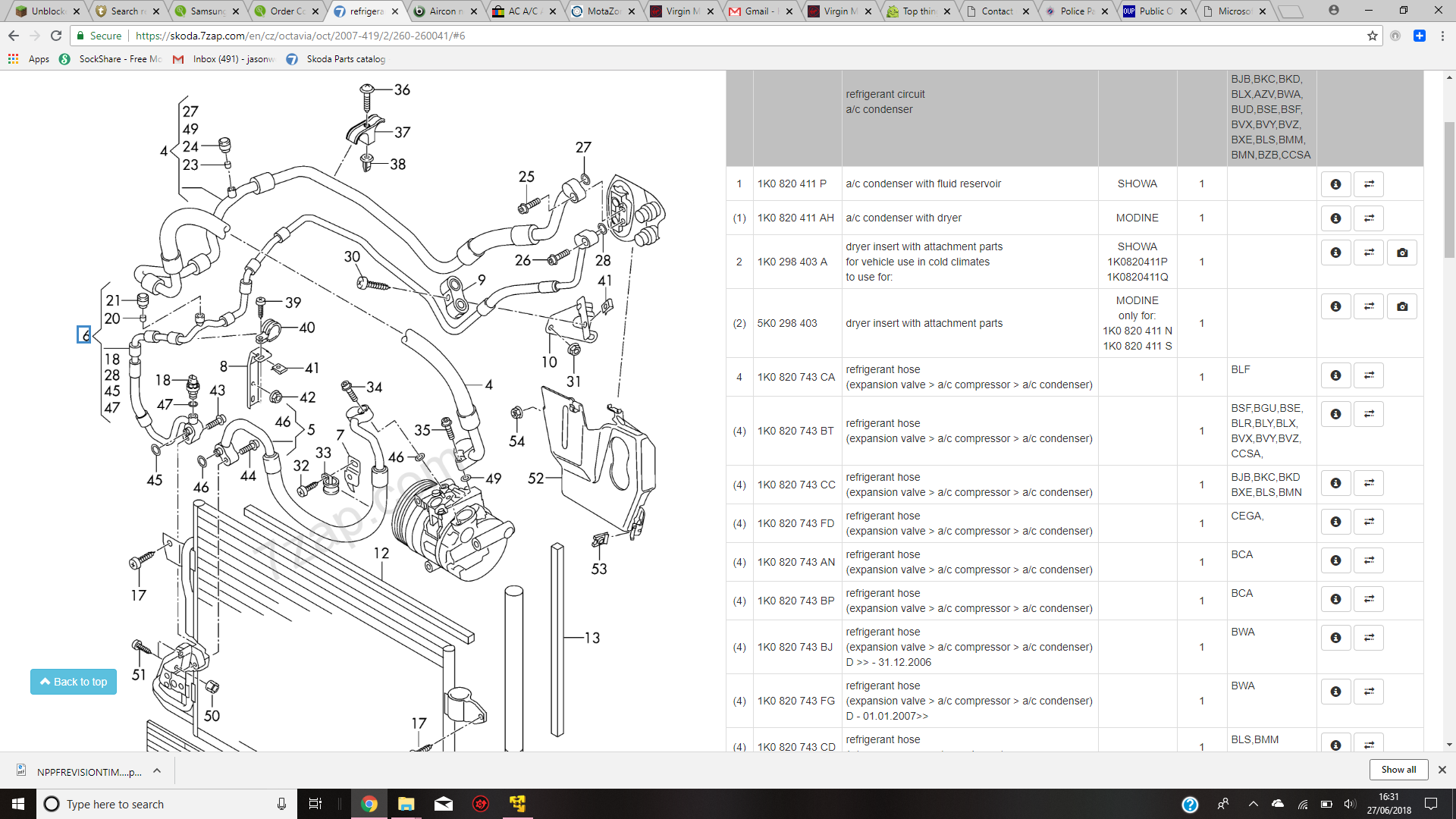

I believe its item 6 here image.thumb.png.6418f65dd08379b144ee56a05cd5b690.png
i got my new AC rad fitted but obviously want to make sure it doesnt happen again.
That's a bit of a bugger!!, to say the least, you are looking at a new pipe and they are not cheap, you might get one from a scrappy?, its not repairable, sorry, even a good ali welder would struggle with that TBH, give me a moment and will take a photo of my mesh, I got it from B+Q years ago, just drilled small holes in the slats for cable ties, and had to leave the slat open for the bonnet release handle to come though.
The pipe looks like it's from the condenser to the evaporator connection on the bulk head, have you got a vw parts place near you, can't think of the name now, they might be cheaper than a main stealer, unless you have a tame one that gives discount?
Trev
Back in 2015 a number of us followed the advice of a fellow Briskodian and fitted the mesh shown below, me included.
When I looked at the front of the condenser it was clear it had been hit by road debris many times. The shelf below formed by the bumper had small lumps of concrete on it!
Many of the people using this mesh were those who were protecting their new replacement condenser.
I used small black tie wraps 4 inch long. Do a search on here and you should find photos and "how I did it" tales.
The mesh is item 290840516115 on eBay.co.uk and is still available.

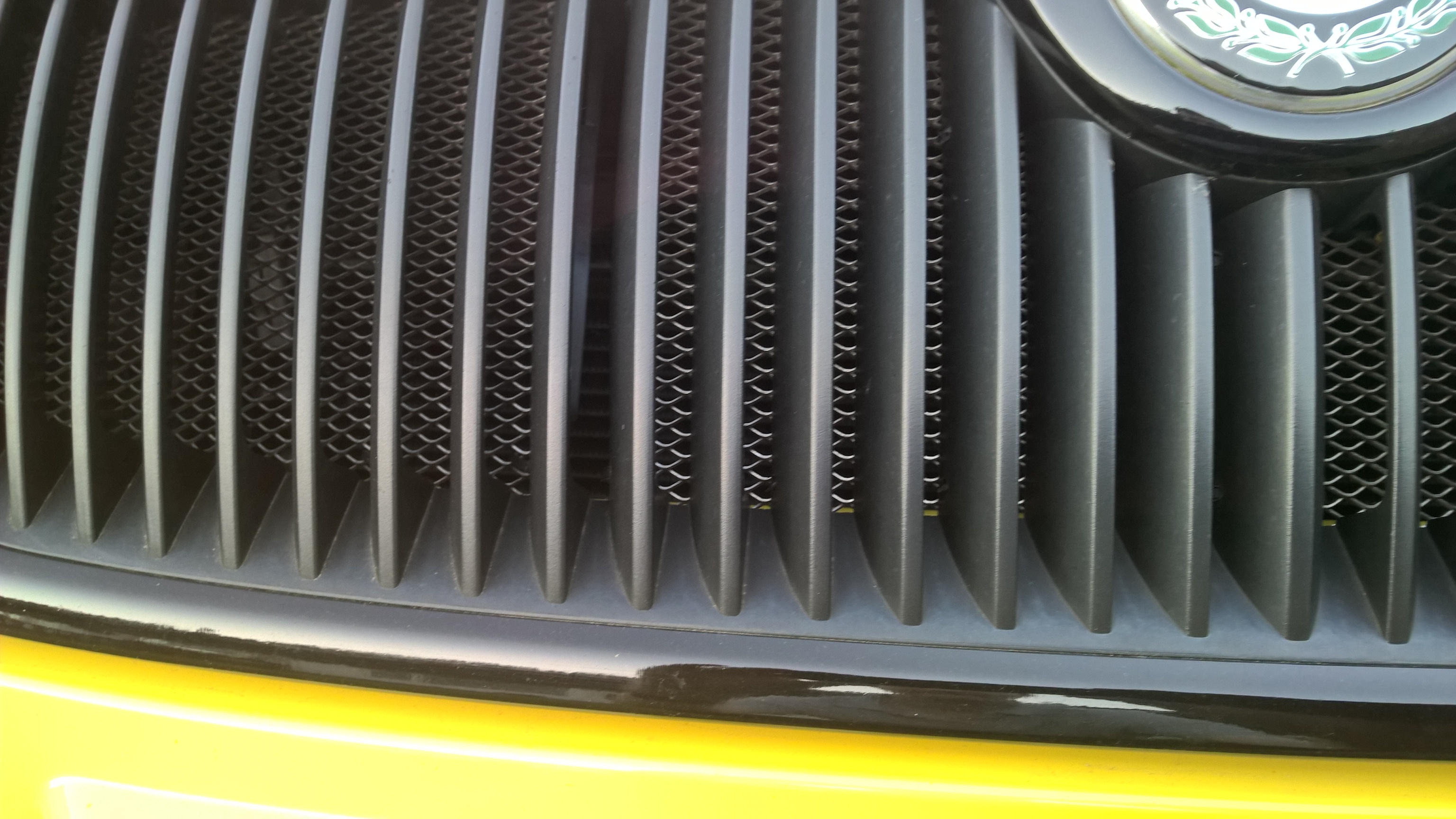

@Little_Grey
Here is my mesh

I would do the same, put a bit of silicone grease on it before you fit the pressure sensor.
That looks like the right one, bear in mind you have to remove all the part on the right hand side and the front end off to get the other pipe off and refit the new one.
£45.00 that's reasonable.
Trev
Tell me about it! From what I can see its the fuel filter, and coolant reservoir. Is the front end a pig of a job?
Dont believe the picture of the system. It says its for a bkd engine amongst others but it isnt. On the bkd the short pipe to the compressor is the one with the sensor.
