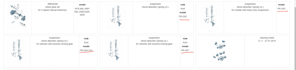

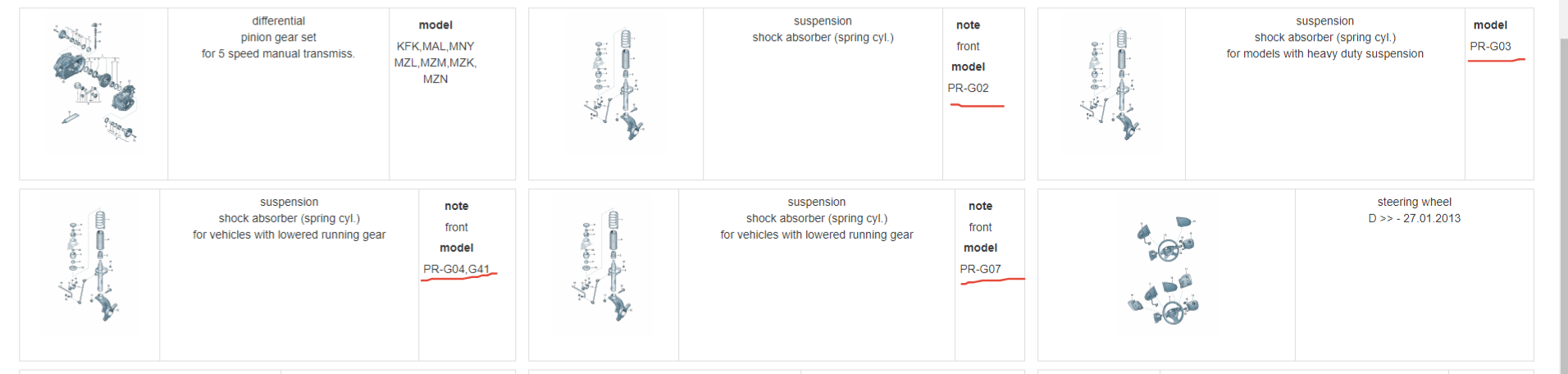

Yes I used that website before, but on the parts catalog this is what it says, so I should have "lowered running gear" which I think is the sport suspension.
I think you may just have lowered springs. My car has lowered suspension to lower the drag co-efficient to a small degree but the shock, as far as I know, are bog standard shocks and most likely fairly low budget standard equipment. The springs just sit the car a little lower. Yu will only notice alongside a standard set up.
So you are saying the shocks from code G02 and G04 with different part numbers could have same piston length or be the same shock?
All shocks are same length but have different spring rating in that G04 be firmer than G02 or vice versa both will have the same travel. With lowering springs the car will sit the lowering drop further down the shock.

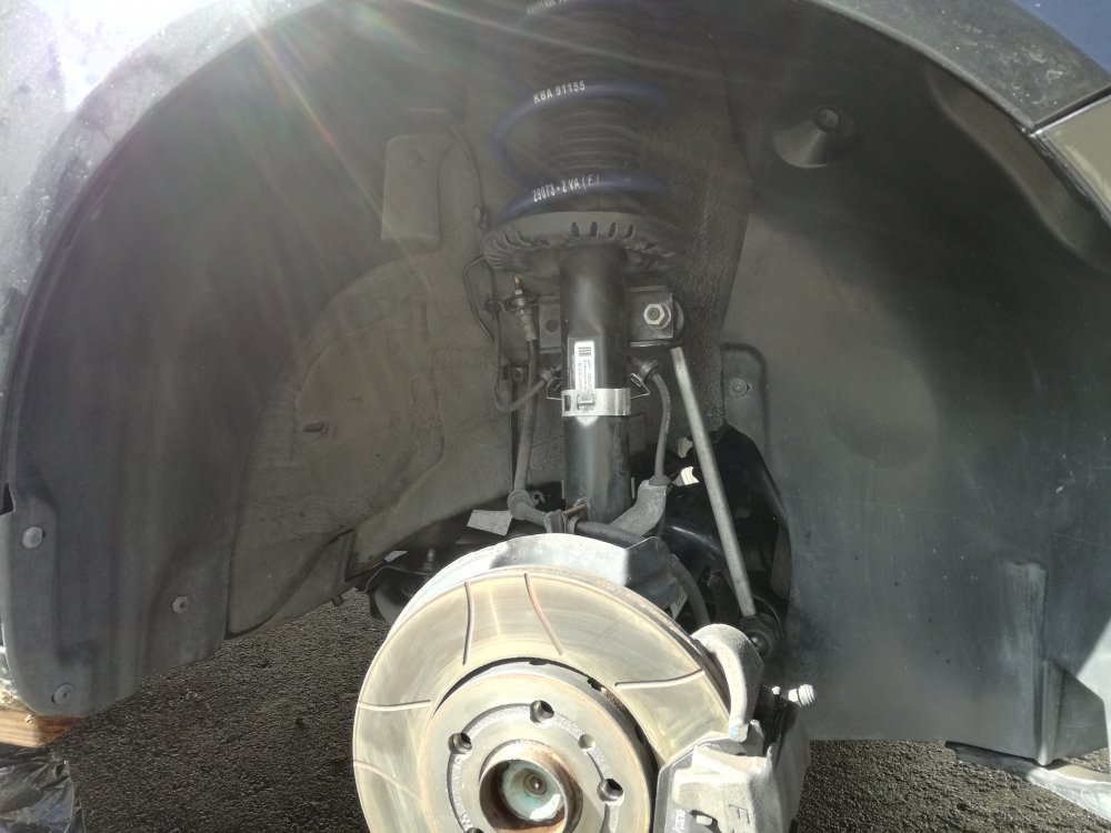

At first glance, I think your car has had its springs replaced because they arent a cheap black colour and look reasonably new.  When I googled your springs, it came up with H&R ones, so I would say you have lowered springs on your car.  Your shocks just look standard and are therefore unlikely to be anything to do with sports, as Offski said, only the springs were a dealer option.
Edited by globalste
Yup! They google as being H&R Sports springs for Golf 6, Leon and Fabia.

Globalste Mrgf well spotted, his car has had ,possibly , a Dealer fitted sports option of lowering springs with standard shocks.
Whereas mine is now standard springs with me having sports shocks fitted.
Edited by Kenrw8
Sorry I think I expressed myself the wrong way, yes they are H&R springs that I've fitted, what I wanted to know is if my car had the "lower" monte carlo setup (about 10mm or so) that also comes with stiffer front anti-roll bar (19mm or 20mm) instead of the regular 18mm.
But by examining the original shock part nº, the original spring color codes I think it came with the "sport" or, on stilts as Offski put it, because my idea was fitting the socks that came with the monte, and anti roll bar but now I see there is no reason for that.
