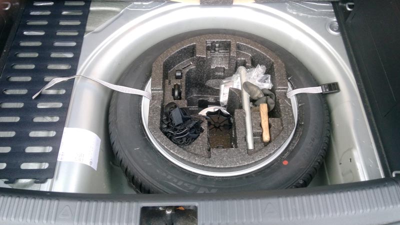

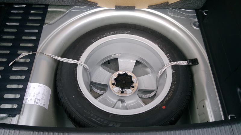

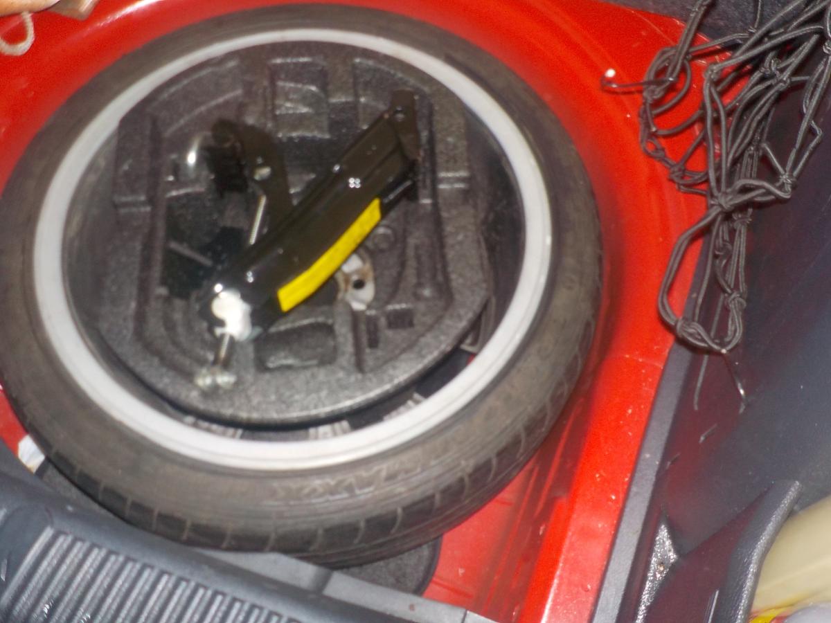

Does a 16" or 17" alloy with a 205 or 215 really lift the floor, or a 195/55R 15 spare as fitted in Mk2 Fabia spare tyre wells.
Sorry, if I explain further:-

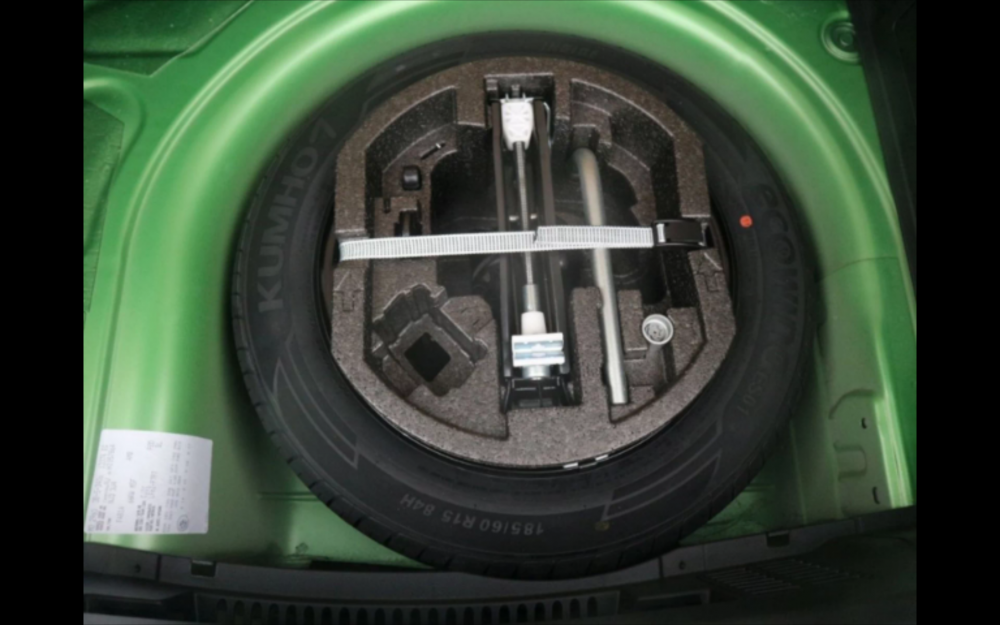

I ordered my Fabia III with 15'' alloy wheels and a full size steel spare.
With the steel wheel and the tool kit inside it, this fitted flush with the boot mat.
See the photo from RickW above, the green car.
I also ordered a new alloy wheel to use as my spare in the boot.
I then fitted this alloy with the tyre that was on the spare steel wheel and put this in the boot.
But when I put the tool kit in the boot it was higher than before.
This is because the tool kit foam bottom sits on top of the inner hub face of the alloy.
Because this alloy wheel is thicker than the steel it raised the level up.
So it is not the width of the tyre that is the problem but the ( reverse ) offset that is the problem.
A wider wheel will normally have an inner hub face that is further away from the outside face of the tyre.
Thus increasing the height of the top of the tool kit.  HTH.
Thanks AG Falco

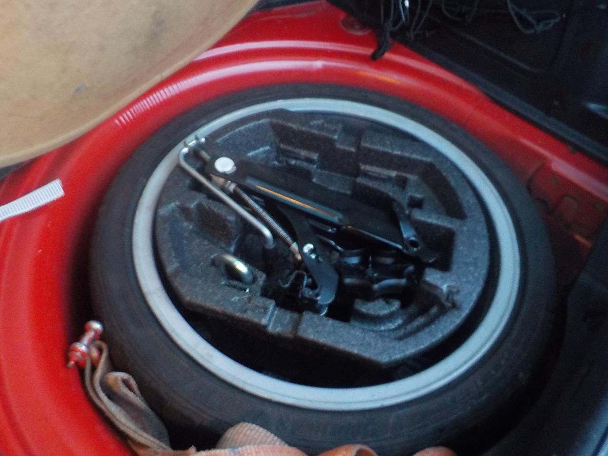

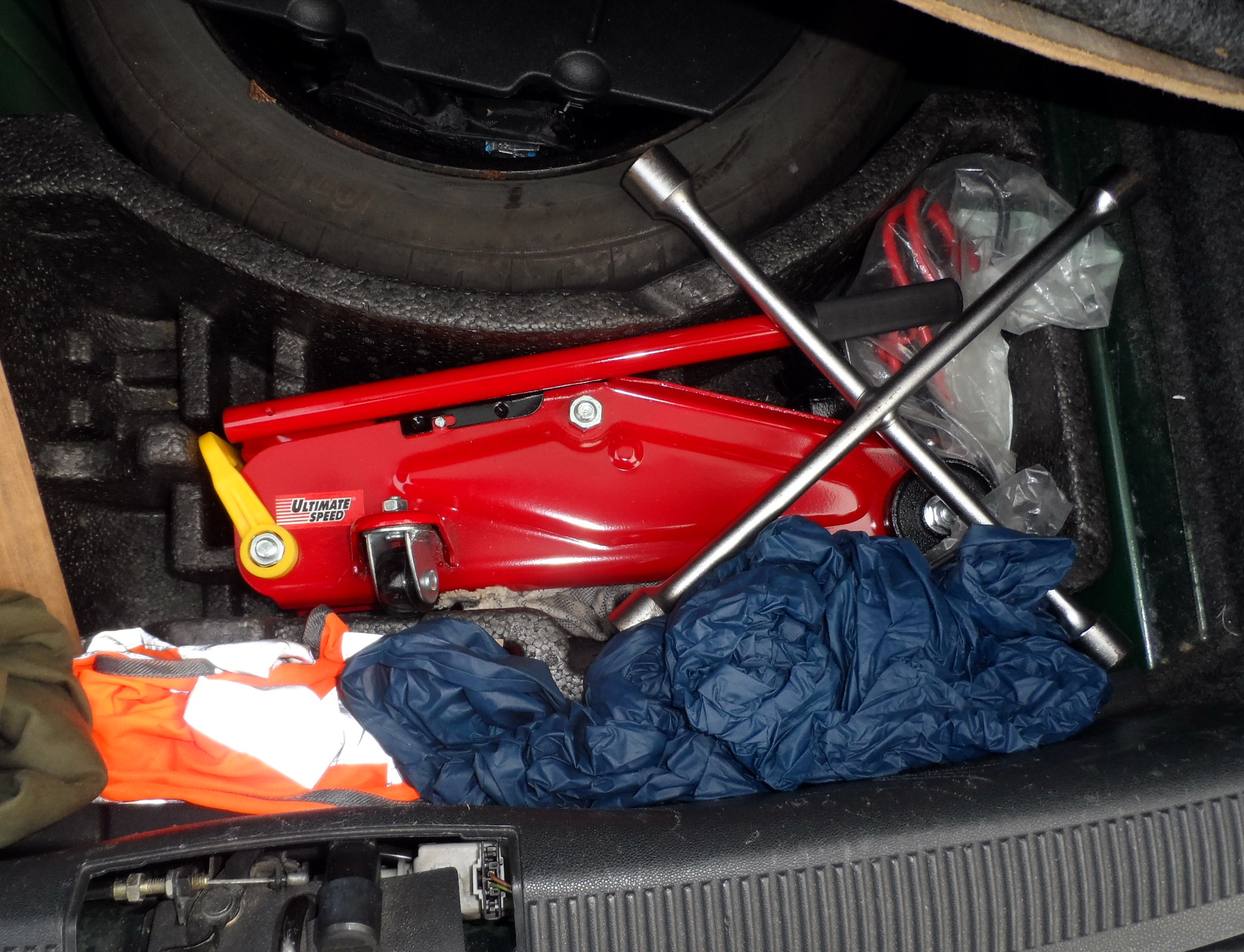

In the red Mk2 that is a Gigaro 17" alloy  one with a 205/70 R 17 & another with a 215/40 R 17. (Edit) Same foam insert as comes with a Mk3.

@AGFalco Can you adjust the shape of the toolkit foam bottom, that it will fit under the boot mat?  In my Fabia I, I had also an alloy spare wheel (195/50 x 15), and no fitting problem, but the toolkit was not made of foam but made of plastic. Maybe the toolkit holder of the Fabia I and similar cars can solve this problem.
In my Fabia I, I added a small universal jack and a rubber block to the tool kit. In the combi (estate)  this fits between the spare wheel and the back door, under the boot mat. In my Fabia III there is more than enough space to put it in the same place. Some pics from my Fabia I, I have to make similar pics with my 2016 Fabia. I see the photo of the jack in the boot is with steel rim, later I replaced the steel rim by an alloy rim.

1 hour ago, Offski said:
You just secure the alloy wheel down with something not as large as the black wind down handle
If you look at the second picture you can see that the black wind down handle is not touched by the tool kit
Yes cutting the top or the bottom will lower it.
It looks like they have changed the insert on the Mk III compared to the Mk II.
Look at how the jack is open and sideways in the Mk II and upright in the Mk III.
The photo from RickW show this better.
Thanks AG Falco
