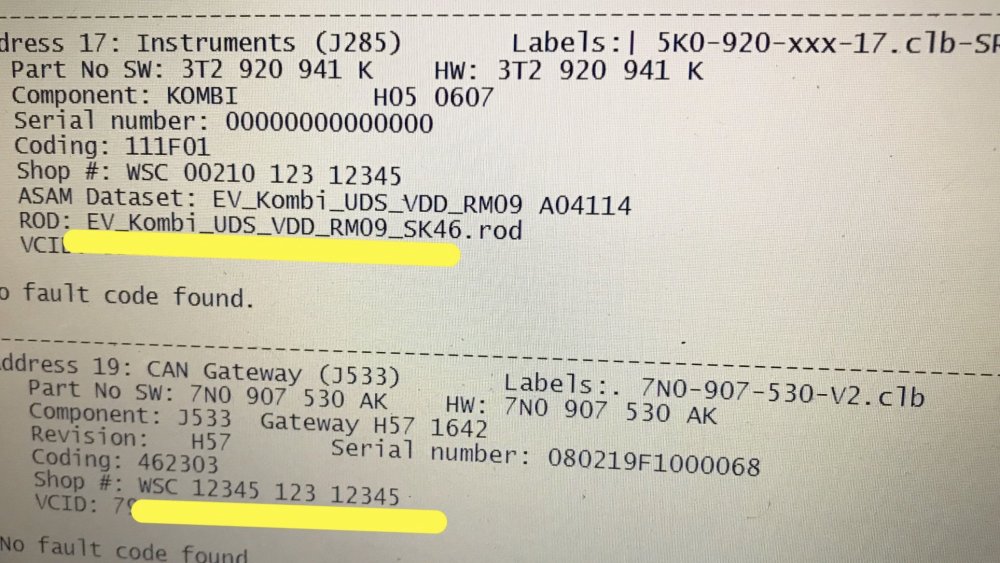

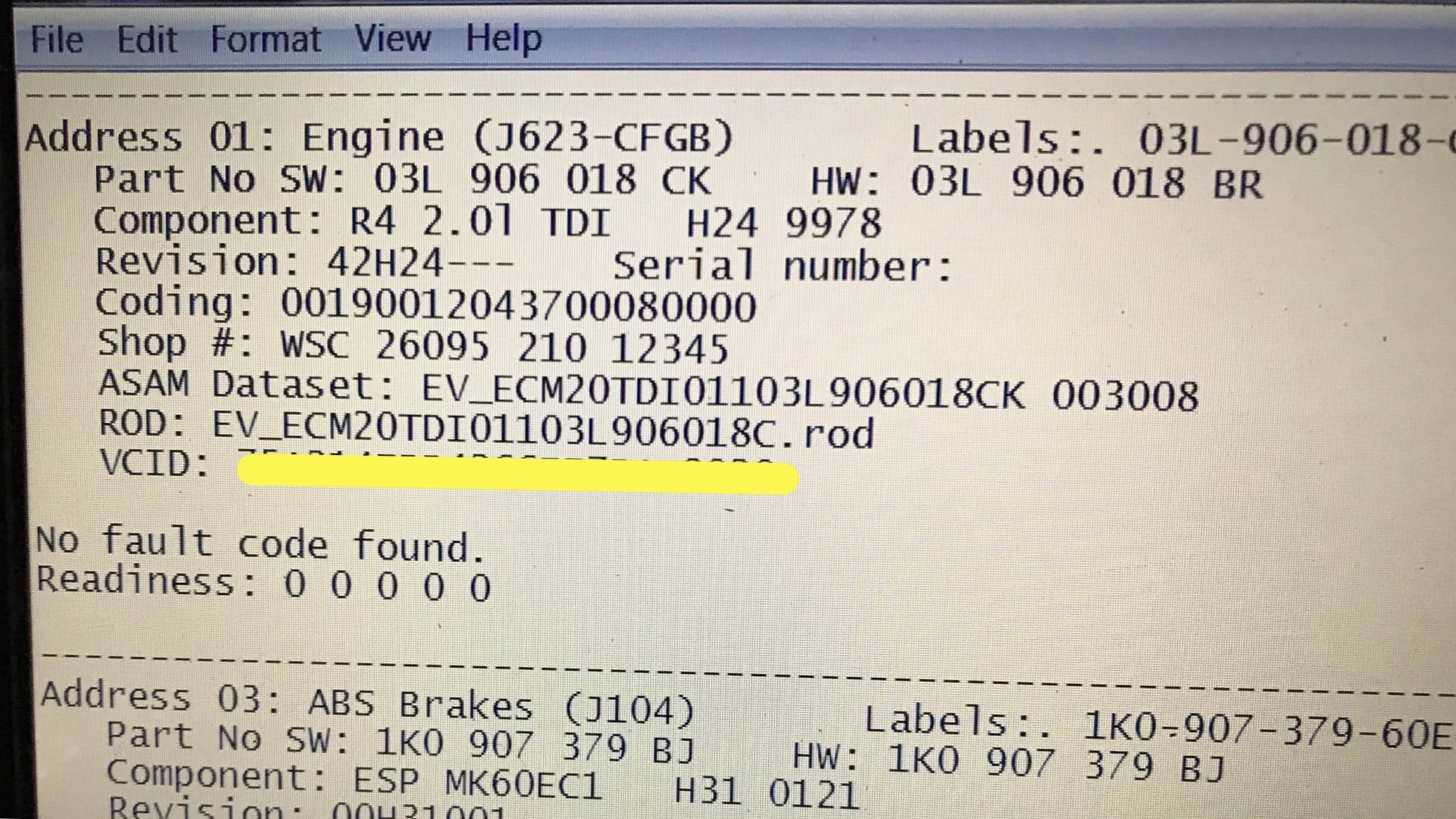

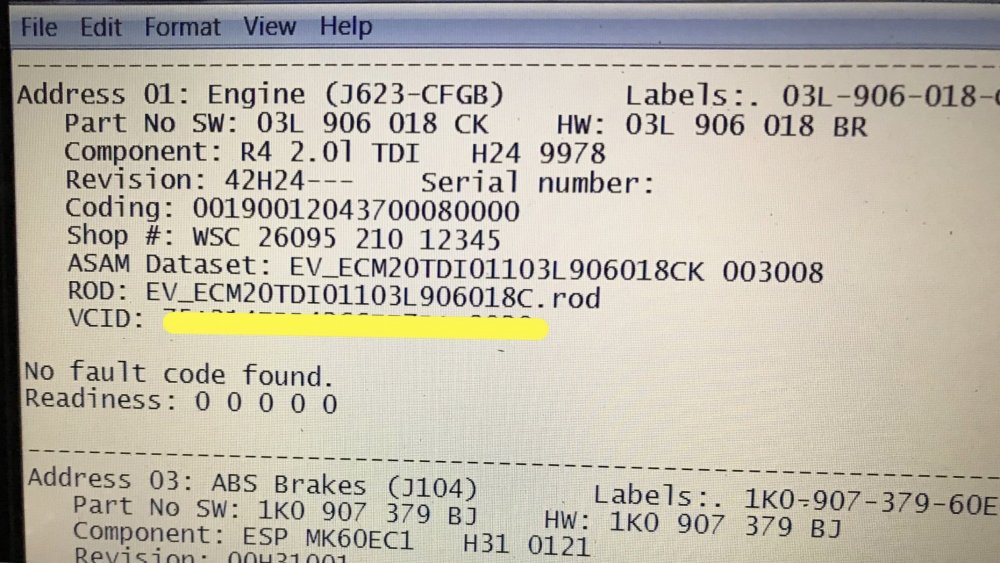

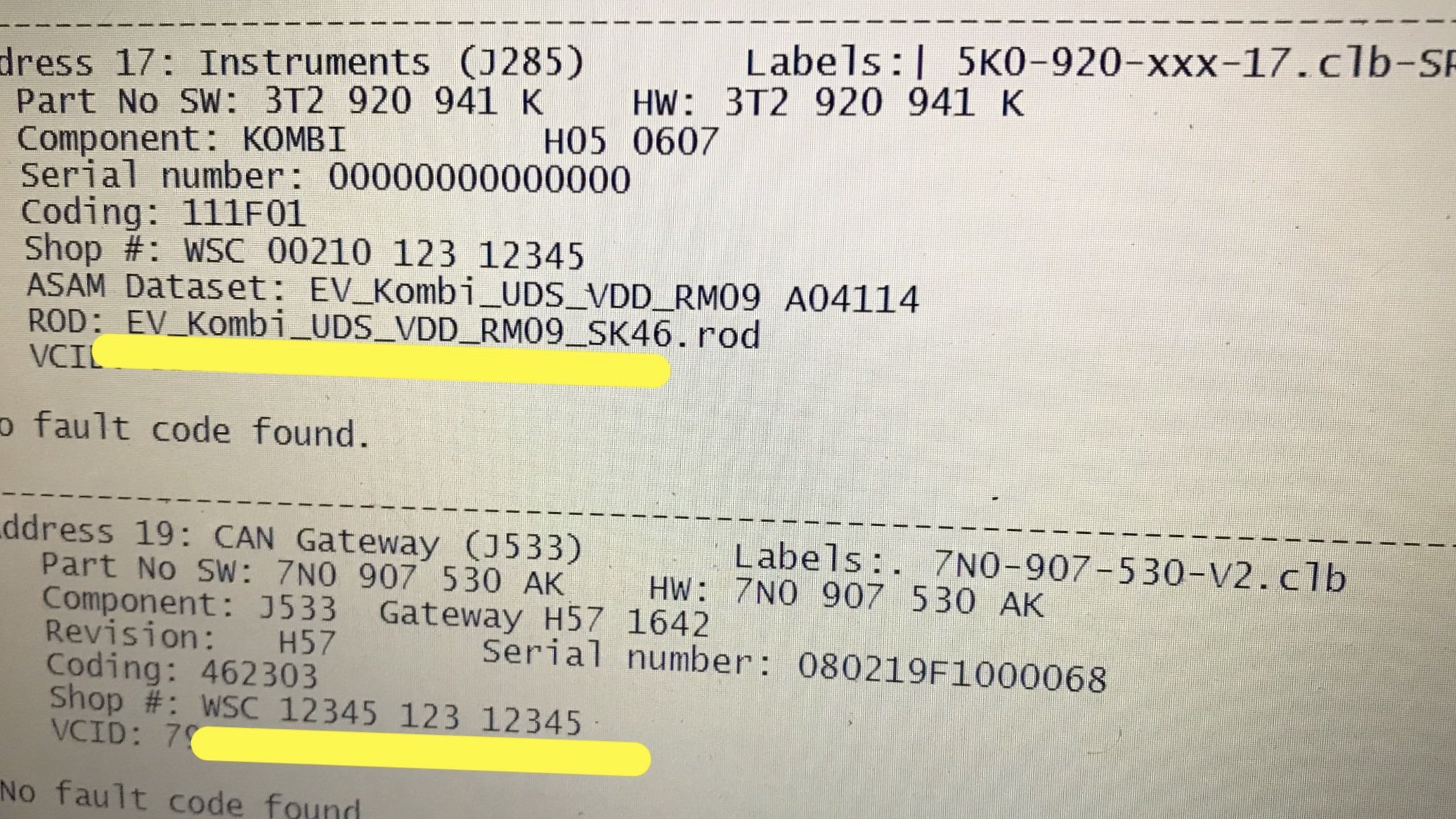

Nope, can't get mine to display, typical, got a nice green light though :-))
Word 01 = 03L 906 018 CK H24 SW 9978 Coding 00190012042700080000
Word 19 = 7N0 907 530AK. Coding 359303, will update software tomorrow to latest revision but this won't have any effect as comes from engine ecu.
Word 17 = 3T2 920 941 K H05 SW 0607 Coding 411F1 No option to set the dash type on mine.
@DrCorbyLee If you have VCDS, any chance of letting me know your engine ecu part number and sw version along with the dash part number and sw version, not gonna let it beat me.
Edited by 3T51704x4
Unfortunately mods were done for me by a third party so don't have access to VCDS. Do have Carrista dongle to use with VAG DPF app, will see what that can do in terms of getting requested info.
