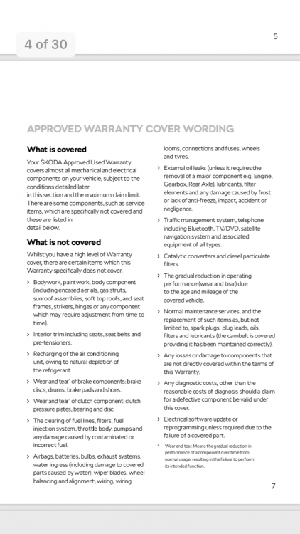

Is this  "Skoda" extended warranty and if so is it all component cover? If it is all component cover, I would expect the part to be covered.
No it is a used warranty.
Screenshot of cover summary - more not what is covered than what is.

All info regarding original warranty can be ignored, mileage restrictions etc - it doesn't apply. The OP has taken out a new warranty on a used car.
