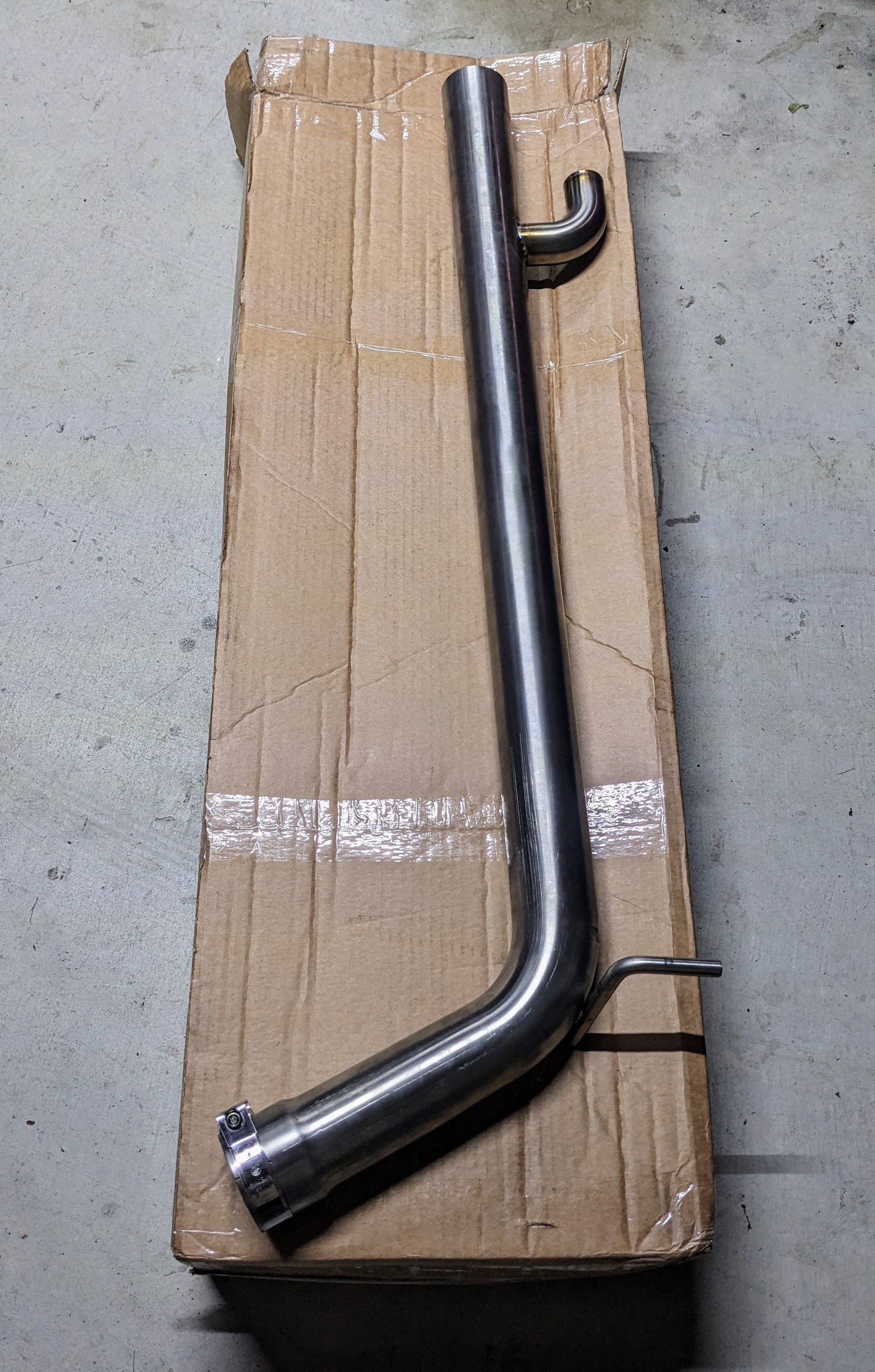

Today I tried to fit a RPM Performance  Resonator Delete Anti Drone pipe.
Sadly, it wasn't possible.
My assumption that mk7 Golf GTi and mk3 Superb 220 share the same centre resonator box was wrong.
The piping length and angle on the Superb 220 (162TSi) differs to the mk7 Golf GTI, even though it's the exact same engine.
Seems it's only similar up to the downpipe, from them it's different, including the centre resonator box.
This morning I took the car to an Exhaust shop and we put the car up on a hoist to see the fitment.
The piping between the front clamp (to downpipe) and the resonator box is about 2-3 inches short on the resonator delete pipe.
The Superb factory resonator box has a longer pipe length between it and the downpipe clamp.
On the other end, where it bends towards the rear wheel suspension, the angle/curve on the resonator delete pipe is not enough, hence it won't line up.
The factory pipe bends almost 80 deg or so, whilst the resonator delete pipe bends about 60 deg or so.
I should've taken pics when the car was up on the hoist to show the difference.
Disappointed I am, big time. 😪

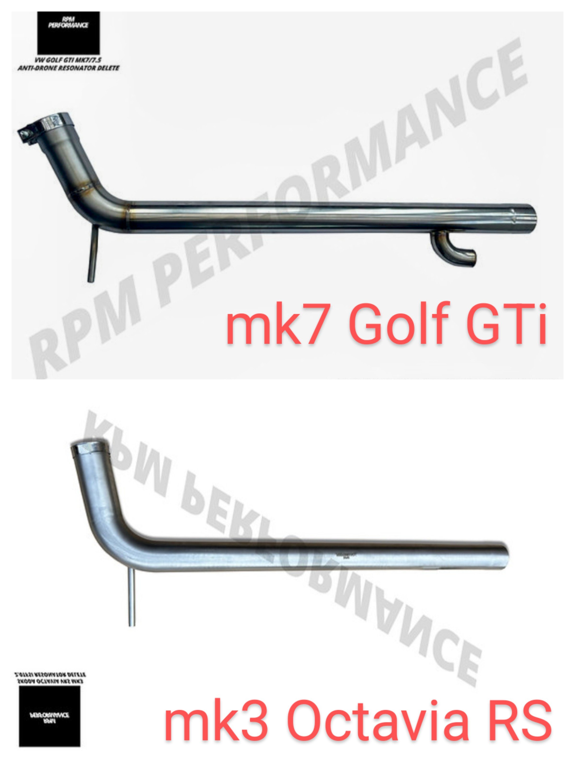

I've been chatting with RPM Performance in the UK - turns out I should've got the mk3 Octavia RS version!!
I had seen it previously on their website before, but I didn't know they had an Anti-Drone version of it too.
Grrr.....stupid me.
Hard lesson.
In the pic, u can see the difference in angles between the two here.

4 minutes ago, JR RS said:
Would b cheaper to cut my losses n sell it to a local Golf GTi owner here in Oz, rather then pay to have it shipped back to the UK, and then pay shipping for the exchanged version.
Grrr.....stupid me.
Hard lesson.
Grrr.....stupid me.
Hard lesson.

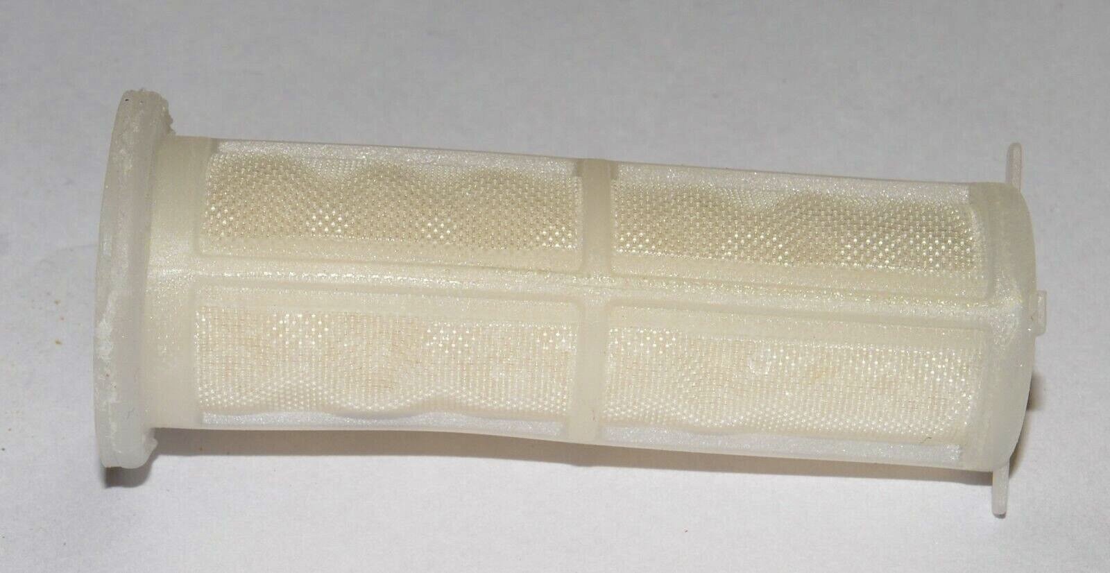

I’ve heard it does but haven’t seen it with my own eyes. Also, the cartridge alone costs circa 20 EUR. I would rather have fresh coolant every other year.
I’ll get the indy I use to change the coolant when it has its annual oil change next month.
There's a science to the helmholtz resonator. You have to have it matched to your car to cancel out the drone. And obviously it's not cheap.
There isn't an off the shelf option for the superb. Things may seem to be the same on the mqb platform, but they are not.
On 06/02/2024 at 13:19, numskull said:
Anyone know if the VAG Silikat cartridge will fit in a standard header tank?
The cartridge still fails as such from what I saw, that’s if it’s the ones which have a mesh fabric covering the pellets, just like the bag
I’ve seen a plasticky one for Audi. Looked sturdier.
There you go….
Cheers. The mesh seem to endure. It is the seams that fail from what I’ve heard/seen.

Is that to be used with G12evo?
Nope. G13 only. Just a fancier container Audis got at the time vs VWs and Skodas’ pouches.
