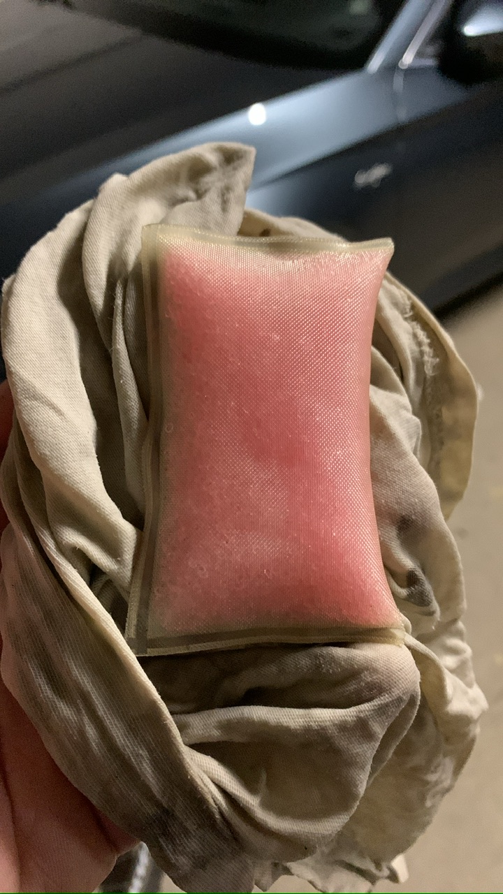

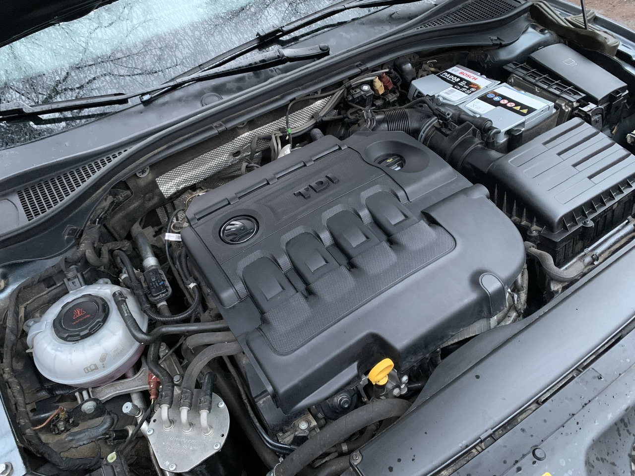

Had the chance to remove the silica bag from the coolant. Those have been notoriously known for breaking and clogging the matrix heater. Soon I will be servicing the engine oil, gearbox, Haldex. So I thought why not flush the G13 down the drain and get a fresh refill of G12evo.
How easy  / hard was it to do?
I have one in my coolant reservoir. Looked at it a few weeks ago & couldn't see how to get it out without risking bursting the bag. YT vids I've seen require the reservoir to be drained & removed from the car to get at it.
I’ve got fat fingers so pulling the silica out was a no no. I had to remove the reservoir indeed. All videos on YT are quite accurate and not a huge problem, so long as you have big enough pliers to squeeze the bottom hose bracket. If you can see the satchet floating in the reservoir you should have not trouble yanking it out. I put the tank upside down and pulled it with my middle finger and some thin long nose pliers.
btw there is also an alternative that Audi use. What is a plastic cylinder filled with silica. Looks much more reliable than the lousy teabag and I know of people having had that replaced. Saves the hassle of flushing and bleeding the complex coolant system.
Hope this helps. Cheers.
Thanks.
I think my reservoir has two chambers & the bag is in the bottom one which has no access from the top.
I've ordered a new coolant reservoir from Amazon (£25.79) so I'll just switch out the old for the new which looks easy enough to do & removes any chance of the bag splitting while trying to remove it.

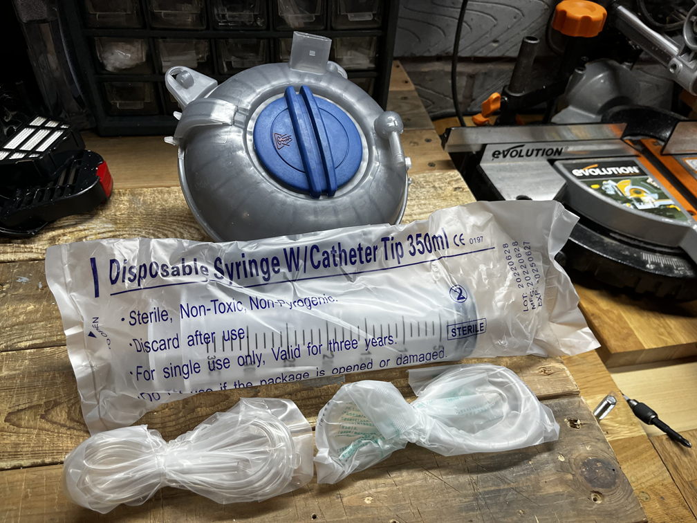

The parts arrived yesterday so I will be fitting a new coolant reservoir in order to get rid of the "Mit Silica" bag one that's fitted to my car.
The wife objected to me using the turkey baster to drain the excess coolant out of the reservoir so I had to buy a syringe as well :smirk:.
However, with no cover or a garage that I can get the car under or into I'm waiting for it to warm up a bit before I tackle this job on the drive. By the looks of the weather it may be getting colder next week so it might be a while before this gets done. 🤞the bag stays intact for a while longer.
I have already replaced my container. But because of something else. There are no more with silica anyway.
Simply disconnect the hoses, then separate them and quickly remove the container. I didn't need an injection. Insert a new tank and then adjust the level again.

2 hours ago, Colin170CR said:
syringe
 I didn't use a syringe at all. A small towel/rag under the lower hose and a thumb to block the container's lower connection. Once I took it away from under the bonnet I drained in a half-litre water bottle. And that was exactly how much coolant/distilled water mixture I needed for topping up. And just in case after the procedure is finished and having driven the car for a while, I'd check the coolant level again at low temp.
My original suggestion for syringing out the expansion tank with a turkey baster was simply for eliminating any spillage onto engine bay paint (I'm not really that mean to save on 250mls of antifreeze 😄) But I do strongly recommend investing in a proper pair (inexpensive) of hose clip pliers.

Indeed, I’d’ve hated spilling some in the bay. But my point was no syringe was needed at all. The bottom hose is last to be disconnected. A quick thumb on the tank stops from spilling the liquid and a few drops on a tissue or rag below the hose, no big deal. I replaced with fresh G13/distilled water.
