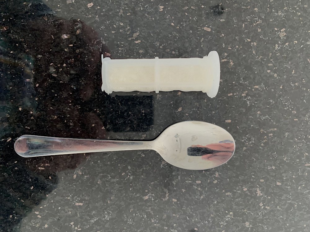

On 05/02/2024 at 02:55, numskull said:
I replaced the OE Silikat header tank yesterday with a non silikat unit. Took about 15 minutes from start to finish.
Using hose clip pliers, I removed the top hose from the tank first (which took the most amount of time during the whole job, as it was very reluctant to budge!) then freed-up the plastic hose support bracket connected to the side of the tank.
Then, I applied upward pressure on the rear of the tank and using a flat blade screwdriver, I undid the two clips on the top rear of the tank until they’d become disconnected and finally, using both hands, I yanked the bottom fixing out of the hole in the wheelarch and the tank was free.
I then turned the tank 45 degrees and removed the bottom hose, and quickly turned the tank upside down whilst keeping a finger on the top hose inlet.
I then emptied the G13 into a jug and then installed the new tank, replaced the G13 from the old tank, topped it up with fresh G13 to the top of the min mark and then ran the car upto temp to check for leaks.
Having changed the header tank to get rid of the Silikat bag, I decided to buy one of the VAG Silikat cartridge, which should be more reliable than the bag.
It arrived yesterday and this is it. I’ve popped it against a spoon to give it some scale.
Oh BTW, that’s a teaspoon! Yep, it’s somewhat smaller than I thought it would be. Anyway, I’ll see if it’ll fit into the tank somehow. Obviously It has to be at least partially immersed in the G13 to add whatever the silicate adds to the antifreeze product. I’ll report back….

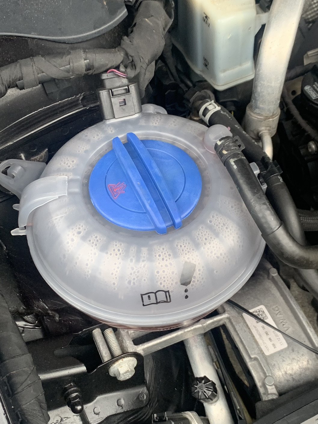

Is that the container that fits in the dual wall expansion tank?
I cant see any Mit Silkat markings on my tank, they may have worn off, it definitely does not have a teabag, maybe it has one of them?
I will have a look now I know perhaps what to look for.
That’s correct.

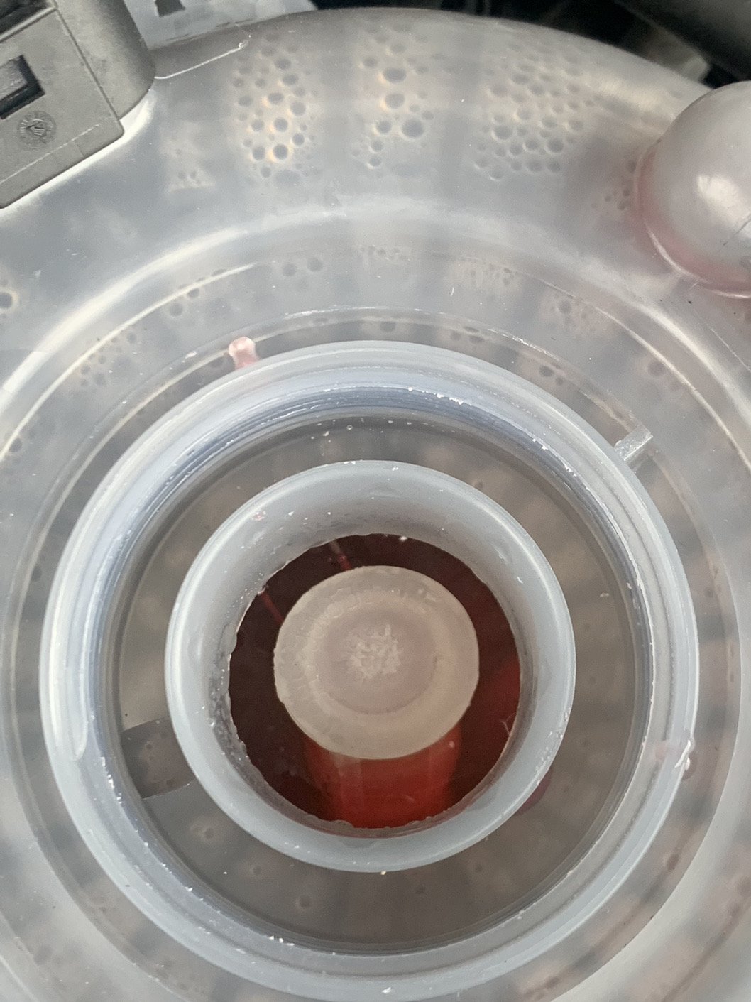

So here is the new tank…
I popped it into the tank and it fits no problem and with about 80% immersion too. IMG_1613-compressed.thumb.jpeg.8fbb7f69548e52c3d71e946d1a717bbb.jpegI’m therefore guessing it should add the protection needed to increase the operating life of the G13.
