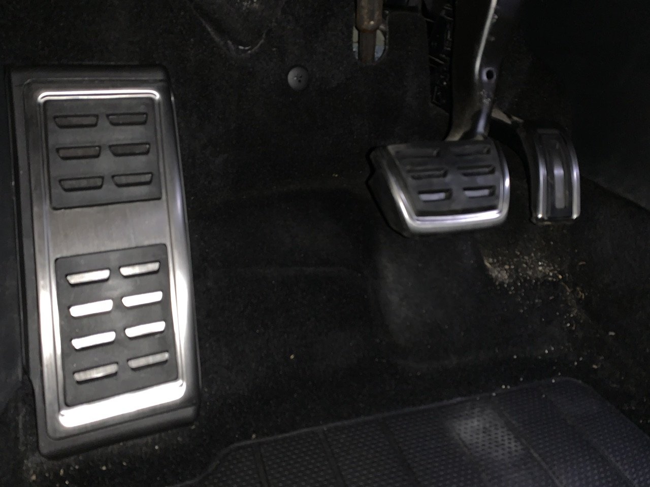

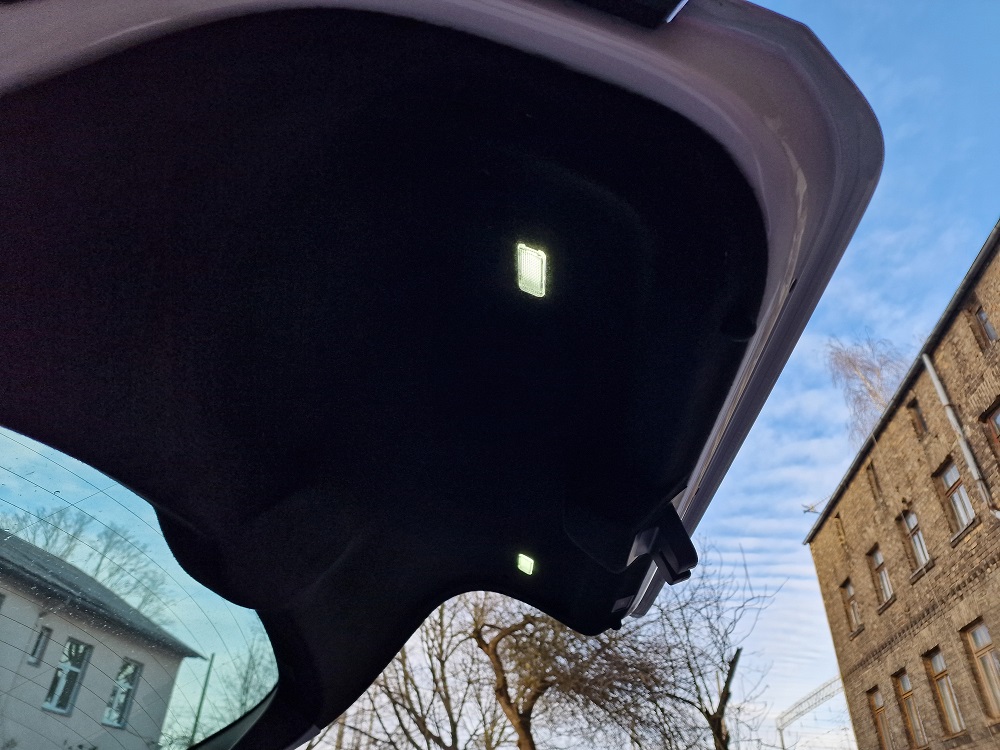

LED boot upgrades. Those were the only non-led bulbs from factory.
Pedal and footrest revamped. Pleased with the materials: soft sticky rubber and stainless steel. All fits like a glove, no tools required.

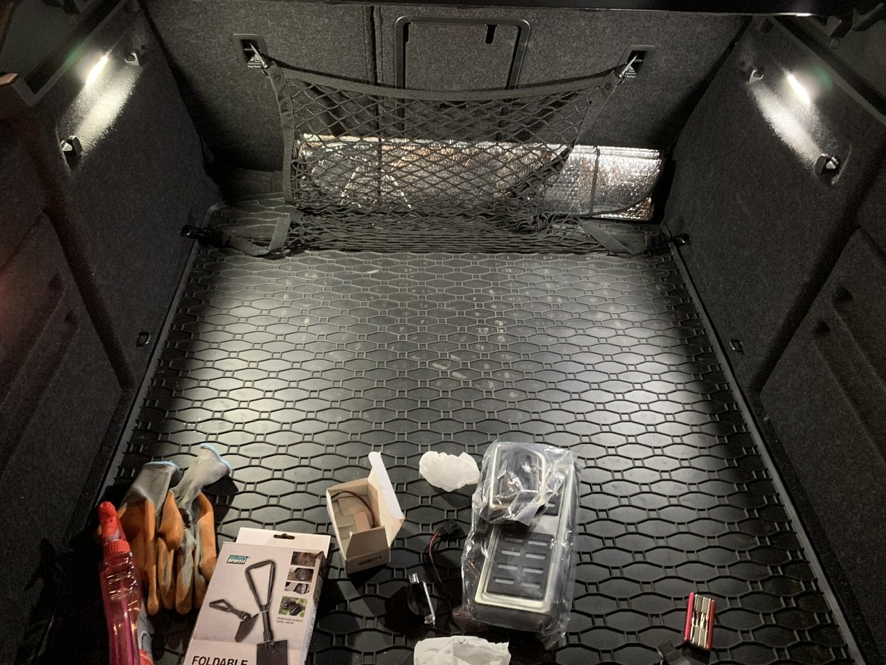

Where did you get the wiring from for those extra boot LED's?
Plug'n'play on the liftback. The saloon/estate has it in a different place.
For the standard placement behind the rear seats, no cables required. For the trunk/rear hood as MartiniB, I think they are used to extend and install 180' deg from "intended" position?
@naster
haven't info, from what source dealer powered them on MY23 Mk3.FL, on previous MY16, source were closing button illumination wires
Oh, I thought I open the caps and reach for the harness and then plug them cables. WIll check later and might take a few shots. Thanks.
Ah ha. I couldn't tell from the photo what model you had.
Mine's an estate & have already upgraded the bulbs in the tailgate lamps but I don't have any lights further back in the boot as shown in the photo - hence my question about the wiring.
