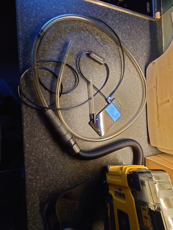

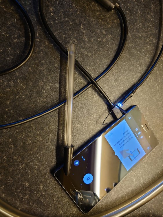

Well after nearly 4 months of ownership, O finally found the source of one of the most annoying rattles. It sound a little plastic bag of nuts and bolts sliding along under the carpet behind the drivers seat. I have pulled bench seat, the bolster, the boot carpet ( estate ) rear driver footwell, lower trim the runs from the front to the back.
After all my efforts, it was a broken biro on the rear floor air vents ! Even after checking them with an endoscope, I still missed it.tje first time. After 2½ hours over the past 2 days , I eventually removed it. Using my endoscope with a hook, long clear tube connected to my vacuum cleaner!
20240523_204258.thumb.JPG.714f4fcbad45a76ab6f0b16348dc7a3b.JPG20240523_204303.thumb.JPG.ece277db36c8546edf6a48648357bd09.JPG
What an ordeal.
  Reveal hidden contents
Slowly slowly catchy monkey. Well done.

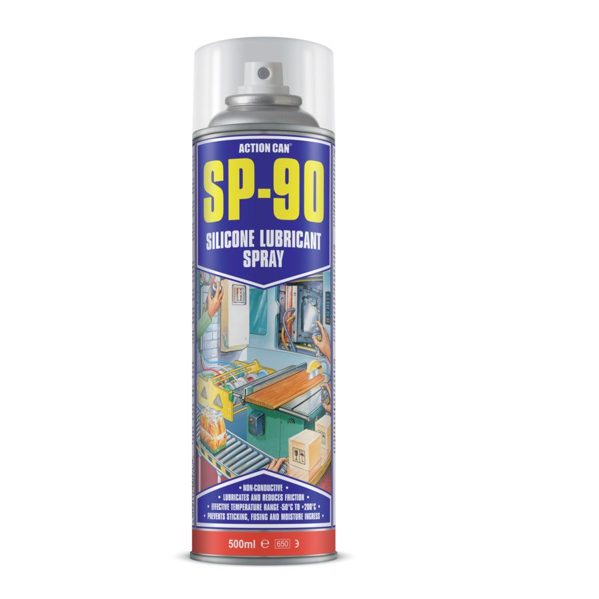

I also had a stuck flap in the HVAC system, it would show a fault in VCDS and make an awful creaking sound when the car would start or when I adjustment the air flow.
I turned everything off and sprayed a generous about of SP90 silicone spray down every vent in the car, let it settle, then in turn activated each blower position.
I can no confirm, fault.has cleared and no more squeaky vents!

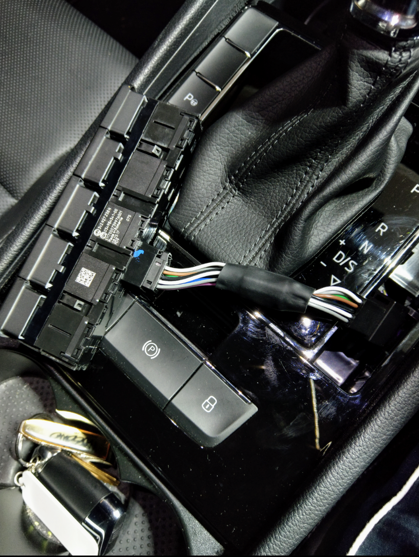

I also received my Start/Stop disable cable , fitted this. A bit fiddly to tuck the excess cable away, but done now. Works as expected!

I have a - ahem - a slightly creaky flap, so I’ll give this a go, thank you.

I have the same issue so I'm interested to see how you get on with it, I'm also wondering if there is going to be vapor/smell attached to this solution when the vents are blowing air out?

Can you tell me where this fits? Is it below the switch?
Mine only does fairly short journeys so isn't a major issue but......
Many thanks.

No, it's a fairly neutral smell. I did it with the windows open to stop the vapor lingering and sticking to unwanted surfaces.

It's installed under the switch, like an extra to the existing loom.
It's not very intuitive, you have to tuck it towards the back so the plug is already in position to receive the switch/socket. Otherwise it bunches up. Get the swit4as close as possible before plugging it in.

The start stop loom "intercepts" the factory wiring and the switch connector.
It sits under the gear lever, and as mentioned above, it needs to b tucked away in a tight space.
Also if u have LHD, u'll find it harder in terms of cable length due to the position of the start stop button.
Mine is RHD, so it was not difficult as the switch is on the opposite side.

Can I ask which product you used?
The Action Can, SP 90. It's a very useful product, seals, bushing, windows etc

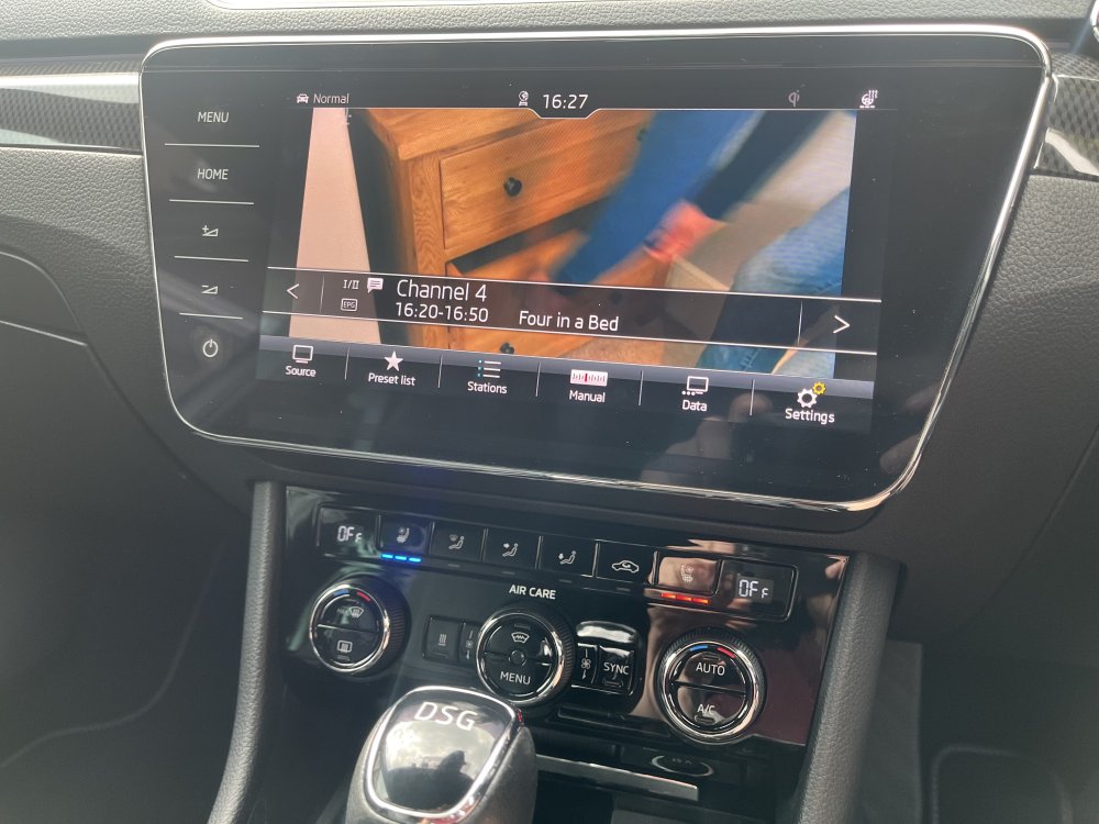

TV tuner now fully working :) Lots of coding options for rear displays - Wonder if I could mount some displays in the sportline headrests.... hmmm - just something ill consider in the future.
@ApertureS Was this TV tuner fitted but not working, or is something that you have sourced and added yourself? I'm asking because my old MK2 I ordered with that fitted, but my new to me MK3 does not have it, and it is something I'd like to add if not too expensive or difficult.
Added from nothing :) complete retrofit.
It can be added but is a fair amount of work. If you did wanna message me I can price it up for you.
@ApertureS Thanks, but it sounds like a lot of work for something that hardly likely to be used that much and will cost plenty.
