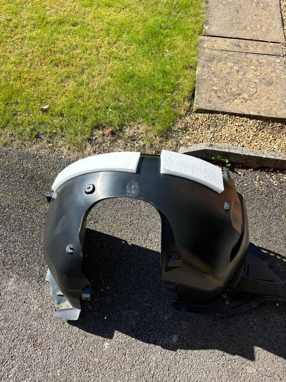

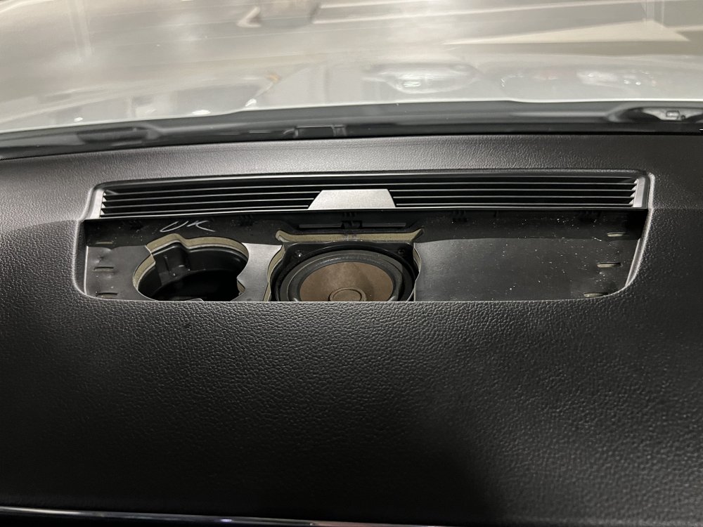

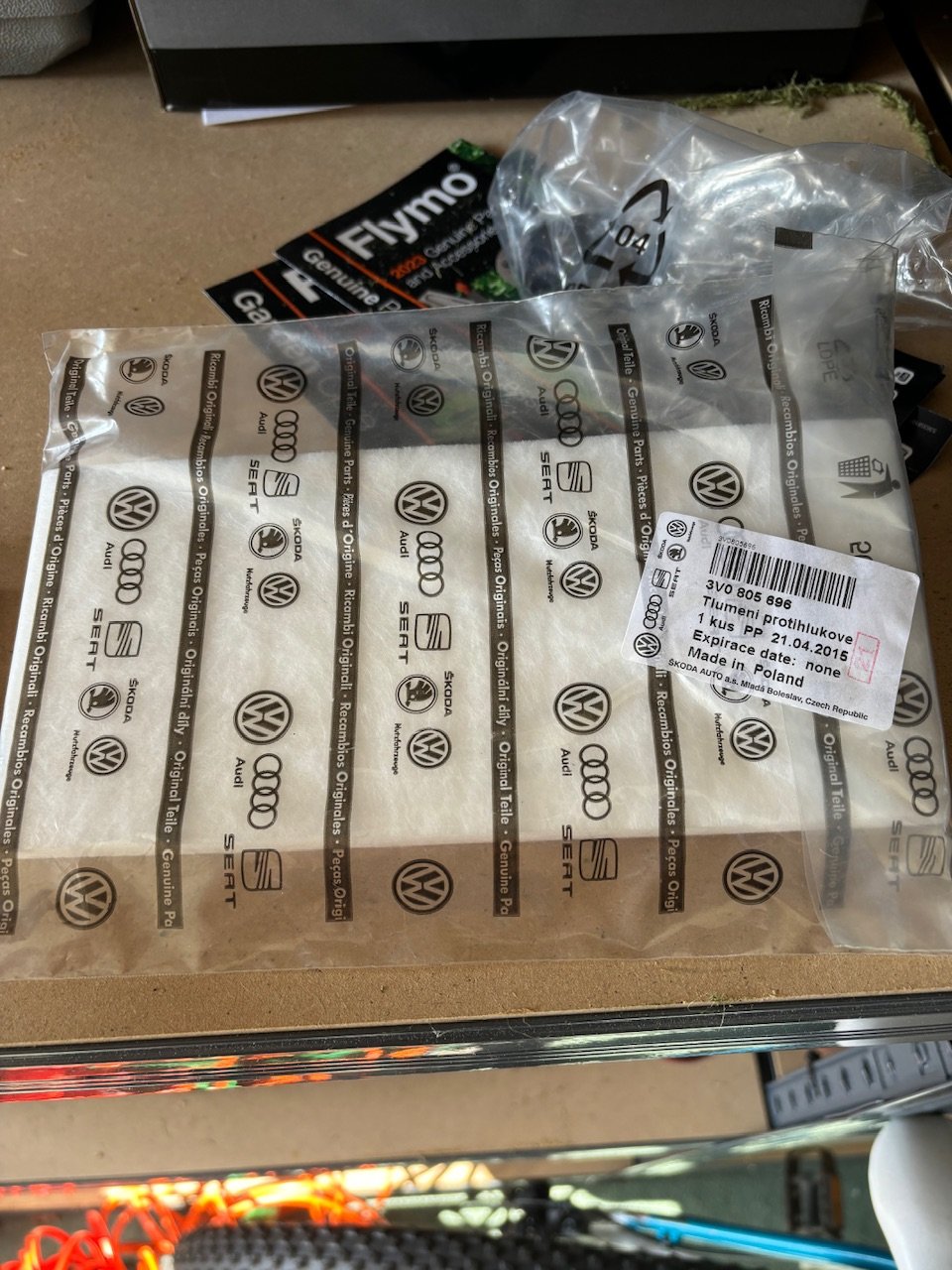

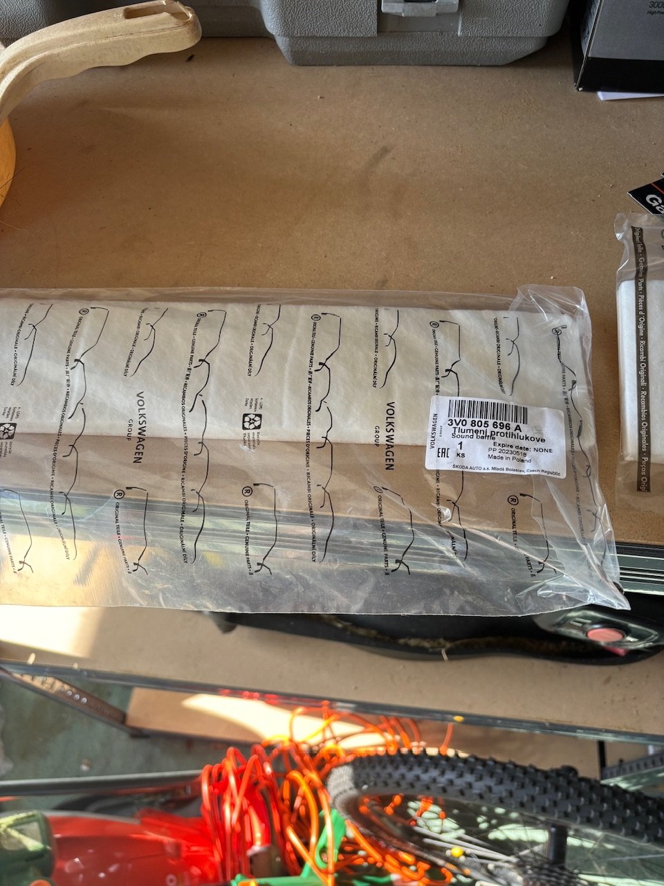

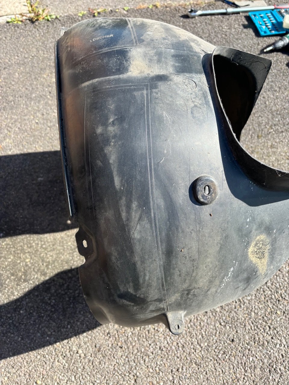

Finally put on the sound “proofing” which L&K’s get as standard and replaced front dogs to osram night breaker laser h8’s (as seen on the front passenger uk) much whiter in real life and hopefully bit brighter too
Has the sound deadening had much effect?

I’ll be going for a drive in a few hours and I’ll let you know
I’m not expecting miracles, changing to good year asymmetric 6’s from p7’s was a miracle though, so much more quieter

So just got to my destination, not a huge difference but certainly quieter because I can hear noise in my estate rear now, never noticed it before.
On my way here there’s a road with like red rumble strips, my car was quiet anyway but even more now.
So from my 30 mins driving (max speed 50) biggest difference is crappy roads no longer seem as bad.
I’ll be doing a much longer drive soon and hoping I’ll notice more difference at motorway speeds.
But I might have to do something in the boot area now because I can notice more noise there, I don’t believe there’s extra padding for the rear arches that can be added on, so might have to DIY stylee

My L&K already had the insulation from the factory and even had foam tape stuck on when the wheel arch liner was out.

I fitted Michelin cross climates recently and made a big difference from the original rubber supplied on our Sportline , its also made the estate boot area noise more prominent so be interesting to see if you find a solution of yours.

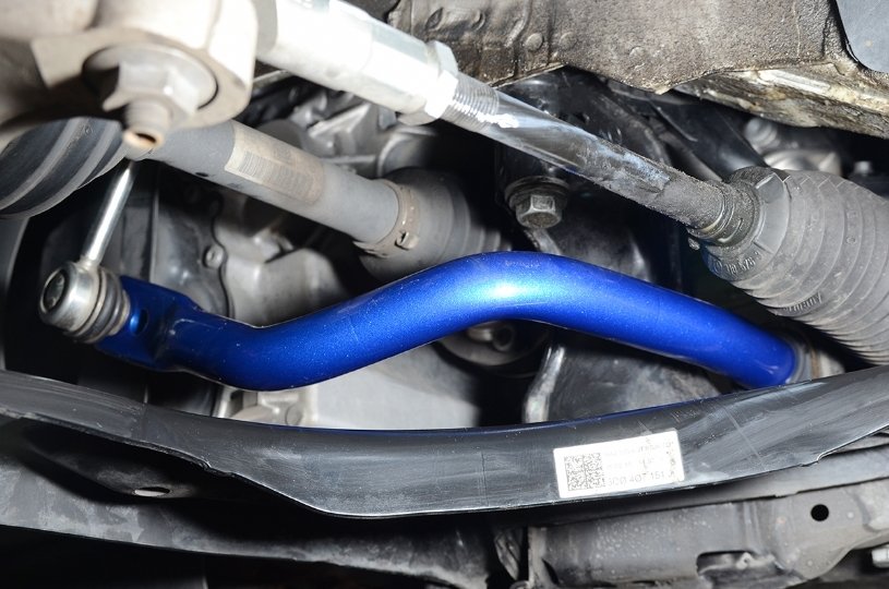

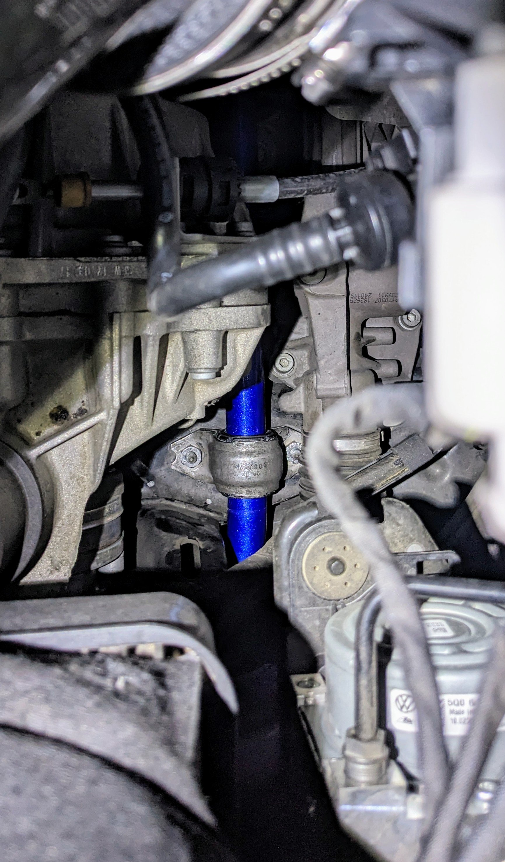

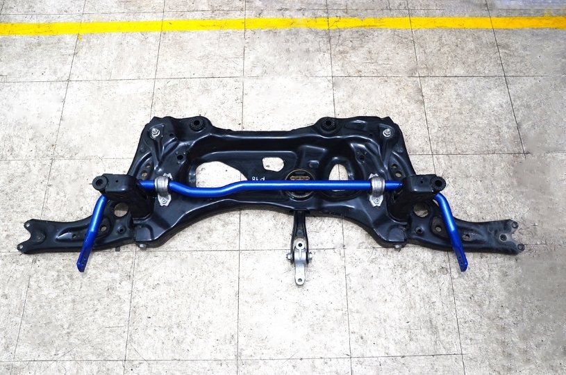

The Hardrace front swaybar (7758) is in. 28mm.
Car feels a lot more tighter, making corners flat n easy 😁
Did a wheel alignment as well as they had dropped the sub-frame.
All good.
It nicely compliments the existing Hardrace rear swaybar (7759) and front strut tower brace (8949).

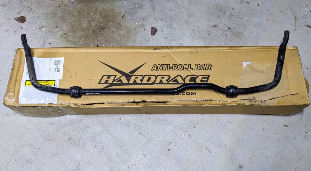

The original factory one...
Did you order the parts directly from Skoda or someone else, link?  Thanks.
Hello, I got them from Skoda can’t remember the price exactly but I think it was around £30 for both sides
I done a longer travel in my car on the motorway and much improved but can still notice the rear noise is more noticeable

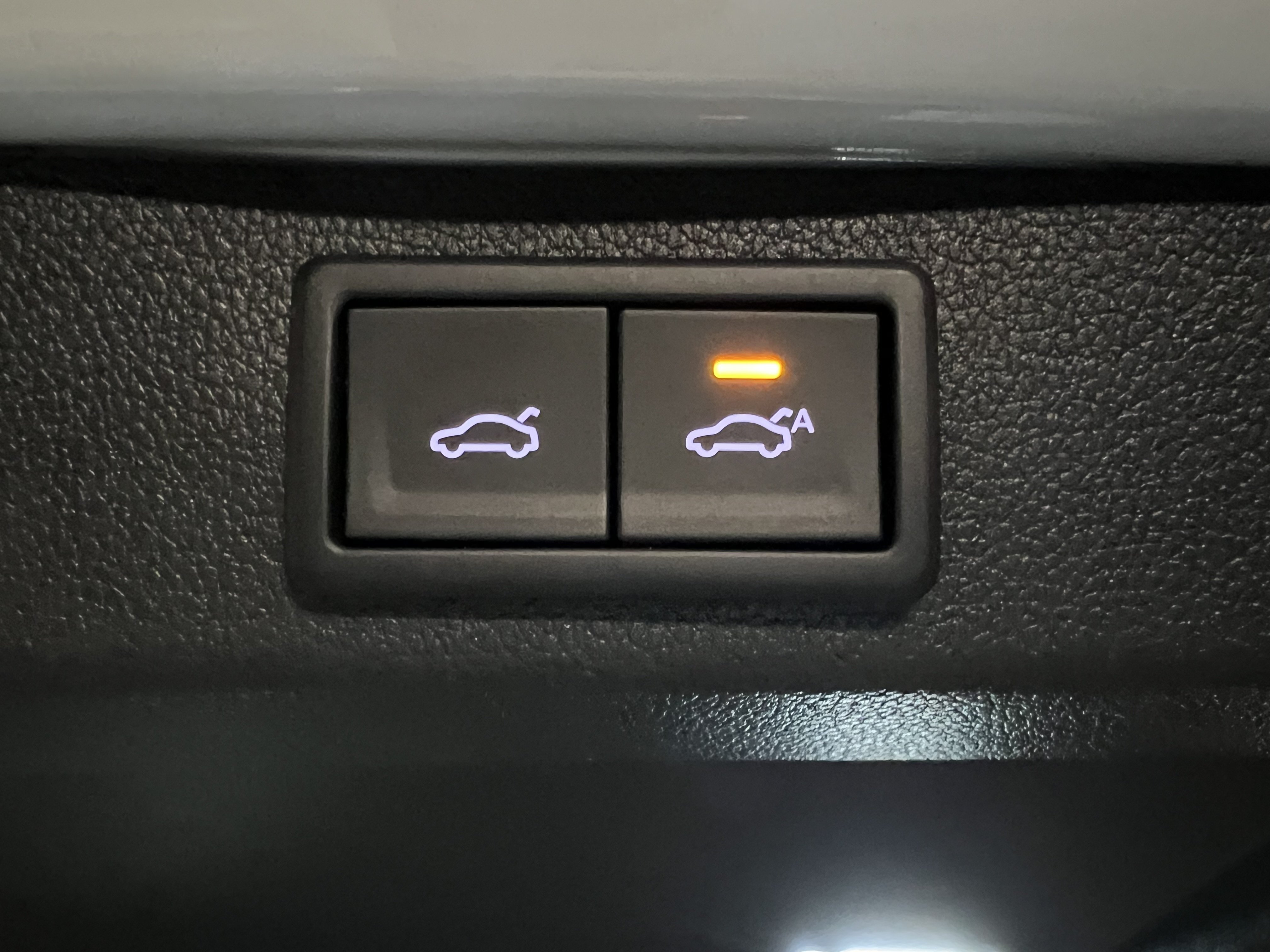

I've installed Easy Close, really nice feature.
Edited by zacko_O
Not sure what is, so it prevents closure if someone is in the way? If so part numbers !!!!!
It prevents closure if key is too close and also puts car on guard. So you don't need close car from remote or touch kessy handle after lid closed.
5Q0959107M/Q/T rear lid module + button 3G0959832AWHS
Nice feature to avoid the boot closing on you back when you inadvertently trigger the virtual pedal with your feet. 👍
I've been there & done that! Although the boot did stop when it felt some resistance. I had the car for 2 years before I discovered it had a virtual pedal 🤣
What a fantastic upgrade! Goes right away to the list of stuff to do ... a long list 🤪

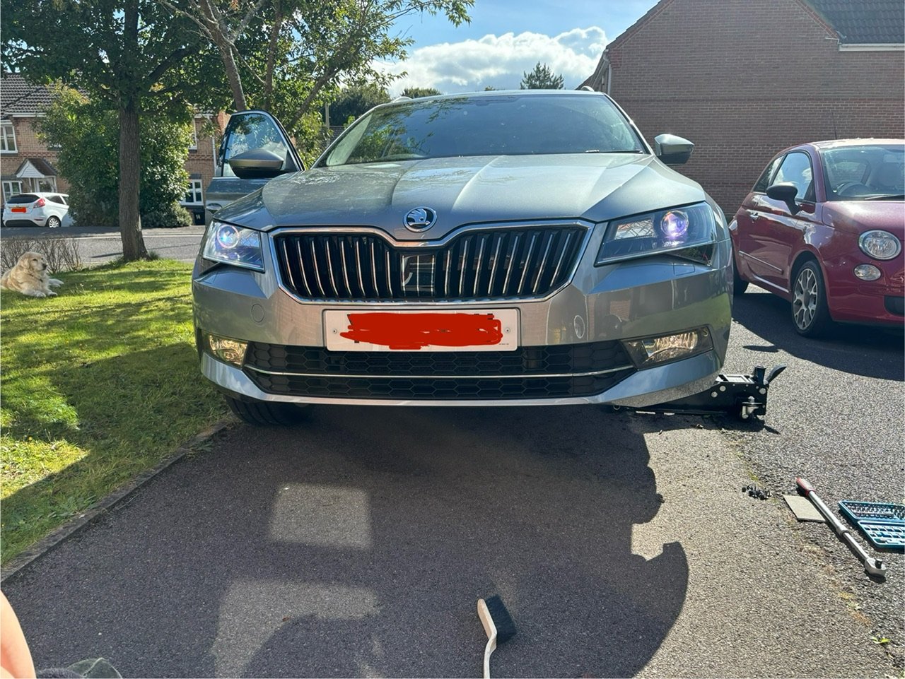

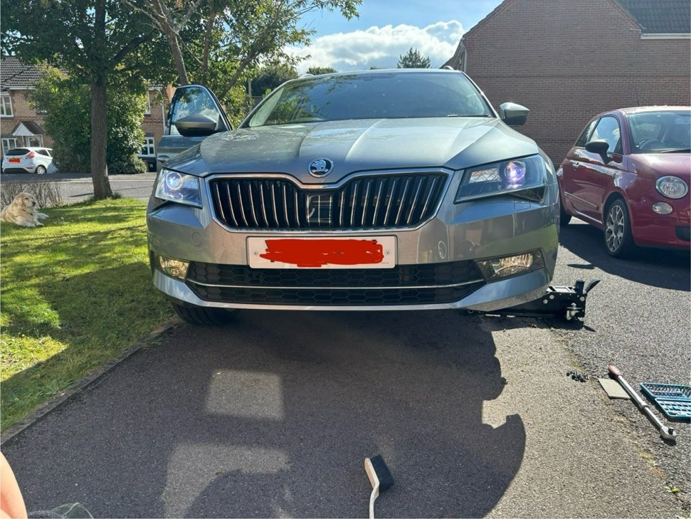

Moved front tyres to back and back to front, been meaning to do this and much easier with my newish 3ton jack as it lifts the entire side up, unlike my old crappy one

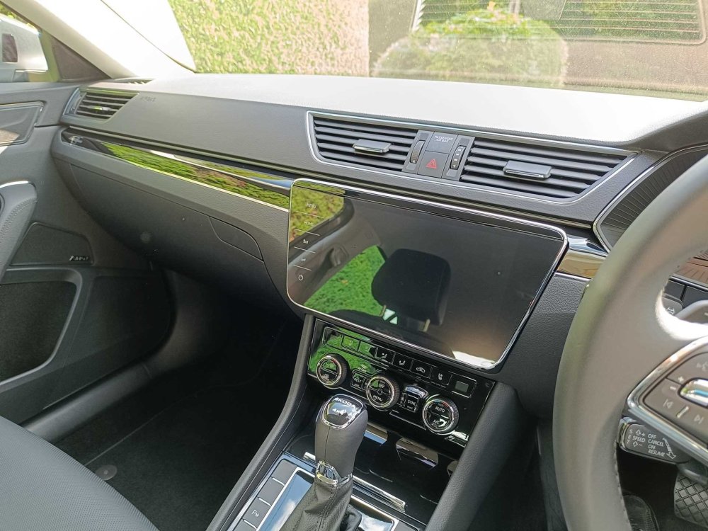

Popped a protective screen cover on the Columbus and no bubbles or dirt. 😃
I do clean it a lot because the finger prints drive me mad, so this'll get scratched up from all the cleaning instead of the main unit
(I did initially see a dirt piece under it so lifted it up, dirt dabbed with supplied sticky thing and it went back down clean)
