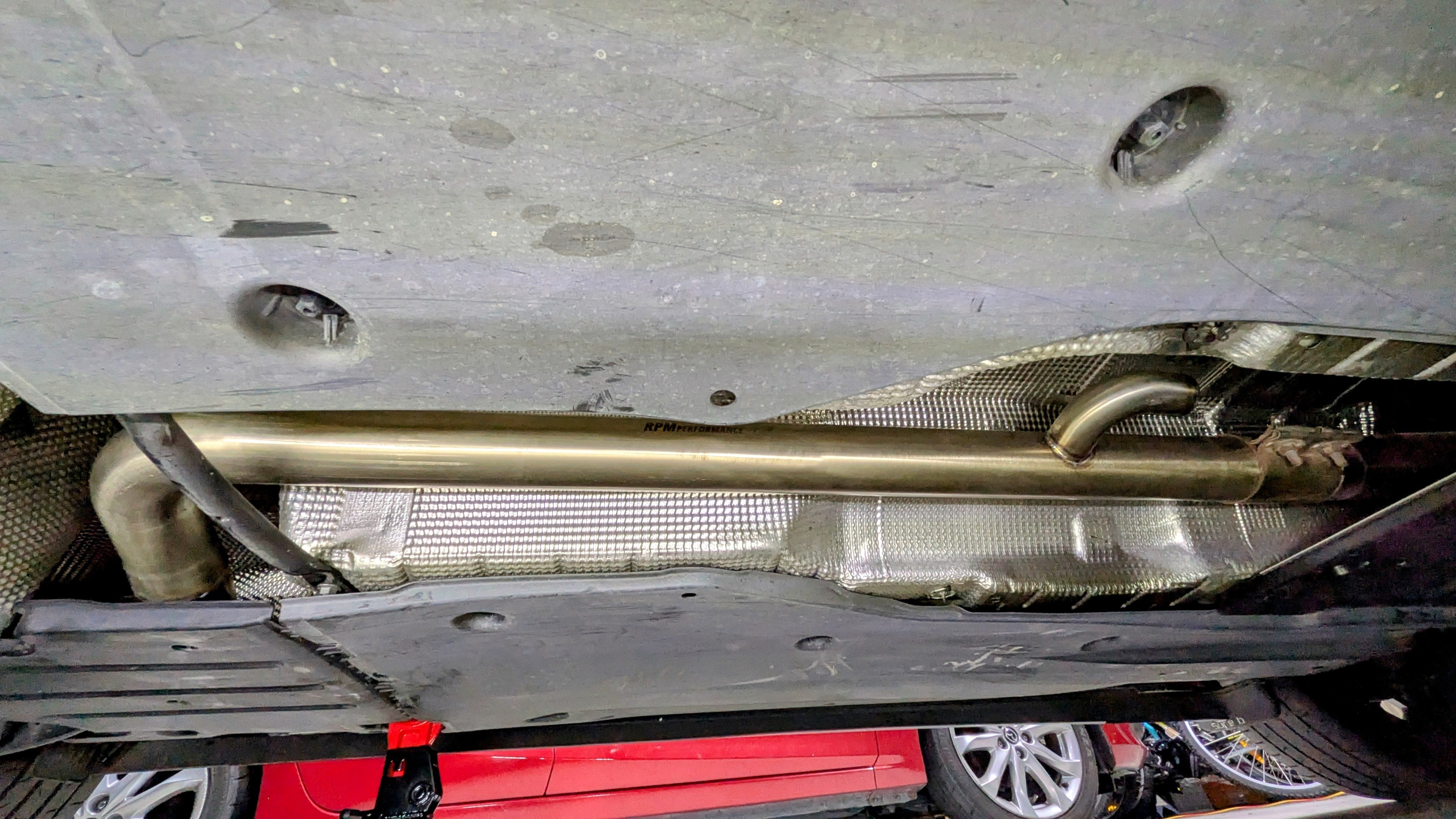

Had an RPM Performance Anti-drone Resonator Delete Pipe on Gandalf earlier this week.
Overall happy with the end result.
The pipe....
Fitted....
Video after fitment...
More details and pics here.

Sounds good - anti drone is always a nice touch!
Yup, I'm so pleased that there is no drone at all.
All the local exhaust shops near me weren't interested in fabricating one for me saying the anti-drone J-pipe is just a gimmick and will never work properly.
