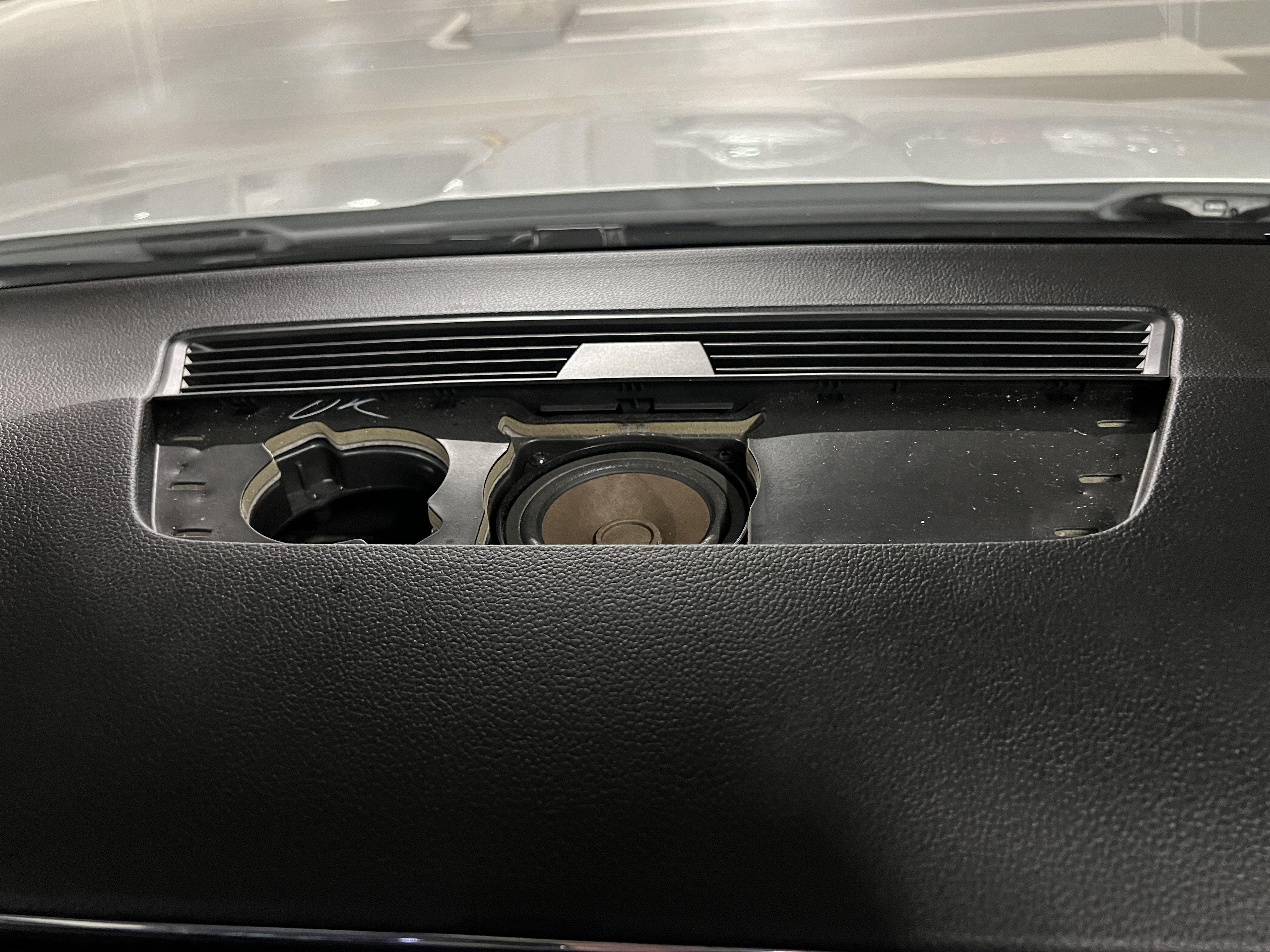

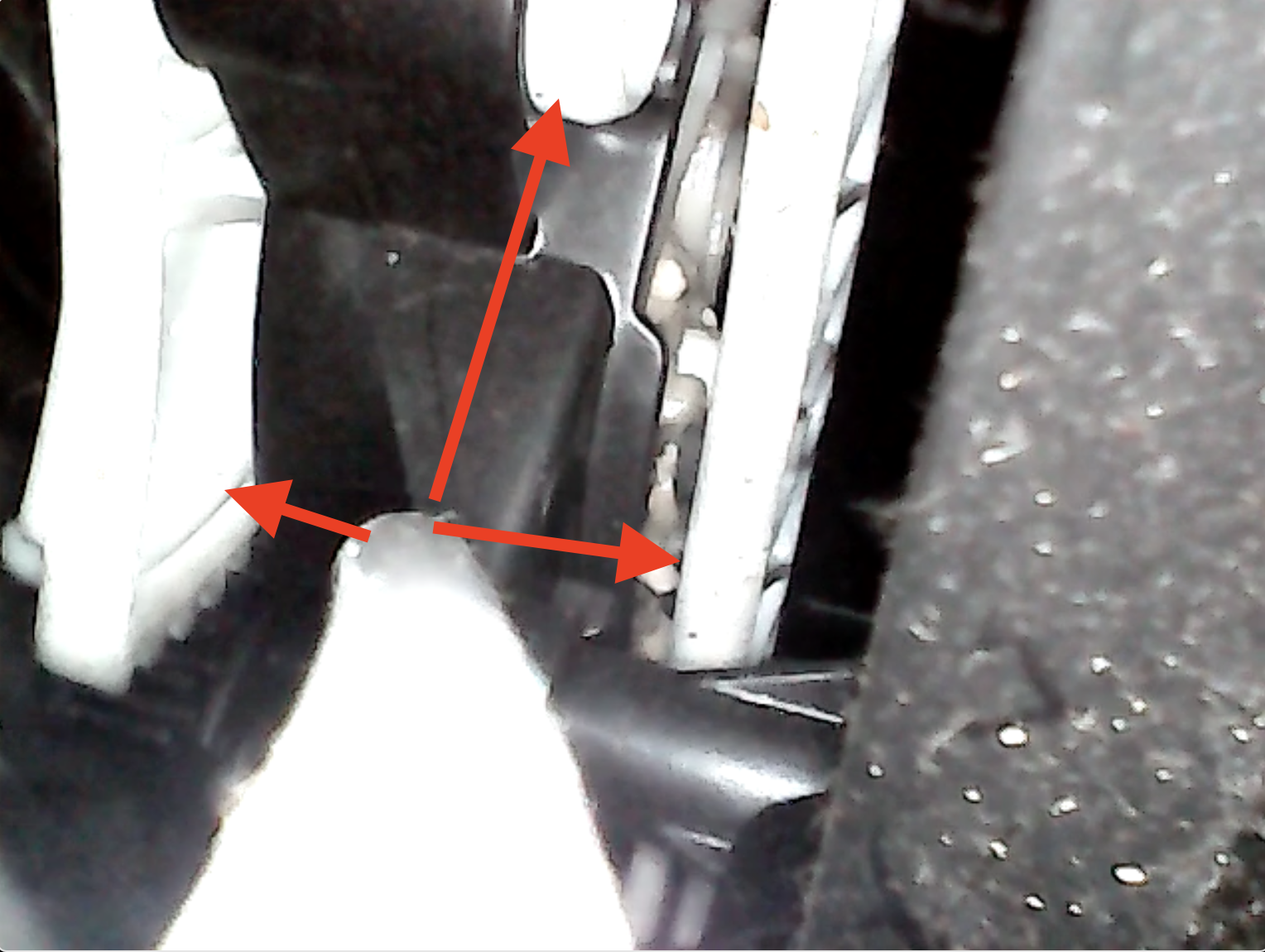

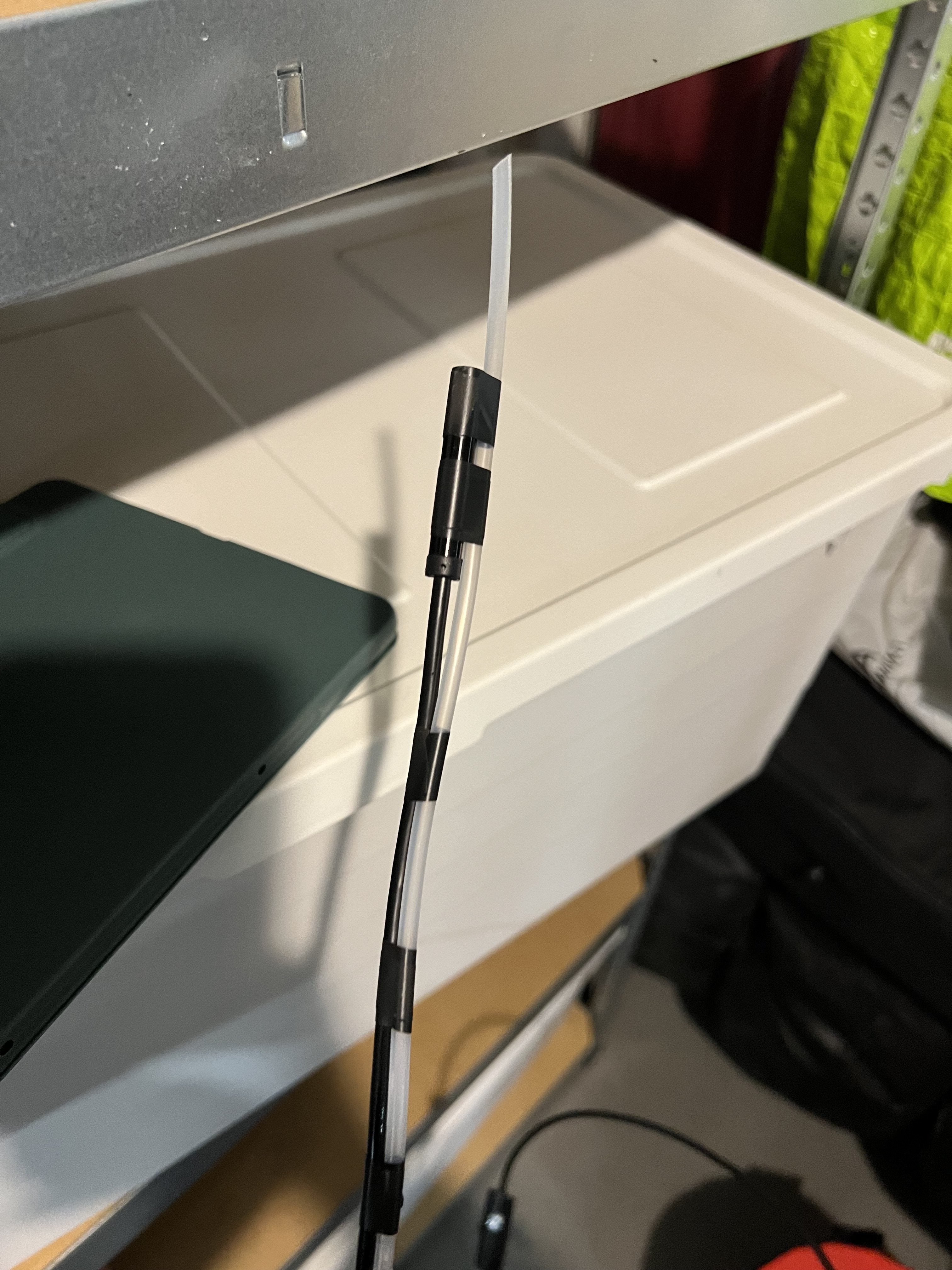

The climate control mechanism started making noise. I removed the top cover of the speaker, made a tool from a cheap endoscope and a Cilict Bang tube, lubricated the white mechanisms with silicone grease. Now the noise is gone.

Put grease on white mechanism. You can reach it through left or center hole, in case you have a speaker you can remove it(left speaker mounted by 2 screws, center speaker by 4 screws).
Once you reach white mechanism, hold tube and spray silicon into the tube, then change flow direction and spray again. Do it few times.

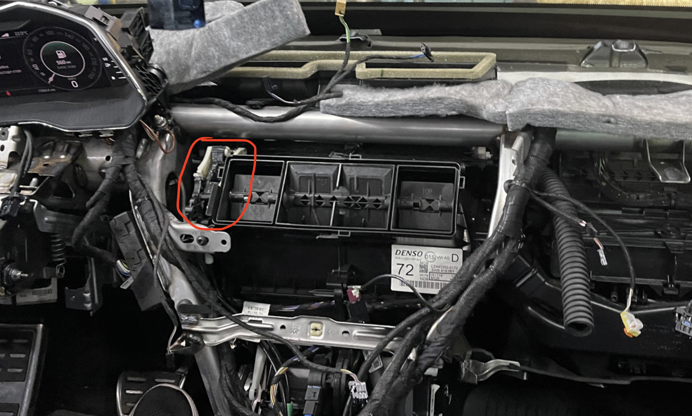

9 minutes ago, Graham Butcher said:
Where is this located? Is it under the centre speakers on the top of the dash?

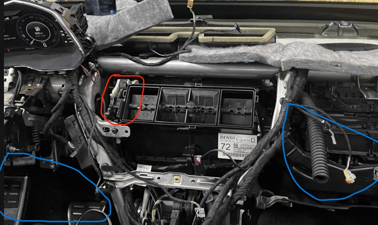

1 minute ago, zacko_O said:
Wow, thanks for the info, but I say screw that, I'm too old for those fun and games.
Well, I hope he wasn't hinting at removing the dashboard ... 🤪
I also would not want to do that! But the idea of squirting down there through the speaker hole might be sufficient ...
I may be wrong, hopefully someone will correct me if I am, but I that is tucked away behind the infotainment screen given the instrument cluster location, the foot pedals can be seen in the lower left and the small hose for the cooled glovebox on the right all shown in the photo?
dash.thumb.jpeg.821007704c9071f5db271c14b74c55c6.jpegScreenshot_9-10-2024_12628_www.briskoda_net.thumb.jpeg.ac0499d203ddd2f087ddb34c63b17f70.jpeg

Yes, try to change flow directions and probably you will hear noise.
I read few topics and for plastic gears it’s better to use silicone. So I used silicone spray.

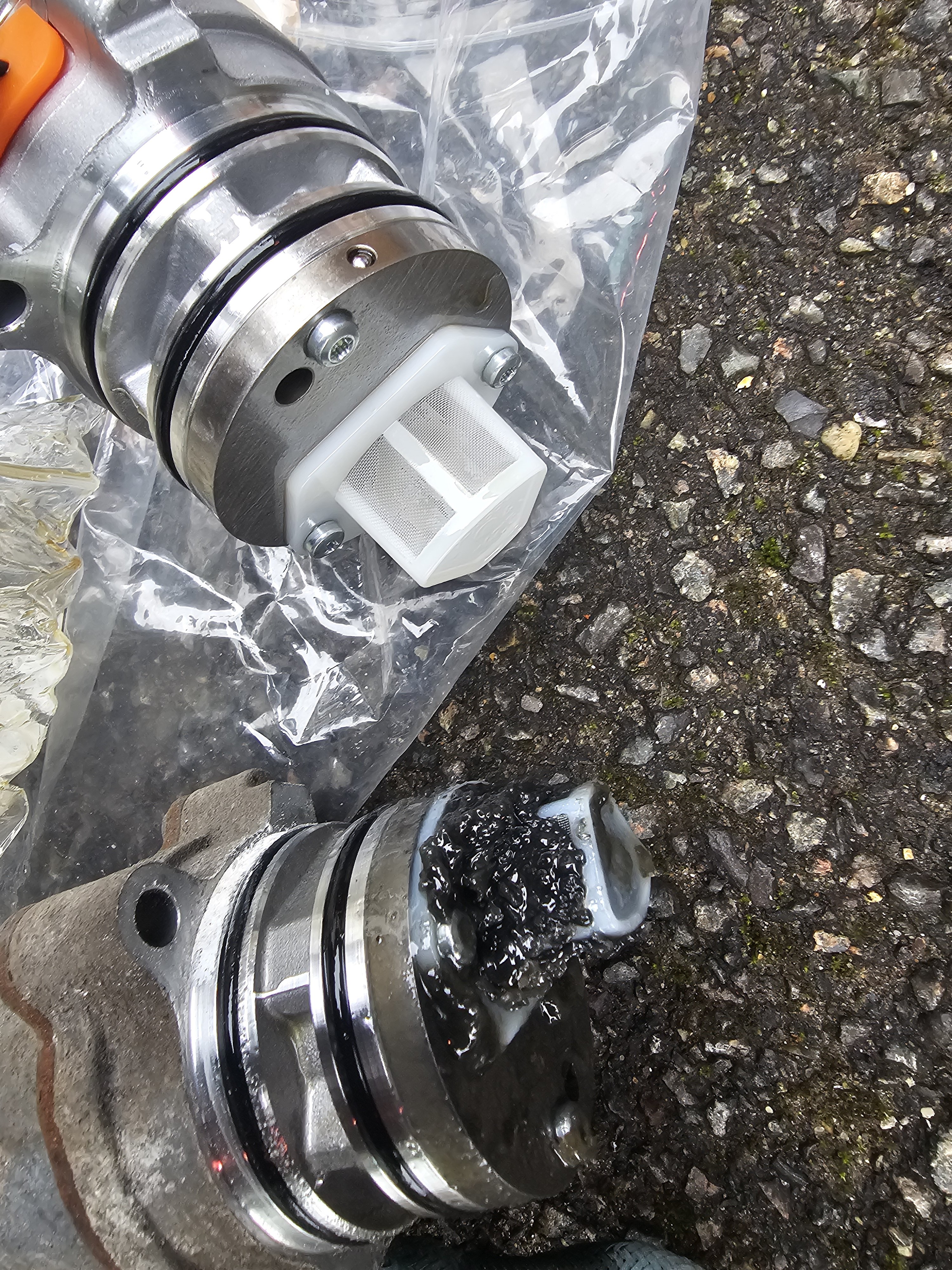

Replaced my faulty haldex pump today. Could have probably gotten away with just cleaning the filter, but since i made it this far and was prepared for the worst..
With the number of images of blocked Haldex pump filter screens posted, I cannot credit that dealers still claim that the service schedule does not require the screen to be cleaned!
