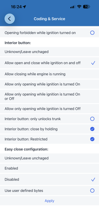

On 04/03/2026 at 19:26, Binx1310 said:
Ok. I have this obd module
https://www.amazon.co.uk/dp/B06XGB4873
And a pro license for carscanner (£8)
Set the mqb profile and connect. Bonnet has to be open and ignition on. Engine off.

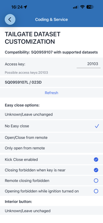

Select coding and service
Then luggage compartment
Then scroll to the bottom and choose tailgate dataset customisationIMG_0611.jpeg
Then click on choose other and select one of the superbliftback ones.
Then set the parameters you want and choose apply. (The open/close from remote should be selected)
You may need different settings if you have kessy or virtual pedal.
I have seen on another page that you have to hard reset through the long coding options for it to apply but it worked fine for me without this.
I have also noticed this evening that when you go back in to it it reverts to default rather than showing you your current settings.
I have tried this, and the boot will unlock only now with the button, does this mean I will have to do a hard reset? If so how do I perform this?
Opening and Closing via the Key works perfectly
Coding & Service, long coding, 6D. Boot lid, scroll to the bottom, hard reset. PS I accept no liability for your meddling!
Edited by Binx1310
Hasn't made any difference, gah
Perhaps try an alternative lift back dataset. And go through and check all the settings again. It’s as if the code for unlock only is displaced to the selection you have made.
Edited by Binx1310

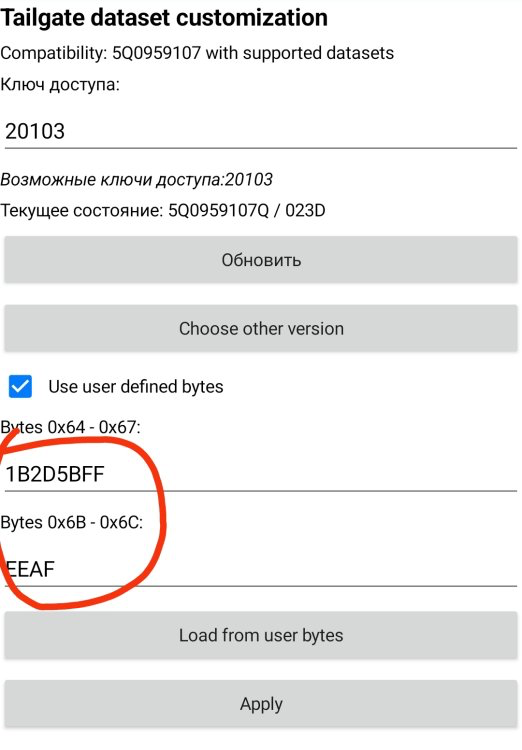

Yeah I don't have that - choose other version
This is what I see
4 minutes ago, tombee said:
This is what I see
Oh. How strange. you have a different parameter version. But this screenshot from @igrozan may work.
Click on use user defined bytes at the bottom then enter the same codes and apply.
Boom, that works, thanks for that
