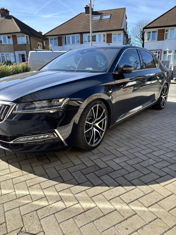

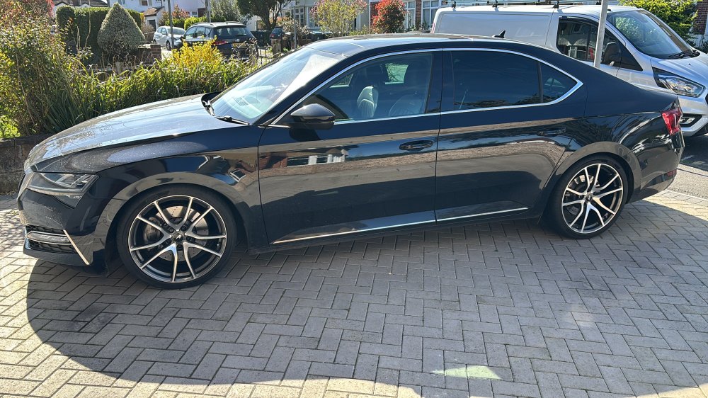

    Had the wheels refurb'd... and new centre caps and new tyres all round. Much much nicerer. Before and after

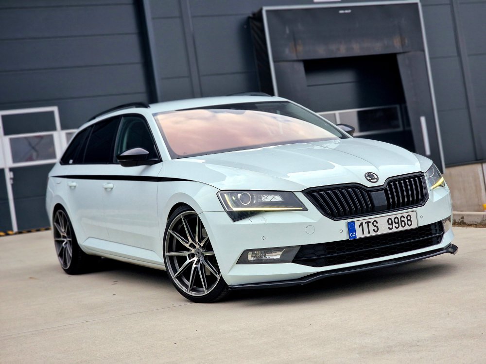

Added some vinyl stripes on the side and fitted front splitter
Why do people post pictures like this! Now my bank account is going to take a hit trying to replicate this!
Would love a full list of mods. It looks awesome!

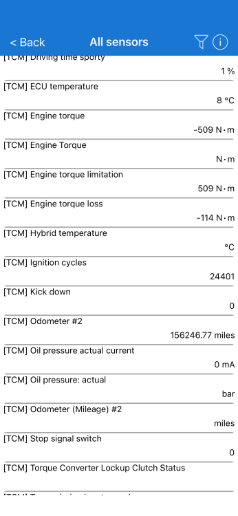

What a roller coaster. Locking wheel bolts have been removed. But the replacement supposedly OEM second hand standard bolts I got from eBay are not correct. So new being sourced. £10 to lost to idiot tax.
Just had a call to say that now they have the strut out the shock has some evidence of leaks and did I want it changed. Well while they’ve got it out I might as well. And all this with a full service next week. It’s going to be an expensive month.
Curiously, new sachs shocks and strut tops were supposedly fitted 20,000 miles ago. Is it likely they would fail that quickly? Or am I now back to the original theory that the car has been clocked and is actually 30,000 miles more than the dash says due to the odometer on the DSG being more. In which case the suspension may have 50,000 miles on it which feels more realistic as to the wear and tear on it.

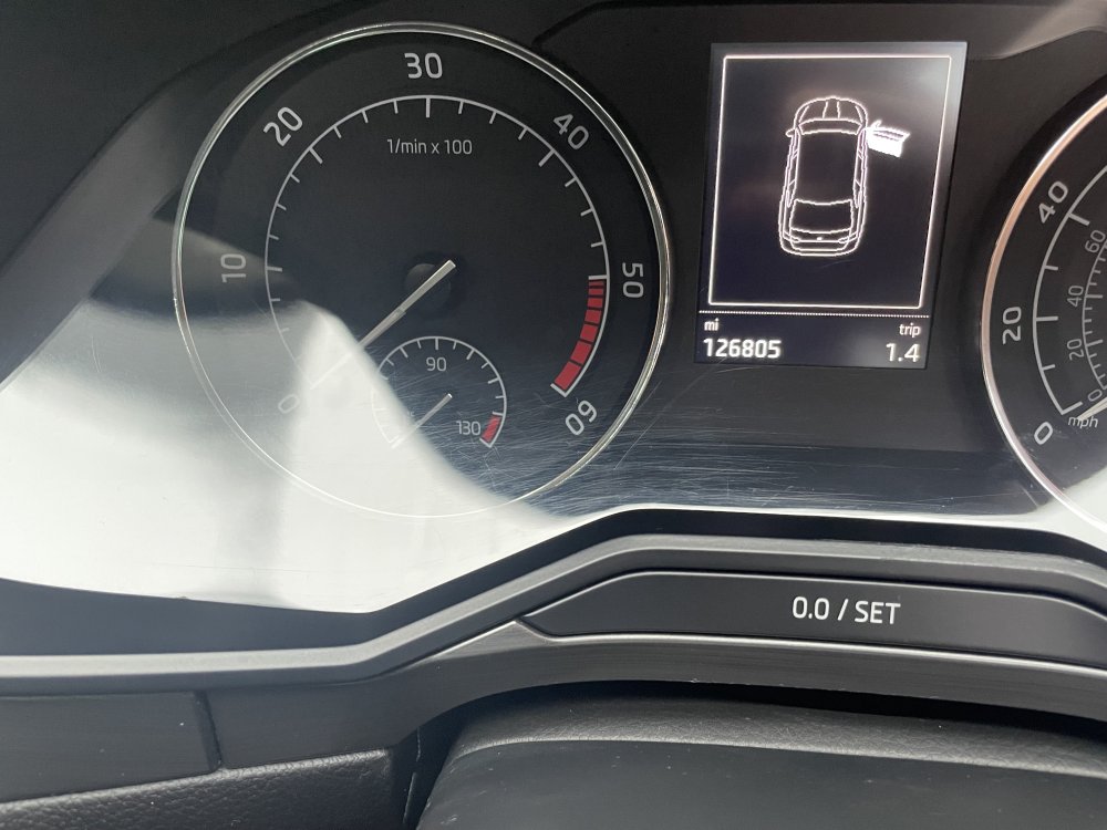

You have a VAS Dongle? Then i can check it
I don’t. But according to carscanner app the dsg odometer is showing about 30,000 more miles than dash which matches all other components with odometer readings.
At the end of the day the car is mine now. Out of warranty and I suspect there’s no comeback on the independent trader that sold it to me really. It is what it is. I’m going to keep it until it dies is the plan so service it well and keep things fixed as they crop up.
Edited by Binx1310
The online MOT history could give you a good indication of the true mileage. There maybe one year that stands out about 30k less than the norm.
I checked all that before I bought and looks ok. Service history mileages seem to match up to mot history. There’s a couple of years where it only did 2000 miles or so but from what I can make out it was sat on a forecourt waiting to be sold. I just find it curious the dsg and ecu have different ignition cycles and odometer readings. Unless it indicates something on the dsg has been changed at some point

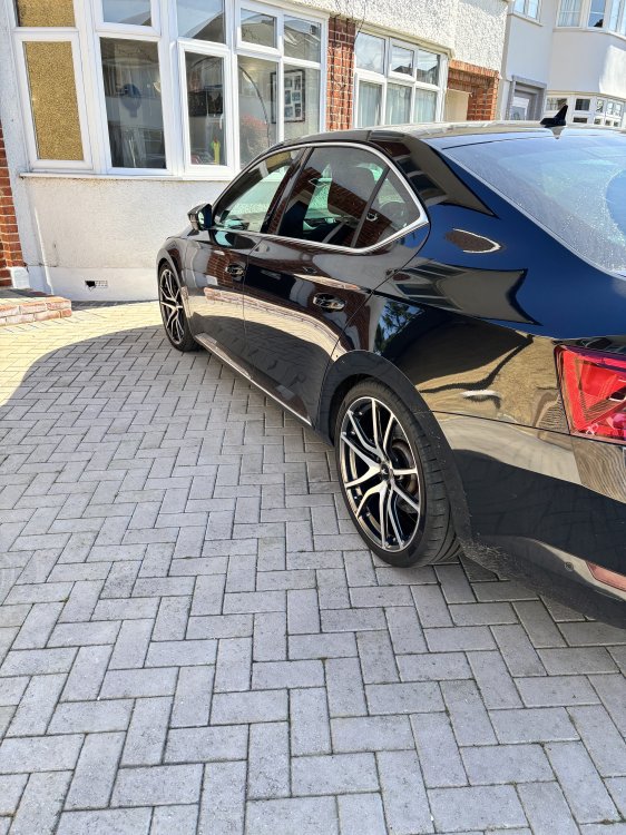

Couldn’t pass up the opportunity to put new wheels on when they came up. Given the temps are settling out of winter then it was time to get them on.
(Yes the car needs a wash!)
I like those on the car, nice one
