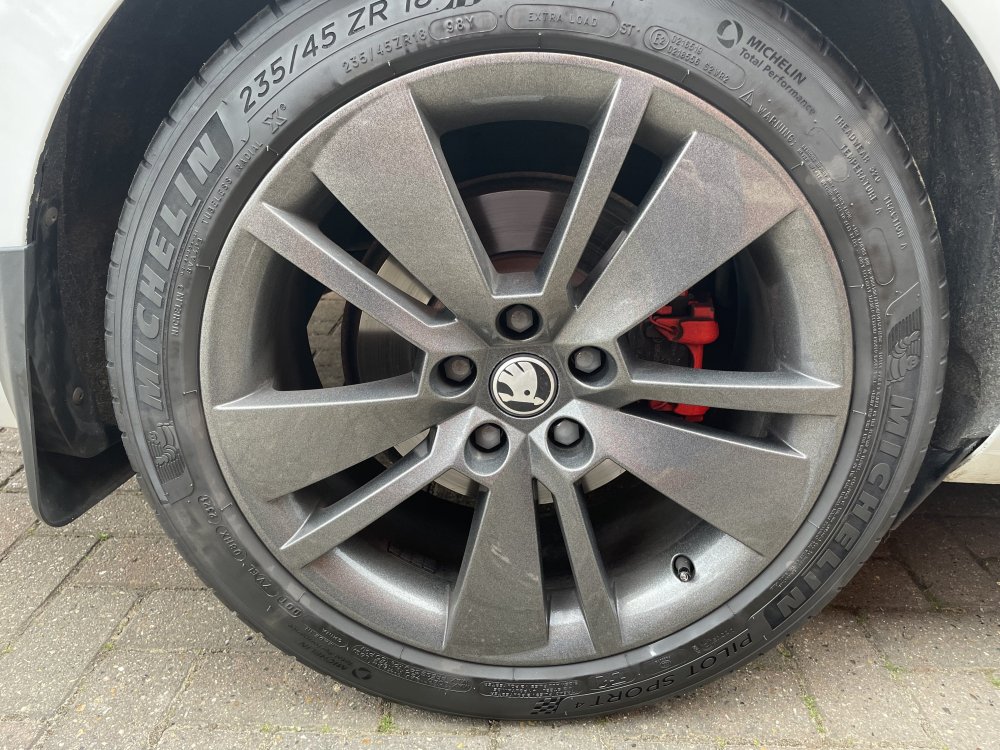

    Had the wheels refurb'd... and new centre caps and new tyres all round. Much much nicerer. Before and after

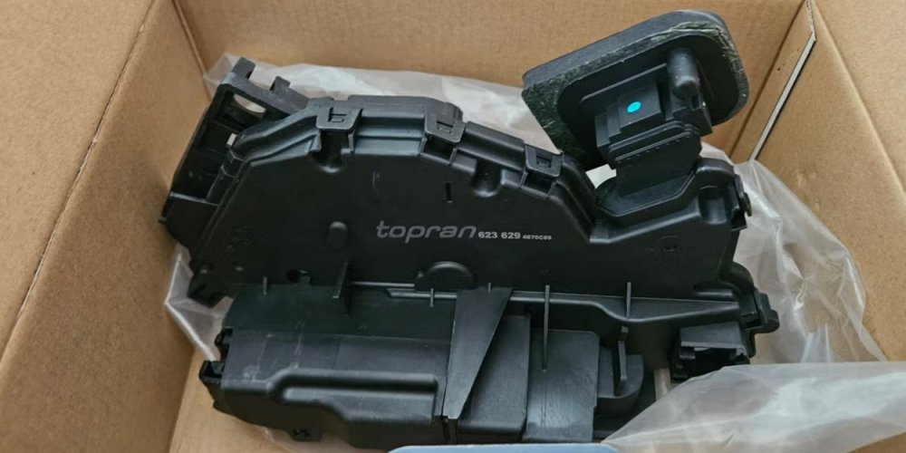

Škoda Superb L&K 2018 - The driver's door no longer locked. A new lock was ordered, Topran 623629 - Price €39 and replacement €90. Now everything is OK! )

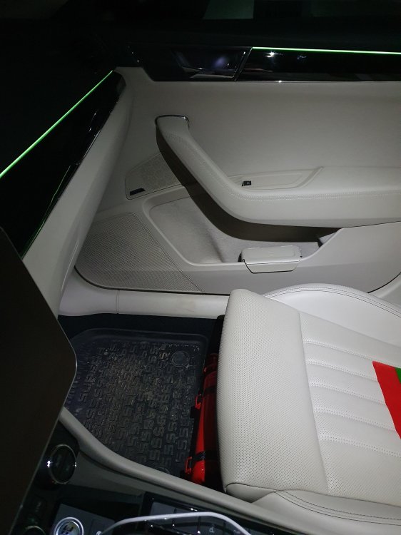

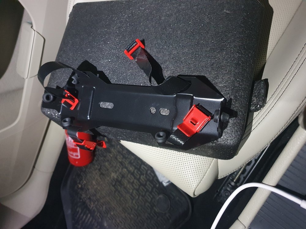

This was long in the making, but finally today I put my will into it.

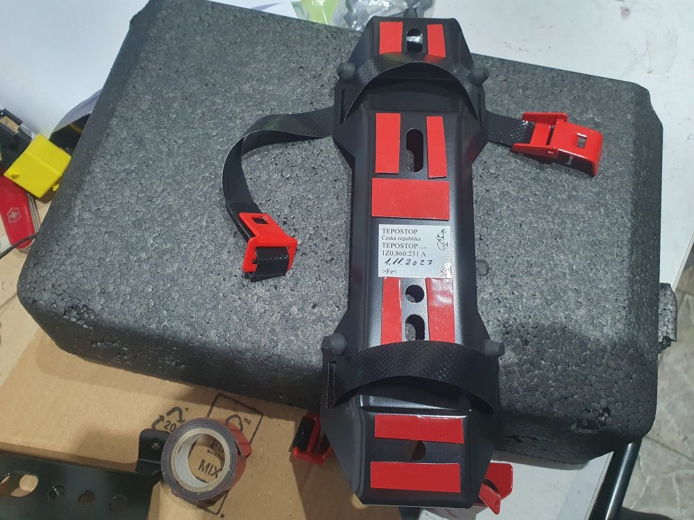

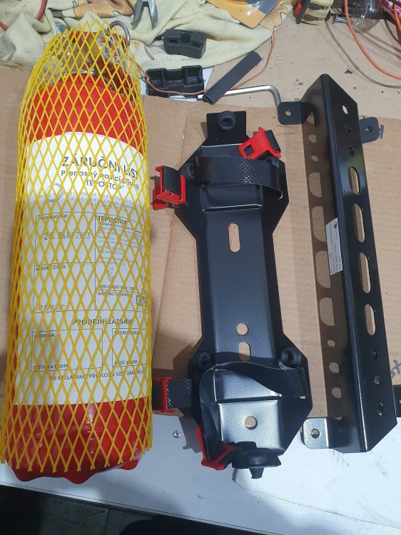

Been wanting to find an accomodation for a fire extinguisher (here compulsory by law) for a long time. Not to have it swinging around, I've looked into the accessories' catalogue options, and I got the relevant parts:

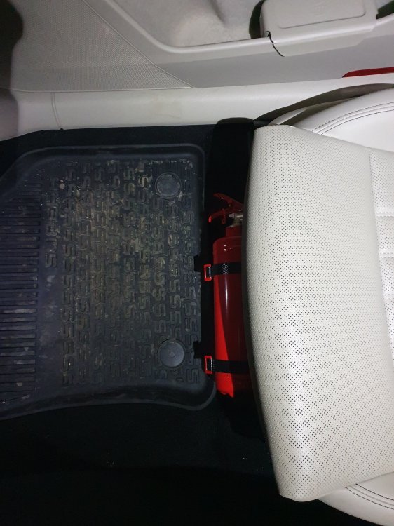

Of course I realized late that this somehow is not correct for power seats, and especially with the Canton amp under the driver's seat ... so after some mumbling, I decided to use the area under the passenger seat where some foam cover lies, housing come ECU.
Too flimsy to be drilled, I used double-sided tape.
Initial test showed that A: the fire ext. needs to be with the nozzle "down", otherwise it interferes with the seat, and B: when the seat is moved fully forward and it is in the lowest position, it drags the thing until the tape gaves and the thing rolls on the mat 😁
So I solved the problem with turning the unit, moving it a lil more forward, putting some duct time around the cradle and around the foam for extra-safety, and leaving the seat a little raised ... will see how it goes, and report.
The other bracked I did not need, as it fixes to the floor, but I will think of some other use ...

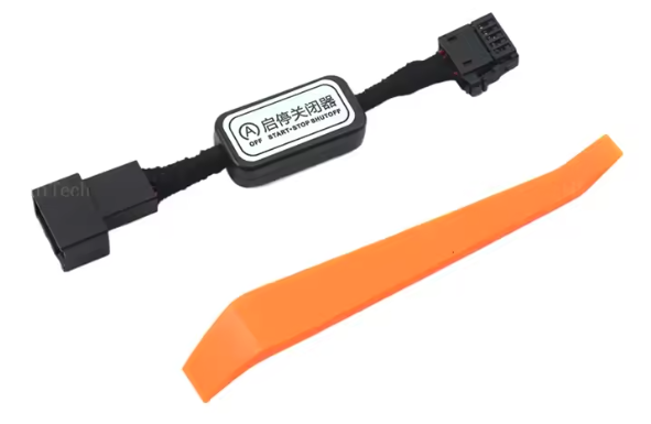

Today I fitted one of those memory modules between the loom and the stop-start activate/deactivate, so that it will stay deactivated by default.
Very easy to fit, surprisingly easy to remove the button bank on the right hand side of the DSG shifter. Only challenge was gettting it back in. There's enough room for the extra wiring, it was just getting the hard plastic bit in the middle of the memory module cable to go around the bend and into the cable channel.Screenshot 2026-04-07 at 16.58.38.png
With a bit of wiggling and encouragement it soon went into the channel and I was able to pop the button bank back into place

It’s a bit easier to lift the whole gear surround area up to rearrange the wires. It lifts from the front first and the orange tool that comes with the memory module is perfectly sized to prise it up.
The modules work well but I noticed if I turn it back on in traffic it deactivates s/s everytime it kicks in! So have to keep deactivating it. I’m not in traffic often so the positives massively outweigh the negatives.
I considered it, but lifting the whole surround would have left me with the same issue. If anything, it would have made manipulating the module cable to go down and then 90 degrees into the cable channel a little bit harder as I would have had even more trim in the way of my fat fingers. It just needed wiggling and eventually slotted into place allowing for the buton bank to slot back in without any force. I'll see how it gets on, but as I wouldn't turn it back on mid drive anyway (the whole point is to keep it off all the time) I should be OK as long as it doesn't malfunction.
