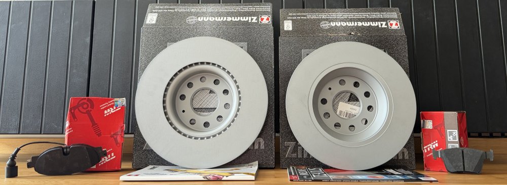

Today Škoda Superb L&K 2018 140kw 2.0 TDI 4x4 car had rear and front discs and rear and front brake pads replaced.
New discs from Zimmermann
Front: 100.3300.20
Rear: 600.3252.20
Total: €172.81
New brake pads from TRW:
Front: GDB1956
Rear: GDB1957
Total: €55.12
Discs and brake pads in total: €227.93

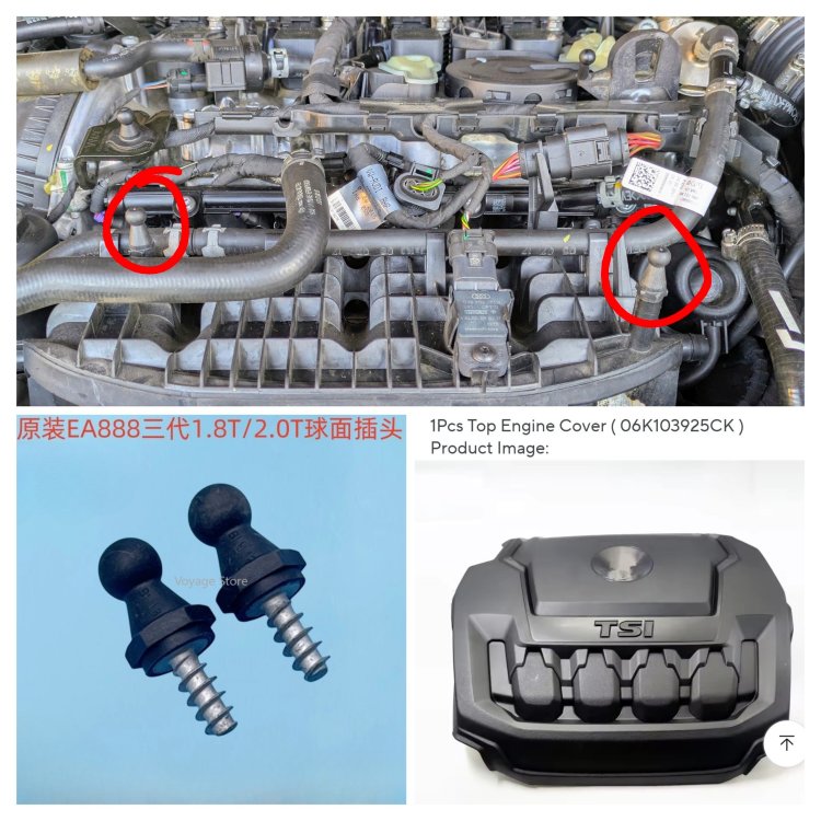

For those interested, the EA888 Gen 3B engine cover fits nicely on pre-facelift Superb.
U just need 2x engine cover ball studs (WHT007324) for the engine cover.
It screws into pre-existing mounting holes on the intake manifold.
My original engine cover had APR badges on it which was no longer relevant, so I ended up replacing it with the Gen 3B engine cover version.
The two ball studs screw into pre-existing mounting holes on the intake manifold.
Engine cover part no. is 06K103925CK.
I stuck a Skoda badge on top of the VW logo 😁

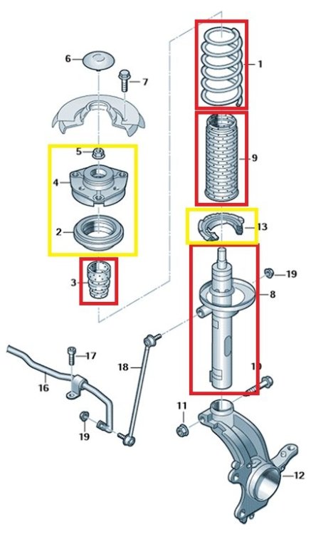

I need some good advice. It was recommended to replace the front shock absorbers and ball joints. I thought I would look into what is a good practice to replace them. I was told that I should also consider replacing the coil springs and dust covers with new ones. Is there anything else? I have attached a picture of what the area requires and what I am currently considering replacing (in the red box). Is it also a good idea to replace the parts in the yellow box?

When I changed my shocks to B6's I did springs, dust covers, top mounts, nuts and bolts basically anything related was replaced with the old stuff thrown in the bin

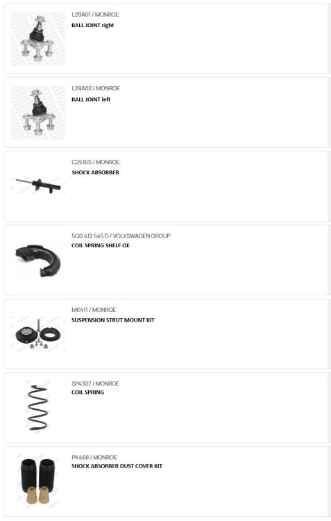

Thank you!
I made a list of what to change.
