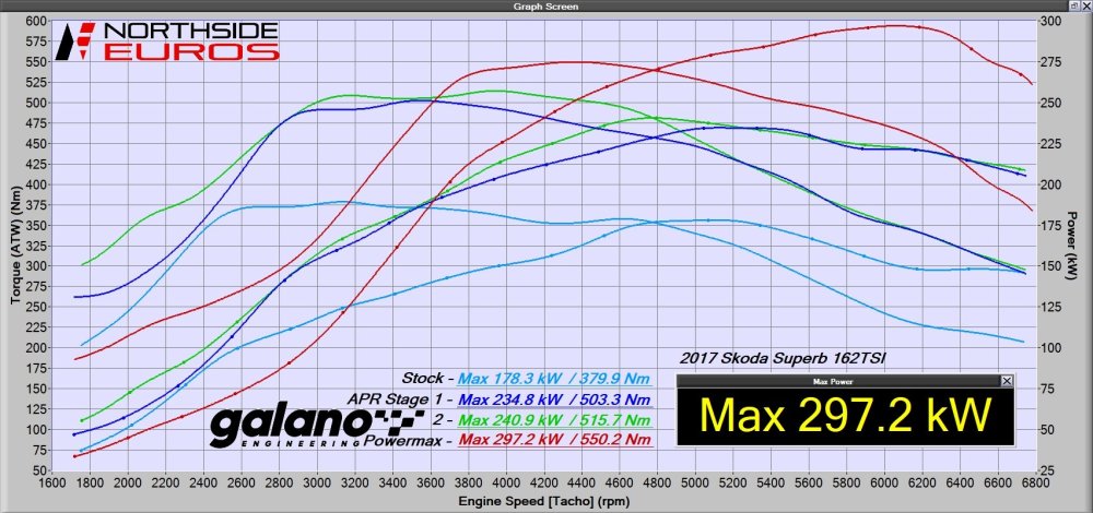

It's still early days, but it just keeps pulling and pulling and pulling.
Dyno reveals a nice healthy 297 kw (403 hp) 550 Nm at the wheels power.
Mine being a FWD, the Galano boost-by-gear is working overtime, but doing a good job, to put most of that power through the front wheels.
The car can break traction in 3rd gear if push really hard!!

Dyno....
23832416_John Rappai Superb 162TSI Stock vs APR vs FBO vs Galano vs Powermax Final.jpg

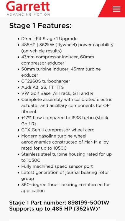

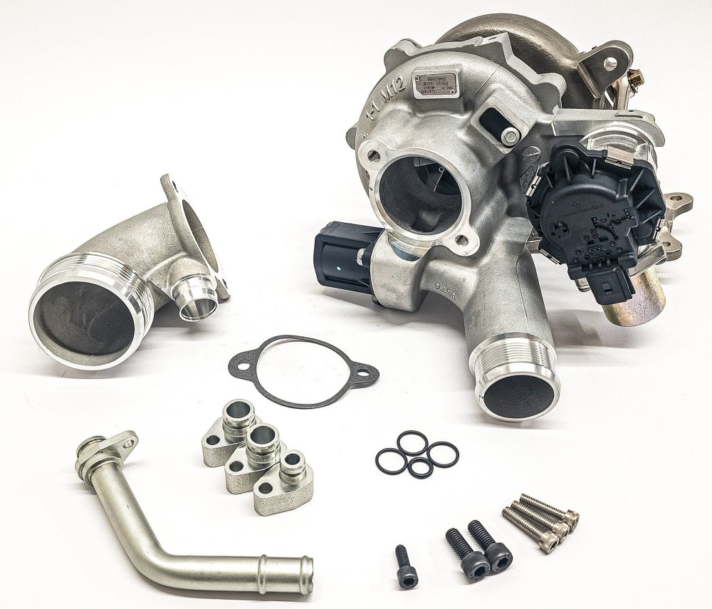

Pic of the Powermaxx turbo n the bits it came with...
Marketing of the Powermaxx turbo.....

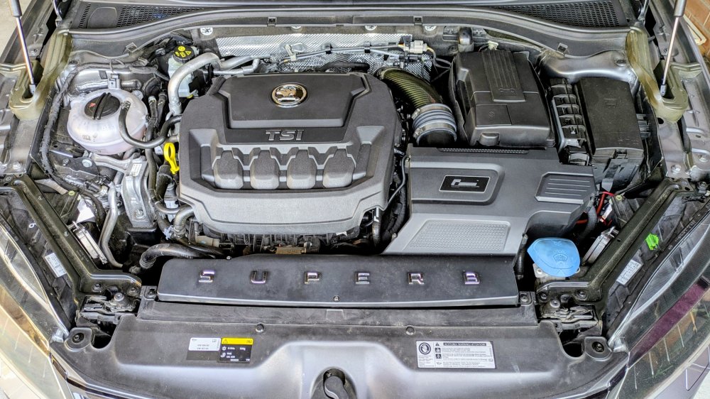

My original engine cover had APR badges on it which was no longer relevant, so I ended up replacing it with a EA888 Gen 3B engine cover version.
It fits just fine, just needed to add two ball studs, WHT007324. The intake manifold already has mounting holes for the studs to screw into.
Nice n easy.
Engine cover part no. is 06K103925CK.
I stuck a Skoda badge on top of the VW logo 😁
Edited by JR RS

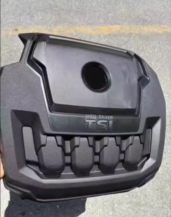

On 09/04/2026 at 09:12, JR RS said:
also habe ich sie schließlich durch eine FL-Motorabdeckungsversion ersetzt.
That's not a Superb facelift cover, it's from a Kodiaq. I had that one on mine back then, too.
My bad....I should've said EA888 Gen 3B engine cover.
I incorrectly assumed the FL Superb used the same cover.
I'll update my post.
It wasn't meant to be offensive. I just wanted to let you know.
No offense taken - all good 🙂
Thanks for pointing it out.

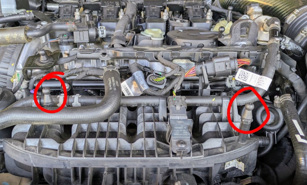

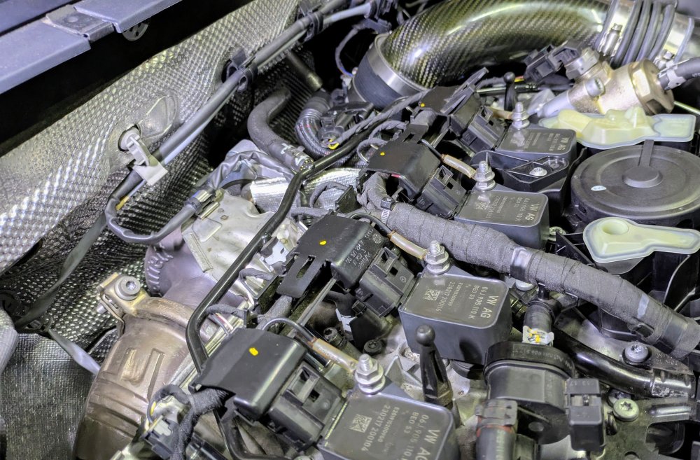

Another preventative measure tackled over the weekend - replacing the failure prone plastic coolant vent union adaptor.
The factory plastic adaptor, given it's location right next to the hot turbo, is prone to crack and failure eventually, resulting in coolant leaks or loss.
After 8 yrs, turns out the plastic adaptor on Gandalf was still in good condition, including the O-ring.
Replacement part is made of aluminium.
I got an 034 Motorsport version, but there r plenty of other options.
Whilst I was at it, I also changed the rubber hose pipe that attaches to it.
Changing it is easier by removing the coilpack harness out of the way so u can easily access the vent union adaptor.
That said, it is still a very tight spot being in the "valley"!!
Also, have a 1L bottle of coolant ready as u'll loose a lot of coolant in the process - hence u need to top up. In my case, G12Evo (G12E050A2)

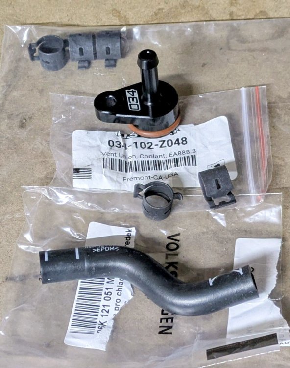

Part Numbers:-
  • Vent Coolant Union Adaptor - 034-102-Z048. Replaces factory part number 06K 121 143
  • Coolant Union Adaptor Hose - 06K121051M
  • Spring Clamps - N90686701
Replacement bits....

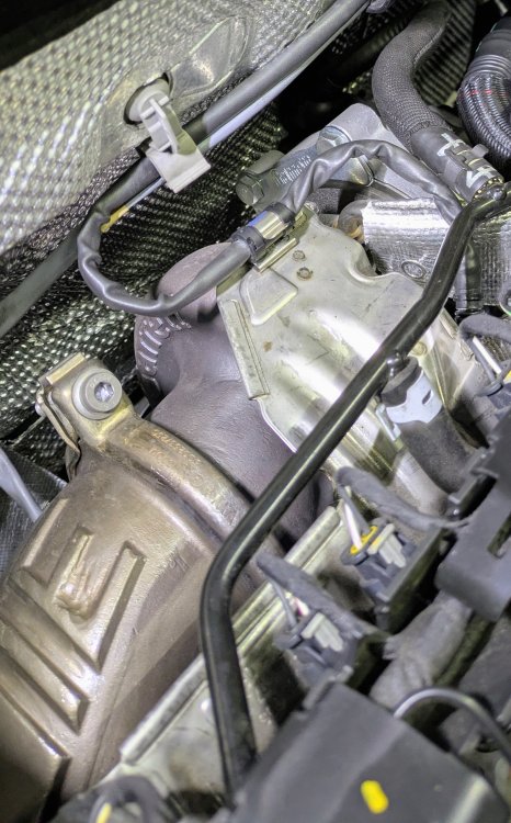

Comparison....
Factory one removed....
Aluminium replacement in place....
