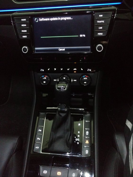

Plan B, home computer online Skoda portal download, input VIN as requested. Initial download is a proprietary downloader. Ran the Skoda downloader and it downloaded a 22gb zip file to the computer and then it asked for an SD card. Used an old Kingston class 10 U1 32gb micro sd in a full size adapter. Quick formatted it in Win 10 using FAT32, default allocation, (4k allocation is not even an option on win10) and clicked continue/unpack. Left for a couple of hours and eventually finished. Speed is limited by the class 10 card which limits writes at between 10 - 12 Mbytes/sec.
With car ignition off and Columbus turned off, (Sim was also still removed) inserted the SD card into SD1 position. Turned on Columbus (but not ignition). Went to Menu, scrolled screen and selected Settings then system, update (may not be the exact names/options, but you get the idea) Followed on screen instructions and left for about 30mins, update installed ok!
Note ignition doesn't need to be on! Portal download doesn't work with XP, I used Win10 (approx 1 year out of date)

Did the same this afternoon. Straightforward if a little slow with the unpacking ( 36bytes per sec).Took about 30 mins updating in the Columbus.
Well after reading a few threads on here I wasn't hopeful but just updated first time with no issues. SD card and about 35mins with the engine running.
