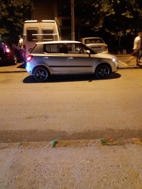

Hy plz can some one help me to solve problem with remote central lock sistem some time when i drive car locks the dors by it self and when i lock manual from buton from inside ,dors lock and unlocks alone ore when i close left dors it locks alone some times not always.... skoda fabia mk II 2009 1.2 htp i has also excalibur el.engine block sistem plz help i love this car.
Hava a look at the wires in the door bellow. They might be fractured and/or broken. Common fault fir mirrors and window faults but the locking system runs through them too!

The Fabia was equipped with a safety feature that the doors locked at around 10mph after driving away this sometimes gets confused and does random things if the system has a fault, most common was the drivers side rear door lock which can throw the whole system out of sync, but this usually shows up with the door staying open or locked when you unlock the car, if this is working ok like mine was I then took the drivers door panel off and checked the connections to the main lock unit which was slightly corroded so removed the plug cleaned the  contacts and used a smear of petroleum jelly and put back it together it's now working fine.
Ok i wil try all hope is  not el. Control unit
