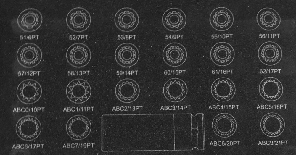

It is helpful if someone in a Dealership brings out the Master Set and checks which is required and orders one for you,
or you can identify the one required from a chart.

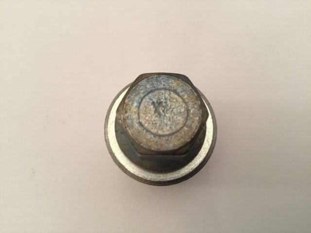

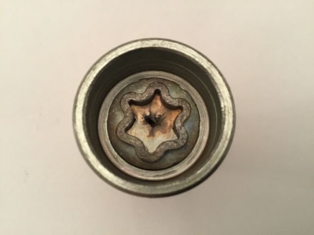

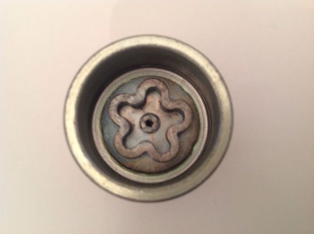

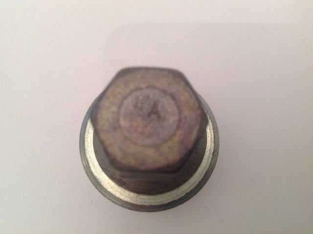

An simple idea would be to take a note of the letter stamped on the key and write it down somewhere safe like your manual. Or keep a photo in your phone
Key code A
The OP appears to have a Key code X
Edited by xman
I was going to say that my "5 lob" security key was E, but that A one has "rounded" lobs and my key has "squared" lobs, so to the OP make sure that you can spot the difference if the code letter is not quoted.

I'm not certain the OP's bolt is an X, his bolt appears to be totally symmetrical, whereas the X I've got isn't
So you are saying that while it looks symmetrical, it will only fit 1 or 2 ways - and not 6 ways?
No, I think it will fit in any position whereas the X one will only fit one way.

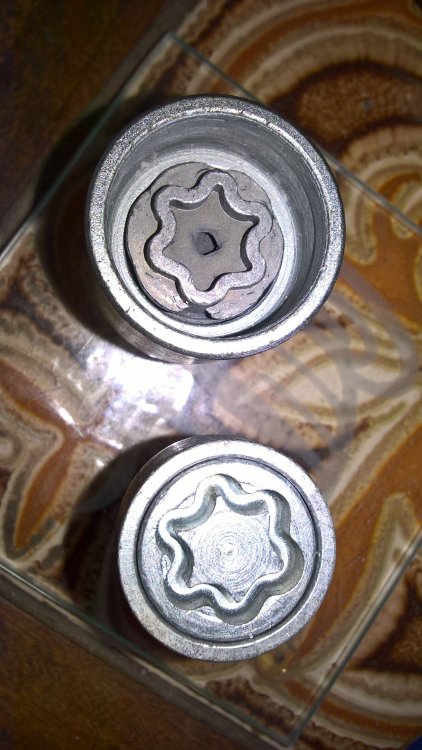

Hey everyone. Thank you for all of your suggestions. I ended up finding a website which were able to match my locking nut key from the picture above and have despatched it in the post to me. I needed to provide proof of ownership of the vehicle and identification. Although it did cost overall an eye watering £43. Safe to say that I won't be leaving this new locking wheel nut key on the side of the road again.
