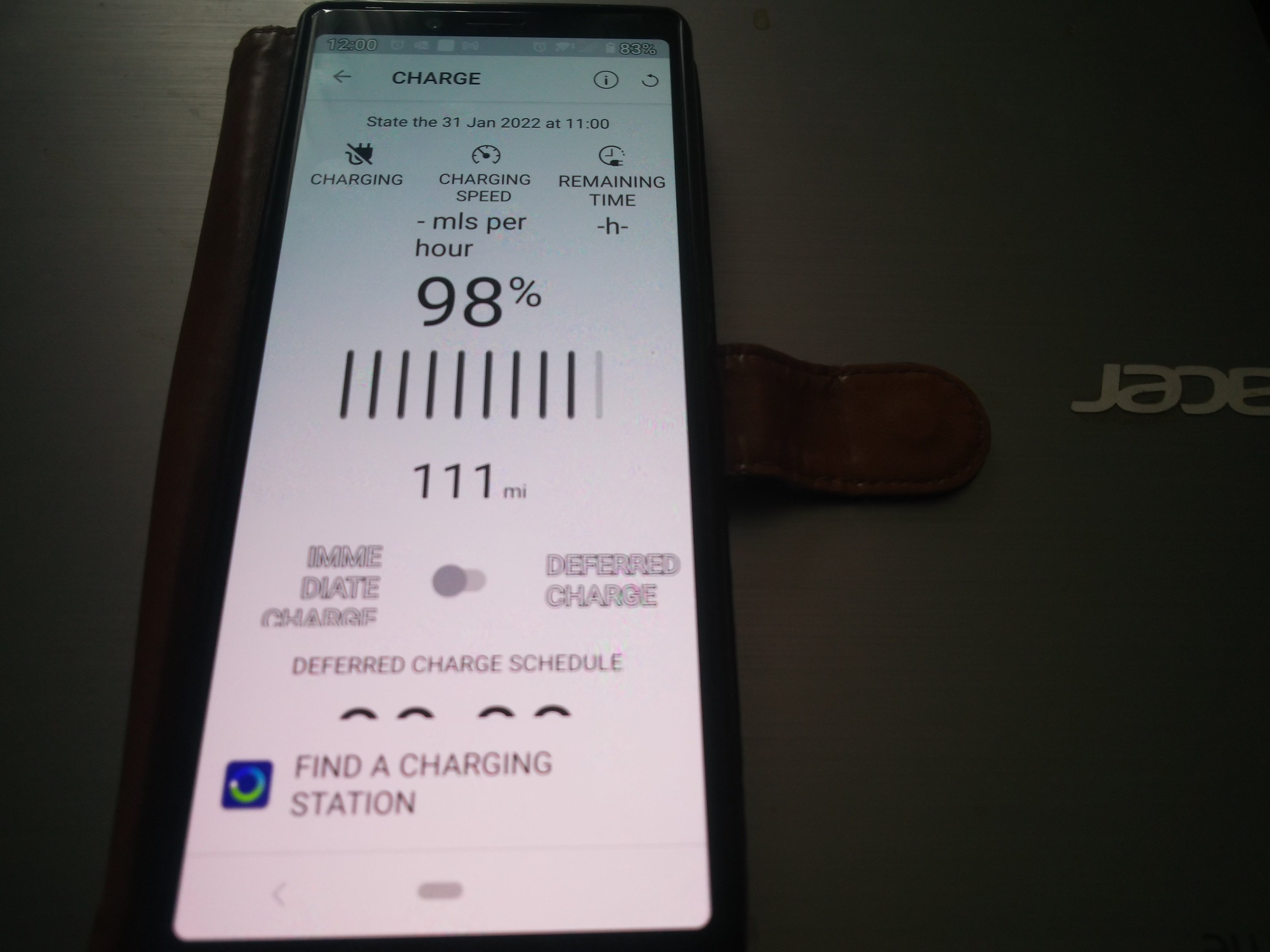

@lol-lolit requires 5 kW a day each day while the weather is at a temp below 10*oC or so regardless of if the car has 10% 20% etc showing in the battery.
It was just easier to check with a full battery and compare with a year or so ago when i noticed how much electric was required.
Really it does not lose / use more energy because the battery is fuller.
What i am comparing is the maybe 6 trips i do most days that sometimes would be on a bike or years ago i did in a Kia Picanto that could manage 42MPG with the same usage.
0.7 miles mostly down hill or flat going and 0.7 miles back on the flat & uphill.
Only difference ever is ambient temp, rain, snow, wind etc.
SITTING ON A 7KW Charger and getting 6.6 kW in the car is the same if the car is locked and no one in or if the Heater is up to 28*oC and the radio on and a phone plugged in and charging.
Same going in, 6.6kW for the cars battery.   I have tried to see more than a few times.
Out of town and different speeds is a whole different kettle or renewable electricity use.

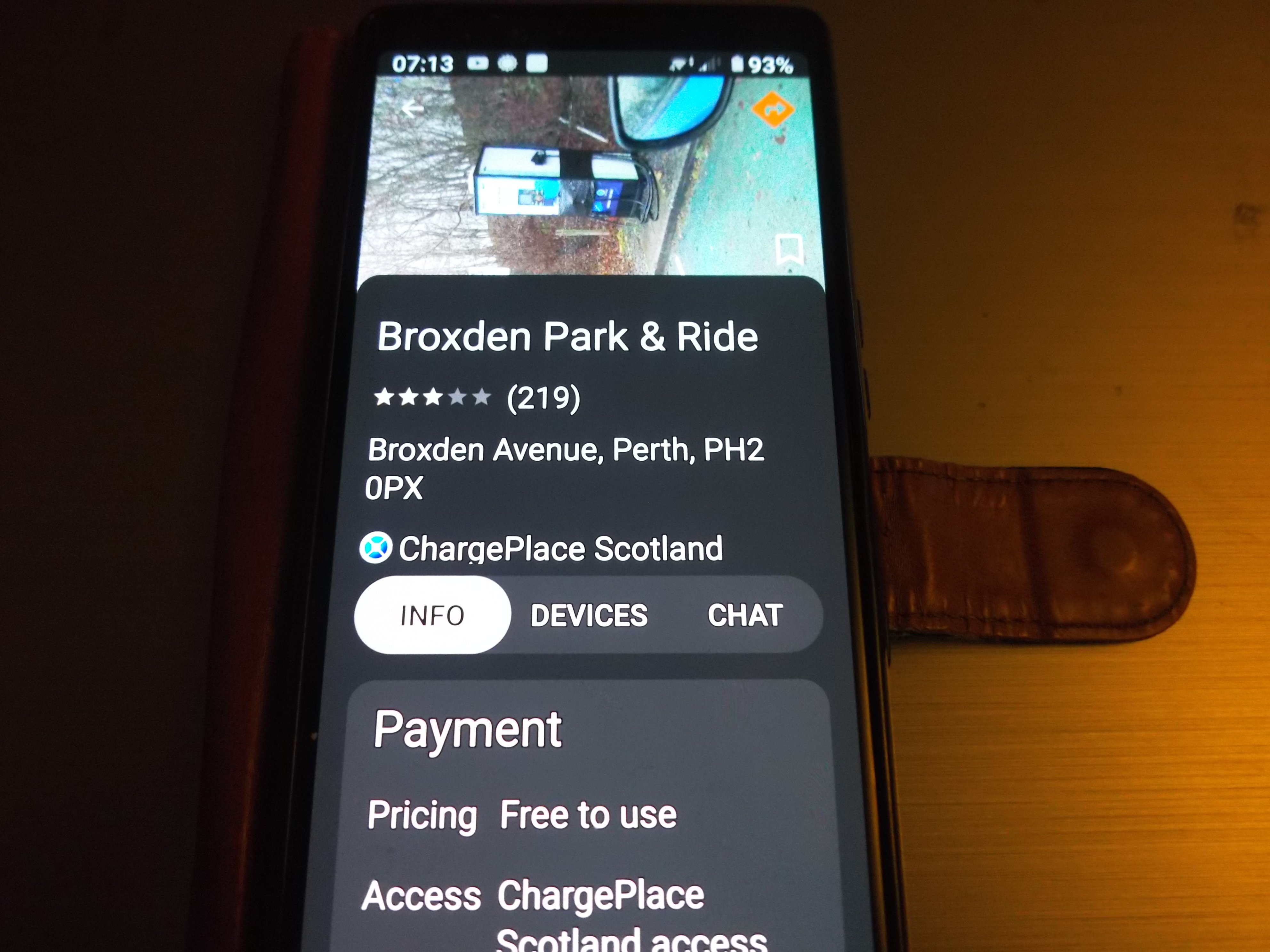

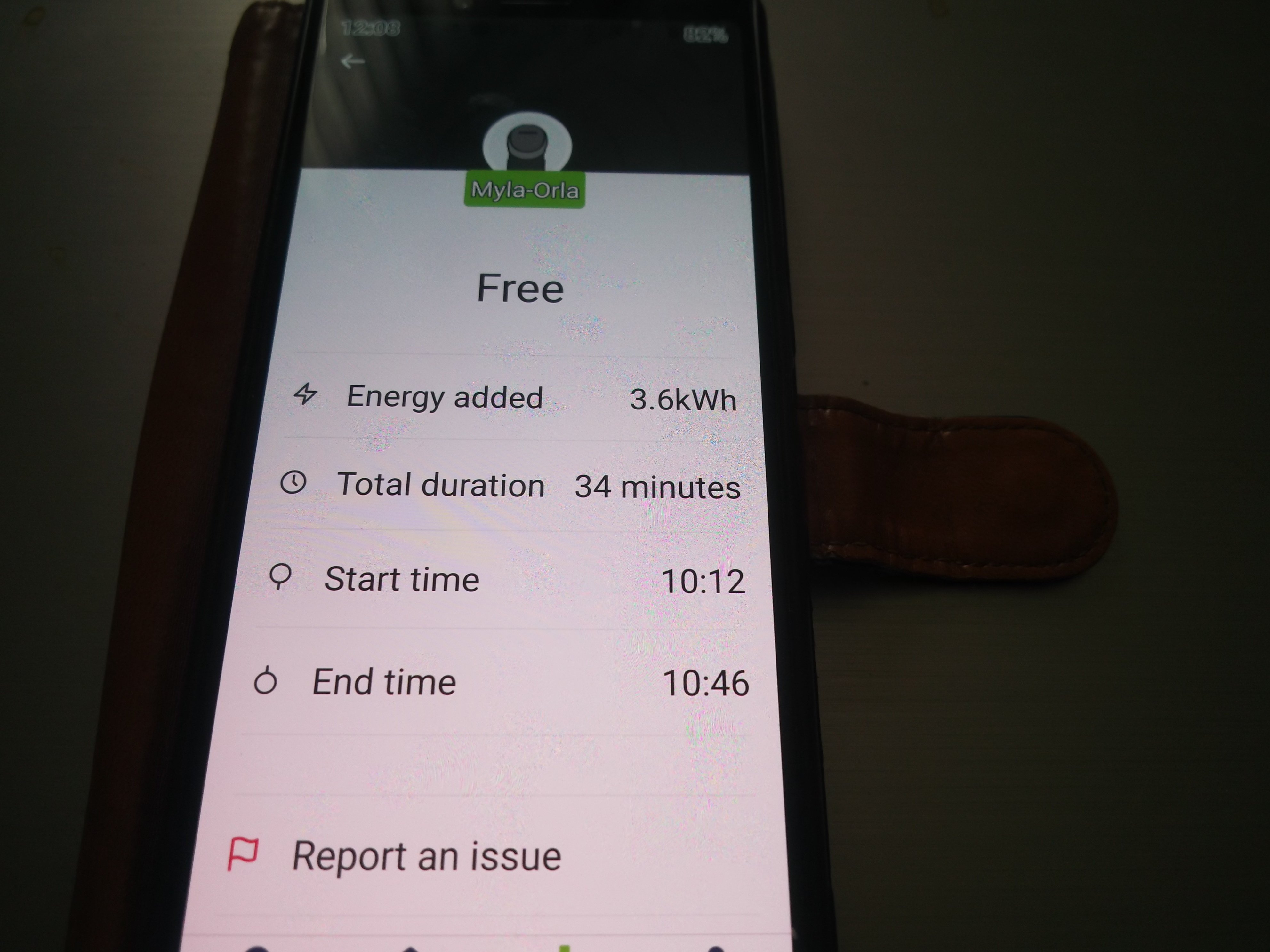

3.6 kW was what was needed to top back up to where i was yesterday and having driven 3 miles.
35 minutes on the 7 kW charger as charge confirmed after plugging in and getting back into car.    (Driven 1 mile since charging to 99%)

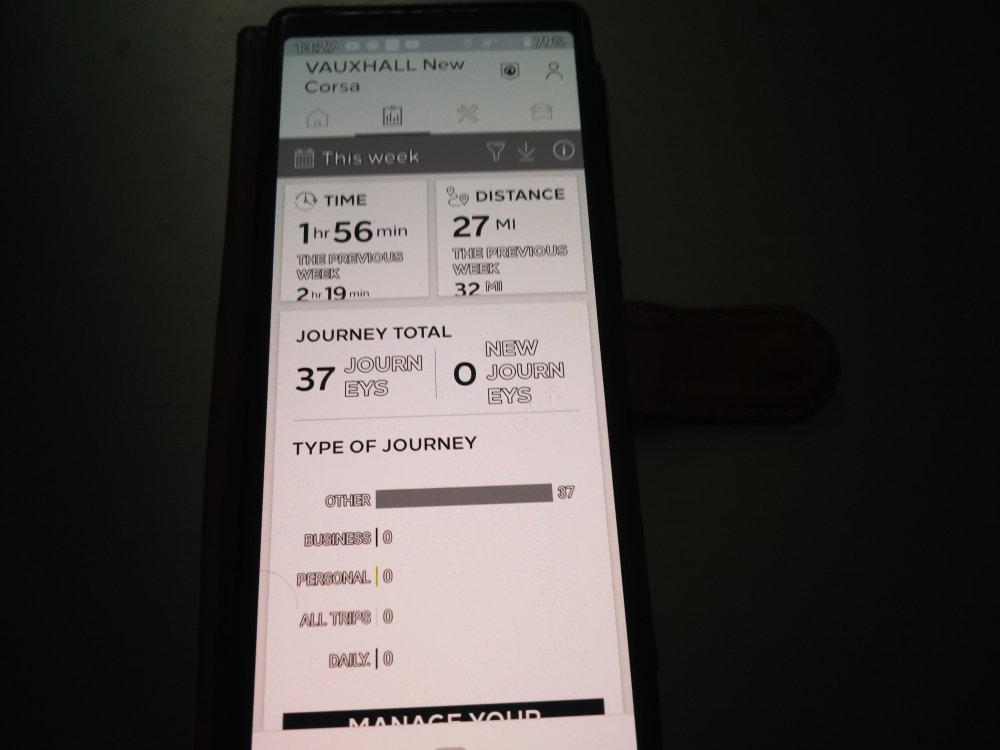

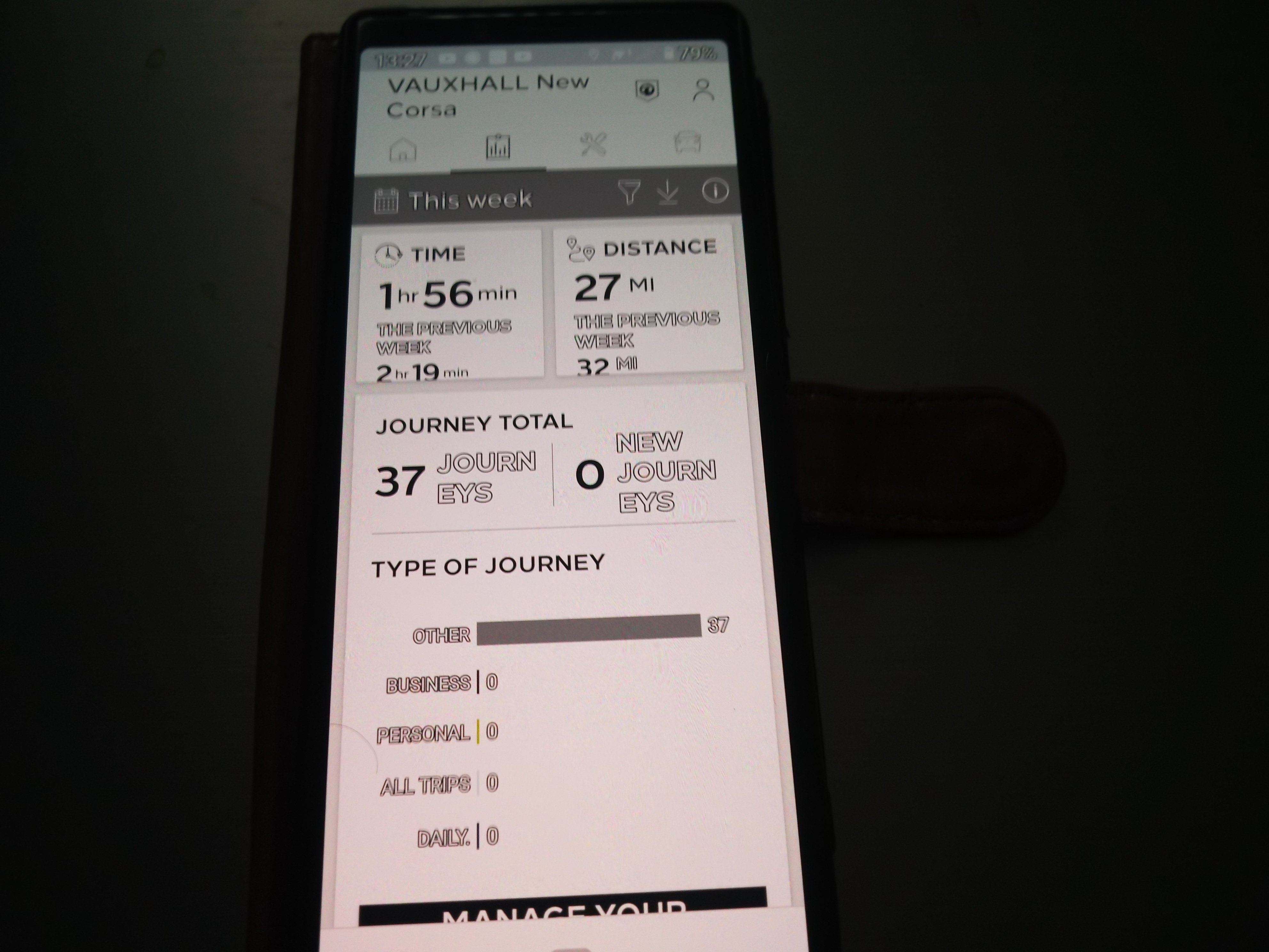

This was odd in the Corsa.
In ECO (80 ps) the Heating / AC was restricted and not worth driving in with dead feeling of the steering and acceleration.
He had ECO but could still have used the stick in B or just shifted to B for decelerating / slowing.
He would have got the same economy with the car in D (110 ps) and then at the roundabout actually getting the regen with the stick moved back to B.
In Sport (136ps) he would have got the same kWh use showing and better feeling of the steering and would have got better regen shifting to B.
That would have had it slowing the same as lifting off the accelerator with the Tesla.
If did say the percentage of charge on the Corsa while charging and when you open the drivers door as long as the car is turned off.
So as you get back in the car, or each time you open the door when in the car and charging.
