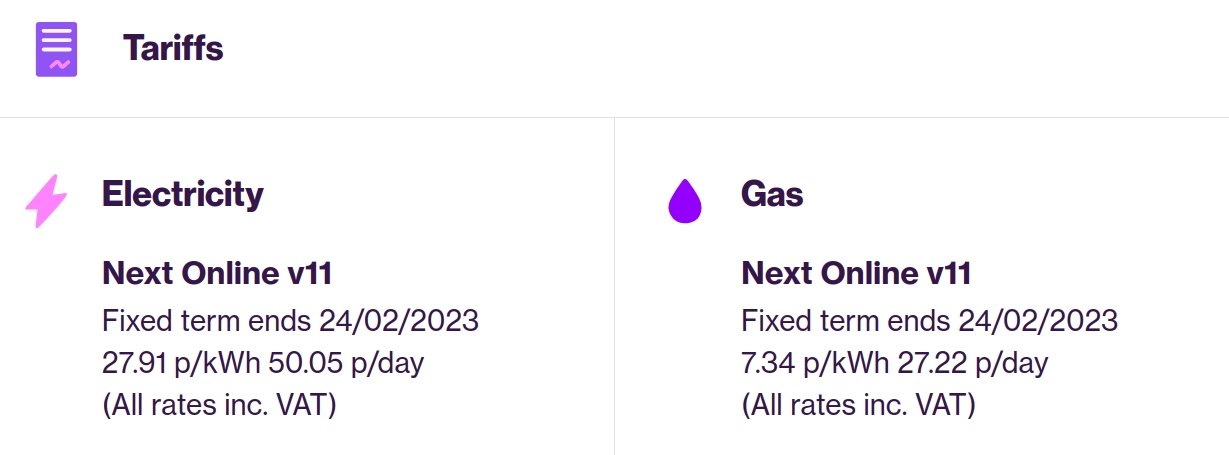

9 hours ago, cheezemonkhai said:
Home rates are high too, although cheaper and the cost of buying an EV is much higher. Have high electric and falling fuel prices created a perfect storm for EV?
Home charging is still at 7.5p/kWh for cheapest EV focused tariff. This still gives ~3p per mile cost.
Diesel at £1.80 per liter still translate to ~15p per mile for me based on my previous lifetime average of £1.23 per liter and getting 10p per mile.
As long as you can charge at home, it's still much cheaper driving EV's. Remembering there's also less service cost and tax-free emission zone benefits.
But for purchase price, it's not looking good. I think the chip shortage have worsened the price differences. The demand for EV's doesn't seem to be disappearing, it seems to be ever increasing, which is not good for prices or even just incentive to design smaller cheaper EV's.
This is true BUT the day rate or peak rate paid is very high as are the standing charges. You need to be able to move almost all your use to the low cost period for it to make sense to use one of these tariffs now. Just saying you can charge your car for 7.5p / kWh ignores the bigger picture of overall electricity cost for the household. I work from home, so use quite a lot in the day and for me the SVP would be best if I didn't have a fixed rate at the moment. I get what you say about home charging being cheaper than diesel and for me most definitely is at approx 5ppm versus 18ppm if I still had a diesel. I pasted the rates in my area below and you can see the day rate on Go is double my current (V. Good) rate. Everyone's circumstances are different.
My rate
YOUR TARIFF
Octopus 24M Fixed
Octopus 24M Fixed September 2021 v3
Fixed term ends 13/09/2023
21.99p/kWh
23.50p/day
Octopus Go rates for my area:-
Unit rate (04:30 - 00:30):
42.29p/ kWh
Unit rate (00:30 - 04:30):
7.50p/ kWh
Standing Charge:
47.31p/ day
Prices include VAT.
Octopus Go is an electricity only smart tariff. For gas, simply choose any Octopus gas tariff.

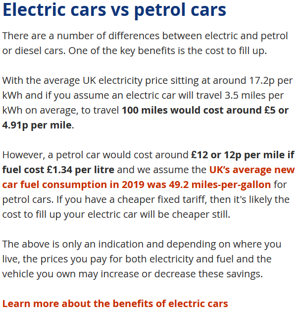

Source:  https://www.edfenergy.com/electric-cars/costs
In order to assist people who may wish to do their own maths, and input current prices, here is how you calculate.
Take your price per kWh from your tariff and divide it by 3.5 (average kW needed to drive 1 mile down the road)
Example: 17.2p kWh / 3.5 = 4.91p per mile (change 17.2p to your tariff)
Fuel cost per mile is calculated from price of fuel in pence, divided by the average of 49mpg (UK gallon) then multiply by 4.54 as there's 4.54lrs per UK gallon.
Example: 134p per litre / 49 mpg average, then multiply the answer by 4.54ltr = 12.42p per mile (change price per litre to reflect current values, and adjust mpg for your car average)
p.s. I would love to see some overall cost of running one car vs. the other, meaning what say 12,000 miles a year over 3x years, add in lease costs to get real comparison for my own curiosity.  Then compare cost of the EV vs ICE for 3x years.
So now Petrol / Diesel is still between 170-210 pence around the UK and 135 pence a litre is a wish and a dream.
There are calculators to give the comparison of an ICE vs EV and maybe someone can link one.
Business / Commercial users / drivers and EV / ICE comparisons will be a totally different kettle of fish.
PS
That average new Petrol car 49.2 mpg in 2019 looks like rubbish to me.
Edited by roottoot
PS
Yeah those figures were from 2019 (page linked) so 100% different now.
I used the image and then used those values so people could test their calculator skills, people then need to input their own figures for local fuel / electric tariff's and of course own mpg figures.
Agreed 100% not sure where the hell they got an average 49mpg, seems like pie in the sky figures!
Would love to see if someone has a good site for EV/ICE running cost comparisons, I recon EV wins by a long mile, but that's only my own guess.

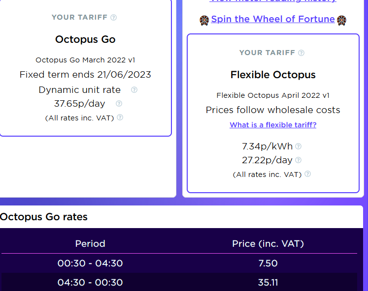

I'm on Octopus Go with 35.11p per kWh daytime, signed up just over a month ago. It's not much increase from current unit cap. Because it's fixed for 12 months, I've even considered getting my parents to use this despite not having EV. Unfortunately the price have risen recently to 40+p, making it pointless for non-EV users.
I too work from home a lot of days (eg. now), pretty much all of WFH computer stuff are powered from my 7 years old roof-top solar PV. Unfortunately it is too small and cannot satisfy Zappi EV charger's 1.6 kW minimum rate to charge the car solely from solar.

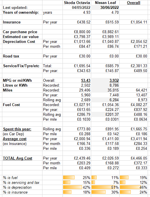

This is my costs, compared 2 second hand car of similar value purchased in 2017: Skoda Octavia mk3 2013 and Nissan Leaf 24kWh 2014.
It gets updated everytime I refuel the diesel or every few month for the EV.
Total average fuel cost over my dataset is £1.20 per liter. EV used a constant cost of 12p/kWh, very pessimistic considering I was paying 8p initially, then 10p and 12p on Economy 7 as price rises. But soon after hitting 12p, I've switched to EV tariff charging 8p (Bulb) and now 7.5p (Octopus).
I have full breakdown of servicing costs. Both had new tyres and new front brake disk/pad. Skoda had dealer timing belt and DSG oil, otherwise indie servicing done on schedule. Whereas Leaf didn't get any servicing beyond me checking battery with Leafspy and DIY the cabin filter.
The depreciation cost will be off the charts when I replace the diesel Skoda with Tesla Model Y...... luckily it's paid in cash. Same as all my previous cars, I always pay cash or pay off PCP ASAP, if the PCP deal have other benefits. Thus the above depreciation cost are purely speculative estimates based on car value probably drop 40% every 3 years.
If you can charge at home, I think EV ownership just need to get used to much lower fuel cost but higher depreciation cost. This calculation made sense in 2017 when I bought my EV. It will continue to make sense for as long as EV tariff are available.
Edited by wyx087
