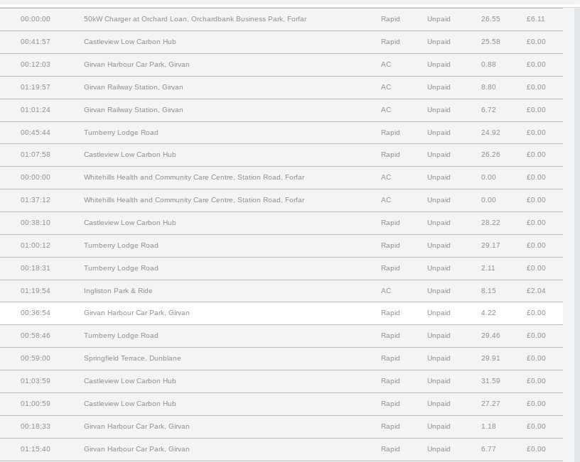

Small battery using 50kW free or low tariff CPS / Evolt chargers and i never get more than 33 kW in an hour.
Same on a PodPoint or InstaVolt 50 kW charger and i have never managed to get a 125 kW BP charger to charge ant faster if even to start.
That £6.11 this week was a MINI electric that did charge to full but lost track of how long, but it was quick.

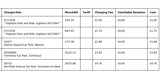

See the charging time and kW hours from my account.
**2nd from top, good charge, low battery, hot, weather not too cold and charging just to 85%.**
41 mins 54 seconds. 25.58 kW.
Or Turnberry Lodge Road charger. Usually a low battery when i start charging and a good charge speed.
You get up to 50 kW (maybe just 45kw) starting with a low battery and until the charger slows. That will for longer with a bigger battery.
As you will see i seldom get 30 kW in 60 minutes on 50kW (Rapid Chargers).   This is about as poor as EV's get though.
I get 6.6 kW in an hour on a 7kW AC charger, the same on a 11 / 22 or 45 kW AC as i only have a 7kW onboard charger, not a 11, 22 or 45 kW which some cars / vans have.

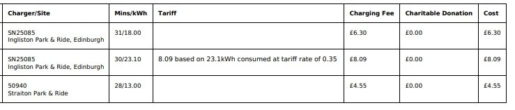

This is 30 min charging sessions Edinburgh @ 35 pence on 50 kW chargers.  A few are on 7kW when charging up to 100% on the cheaper chargers.
Then Aberdeenshire charging is at 21 or 28 pence and highland at 30 pence.

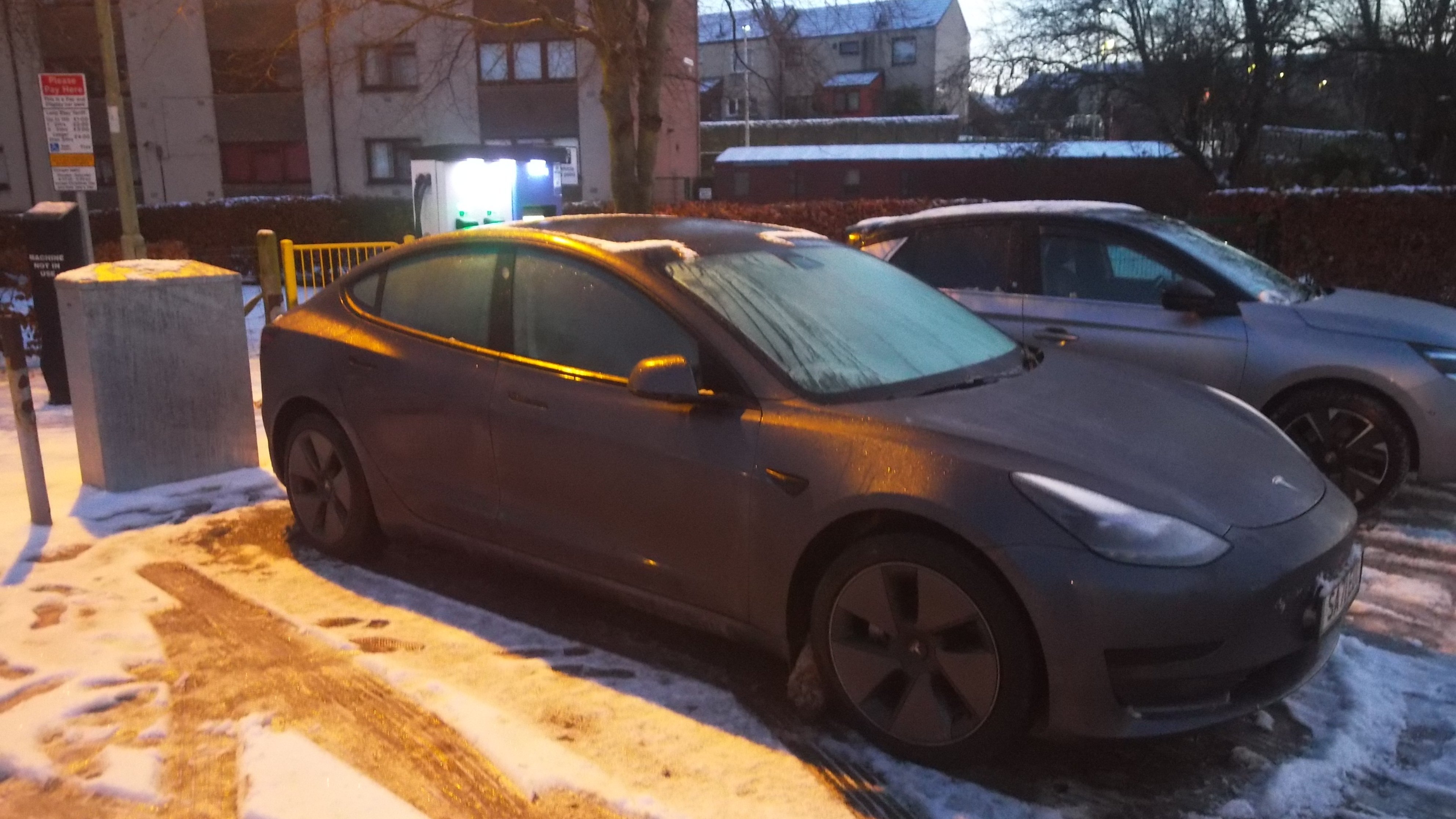

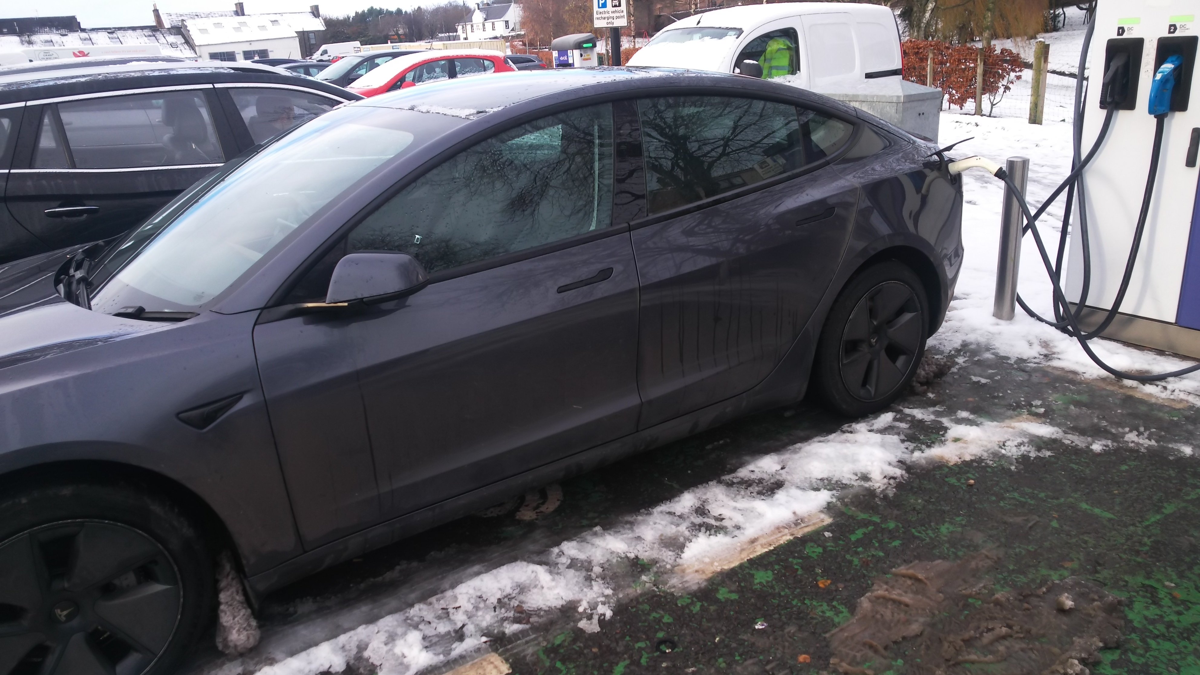

(Adverse weather situations which EV drivers might be seeing this today.)
I could maybe live with this.  But i could see this one might just pee me off , the cold range will be crap.
I would want to try in days like just now.
-3*oC or so driving and charging and on factory tyres on ice and snow and chargers with no ploughing or gritting at them.
I need quick de-icing / heating, easily cleared of snow without the air intake blocking, ,wipers that do not freeze in place.
Burttons and nobs and doors /handles / charger port that does not freeze closed if not pre-prepped.
Heat to the feet would be nice will still windows do not mist up.

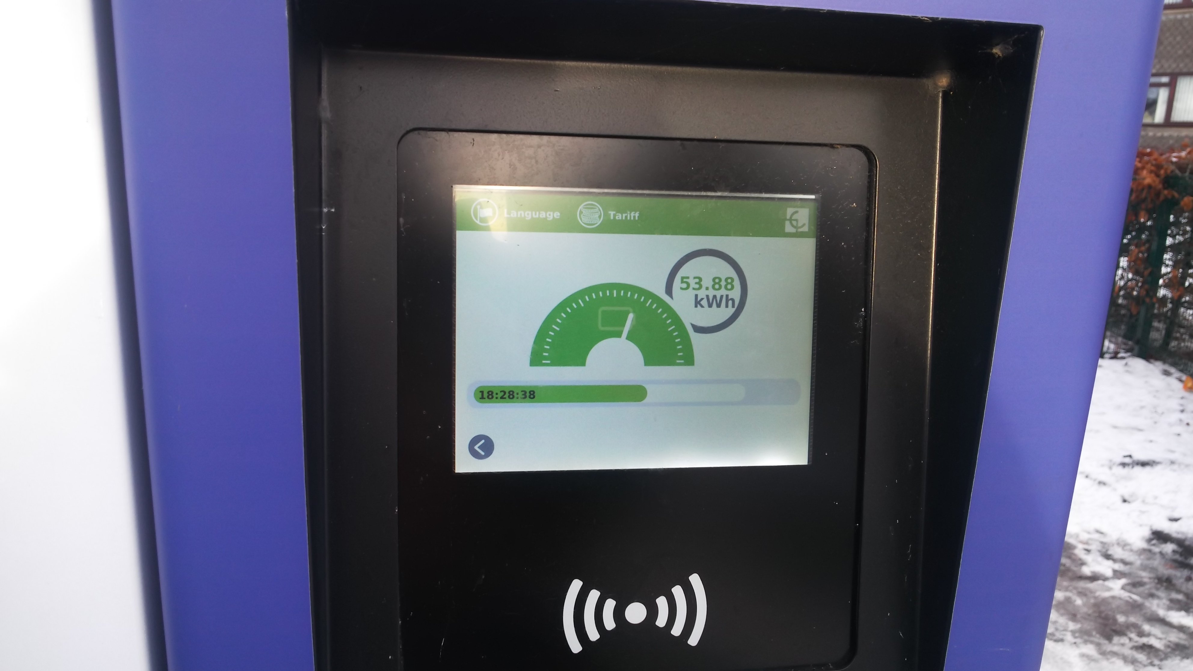

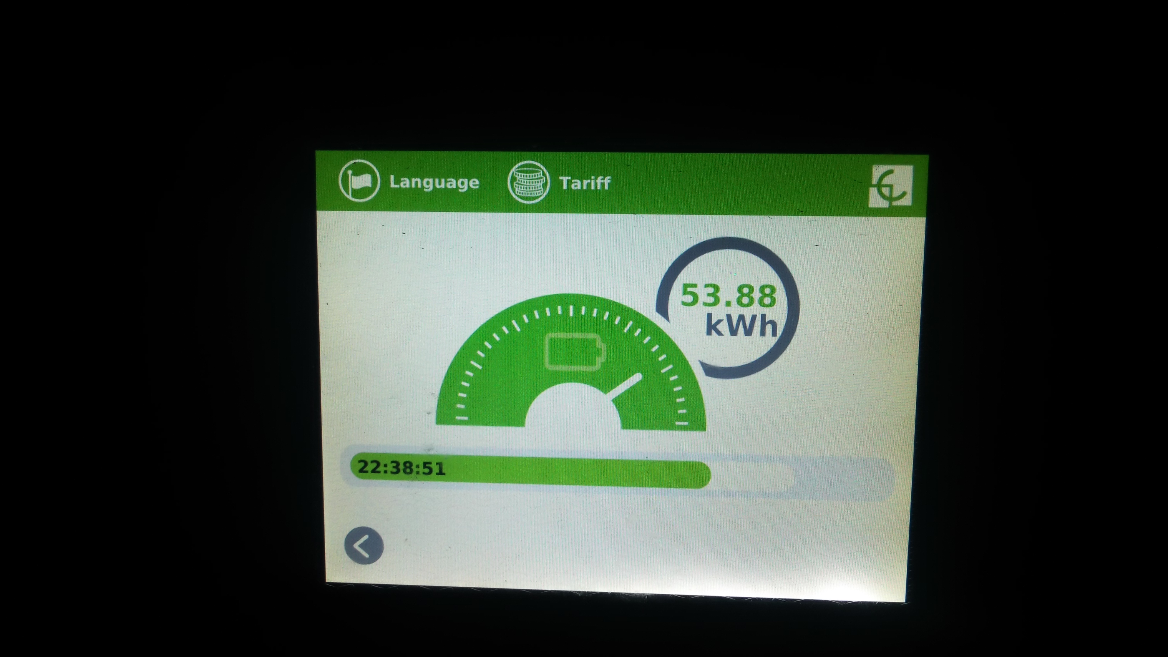

18 & 1/2 hours plugged into the 43 kW AC chsrger, which there are actually users of quite often for Rapid AC charging.
No time limit @ 23 pence per kWh.        EDIT,. 22 hours 38 minutes and still sitting locked 🔐 in.

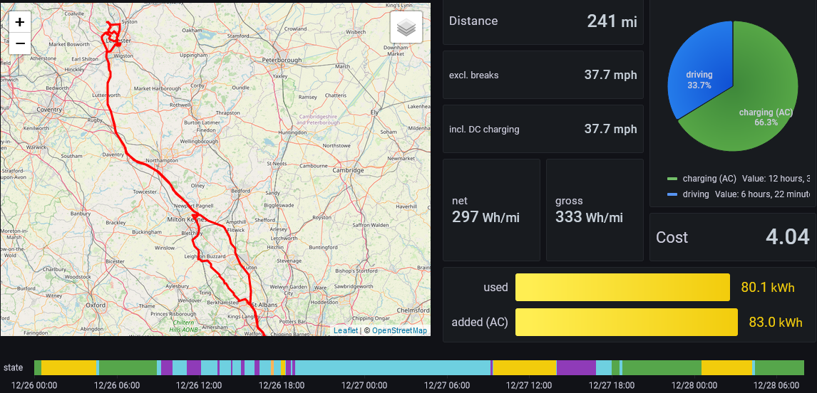

Real world range and costs:
I did a return trip 26th and 27th to Leicester. 241 miles. It may be possible to make it back in one charge if I hadn't used sentry mode overnight. But I found a free AC charging spot near the museum we were visiting, so charged there for 4.5 hours.
Total cost: £4
Cost per mile: 1.66p/mile
Here is my data tracker page for this trip. Record started at 66% and ended at 70%, hence higher "added" compared to "used". Cost of £4.04 is based on amount charged, not amount used. Net consumption is driving, gross consumption includes sentry and running the heating but not driving.
Temperature 3-8c throughout the 2 days.
Let's say I had to use expensive rapid chargers. Total 80.1 kWh used, let's say 70 kWh from the home charging (7.5p/kWh), 20 kWh at en-route rapid chargers (let's say 60p/kWh), that's going to total £17.25 for this trip. or 6.9p/mile. Still waaaaaay cheaper than any liquid fuel.
Edited by wyx087
